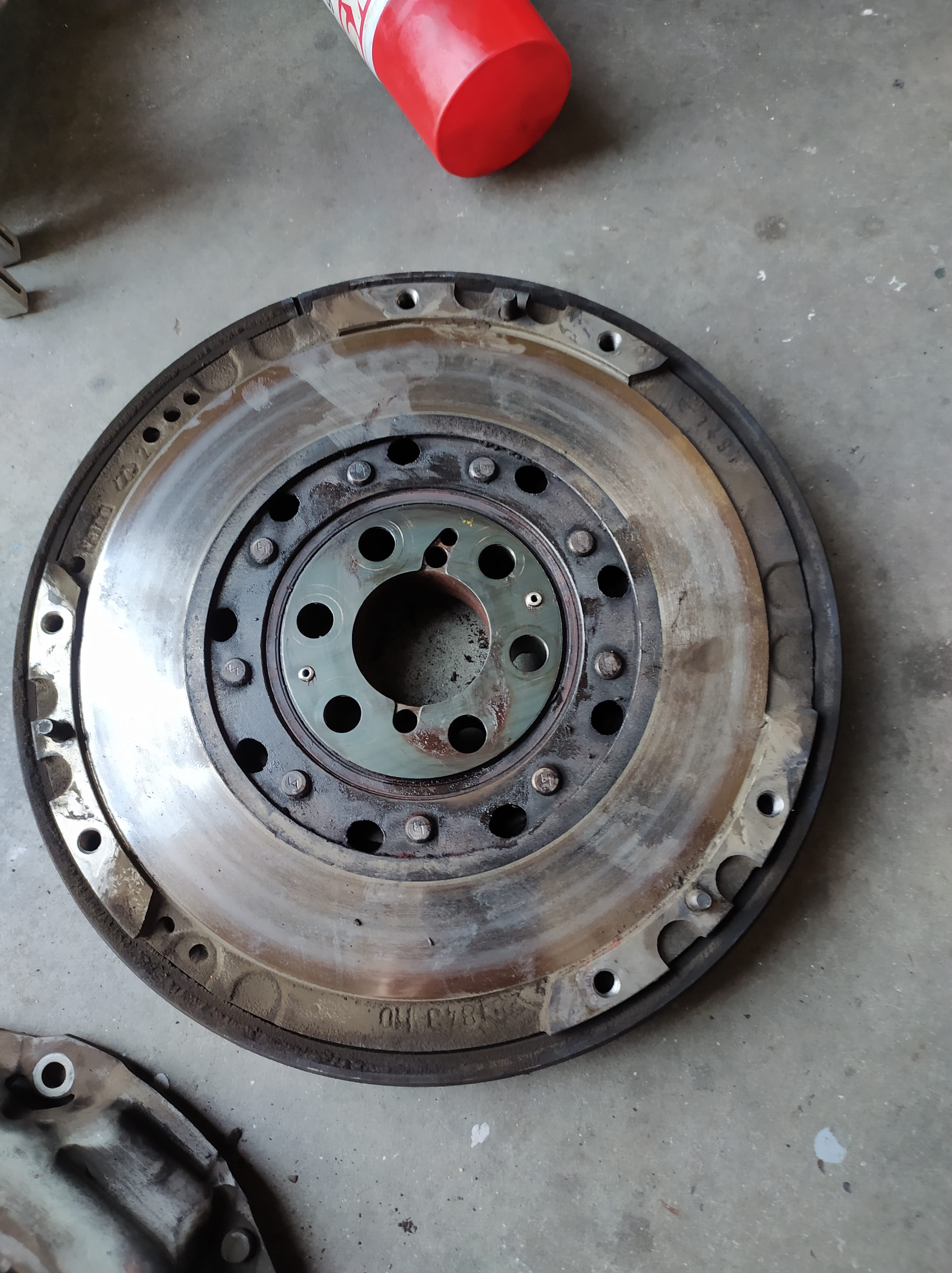

Technical At least I worked out why my flywheel was juddering...

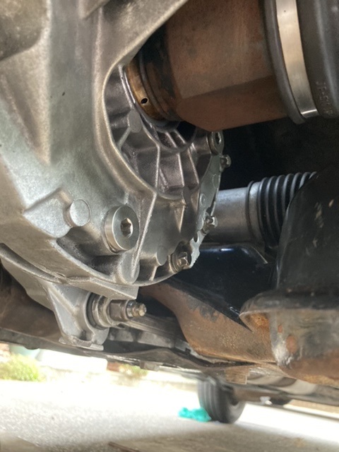

The gearbox is being moody.
I managed to get it onto a jack and wheeled it under the car... then hoisted it into position so that the two studs on the bell-housing, the gearbox input shaft and the o/s driveshaft all lined up... and then push it into position.
But despite being in the correct position.. it won't go fully "home".
I tried jiggling it (bearing it mind it's 40kg) and rattling it, and doing the hokey-cokey.. and even a sun dance (since it started raining, just to increase my joy)... and it's crept up to the last 1cm... but I can't get it home into position.
Last time (in fact every time) I fitted a gearbox, there is a bit of rocking and rolling until the box just snaps (clunks) into position.. but I can't get there with this one.
Am I just turning a bit puny with old age, or have I missed something stoopid? It seems to me, the gearbox shaft/clutch plate are probably not precisely enough aligned.. but I didn't do anything different to what I've ever done before.
Any tips/hints/suggestions? I'm reluctant to take the gearbox off again, since getting it on there was a bit more physical than it sounds up there.. ^ and it's just 1cm away from getting there.
Any way to rotate the clutch/flywheel, in case it's sitting half a spline out of alignment with the shaft etc?
Ralf S.
Only thing I can think of that that would stop it going in 1cm are the centring dowels (tubes). They protrude about 1cm. Everything else should be partially engaged if the gap is only 1cm.
The splined gearbox shaft goes in more that 1cm, so if the gap is only 1cm, the gearbox shaft must be aligned and almost fully in.
I'll have a look... it has to be something simple like that.
I was wondering whether I took the clean rag out of the driveshaft oil seal etc... :D although that obviously can't be it, it feels like it's got an actual (hard) resistance that's stopping it going on.

The older clutch disk was seriously worn and it was the cause of my slipping. The flywheel surprisingly had very little play but since i had a complete valeo set, i changed everything, even the crankshaft seal didn't escape my torture :D

I managed to do mine in the end.. :D
The problem was the locating dowel. If you look at the picture at the top of the page, the dowel on the right has fallen out. It fell out when I removed the gearbox.. but while I was wrestling with the gearbox and concentrated on getting it out, I didn't have a proper look to see where it came from. I put the dowel onto the left hand stud, just so I wouldn't lose it.
Then I forgot about it (my gearbox was off in June, and I tried to refit it in August) so it was on the stud where there was already a dowel.
Luckily I could pull the gearbox away from the engine enough for the stud to come out (so I could remove the dowel) while the engine was still supported by the driveshaft and input shafts.. so I didn't have to drop the gearbox out and re-fit it on my own. It's just too heavy for me.
Anyhow, it all went very smoothly after that. Even the engine mount lined up with the bracket, which it never usually does.

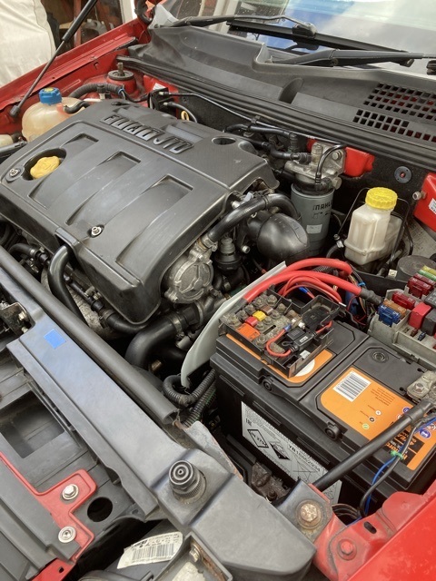

The battery wiring went in like Fiat intended. I've had it apart 2 or 3 times and it's always been different but I noticed the connector blocks have notches, like Lego, in the bottom to line them up in the right place in the battery box. Once I'd clicked the blocks into the right location, the rest of the wiring just fit without the usual "wrestling an octopus".. :D I'm pleased how that came out.
So far.. very light clutch (lighter than the Younger Mrs S'. Fiat 500 clutch).. and no judders, vibrations, clonks or bangs. Worth it in the end.. :D
