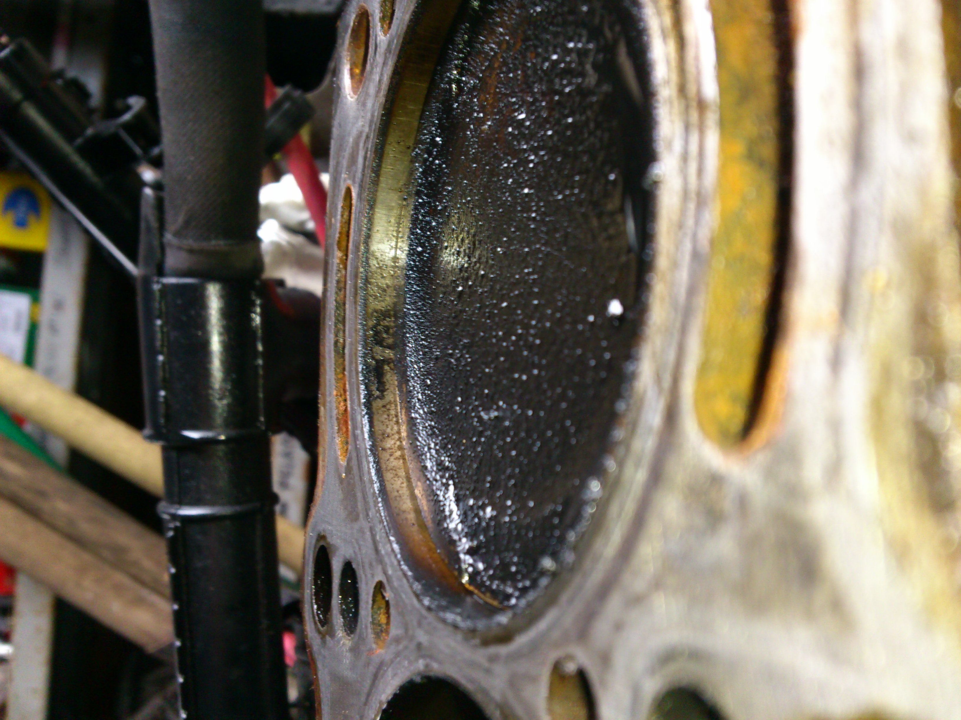

Ok, so I have the engine out now. Manifolds are off so I can at least see the sides of the valves however I have never inspected valves for failure, can anyone give any advice or will I have to pull off the head and inspect further?
I plan on working down through the engine to find anything salvagable and maybe get away with a short block repplacement depending on the head!
I have put the word out for a new engine so I should have one by next week.
I now have the head off, from a visual inspection all valves look fine although two off the inlet valves are white. I cant't remember if this means lean or rich? But this is likely due to the p75 cam not being reshimmed yet.
all valves seen straight and have no play when on and off cam.
Now the pistons:
the two outer pistons at the belt side and gearbox side are both very wet and grimy. Their TDC position is also about 3mm short of the TDC of the two inner pistons. I also found a metal head gasket in their rather than the composite verson which surprised me.
Any ideas if the two outer pistons are supposed to have less travel than the inner two?

your engine is scrap since it ingested water
only thing worth saving is the head if valves not bent as you say and ancilleries including manifolds
the thermal shock will have done unknown problems and the conrods are likely bent in the block
crankshaft] i wouldnt use due to stoppage stress either
keep to plan 'a' find another lump or bottom end at least

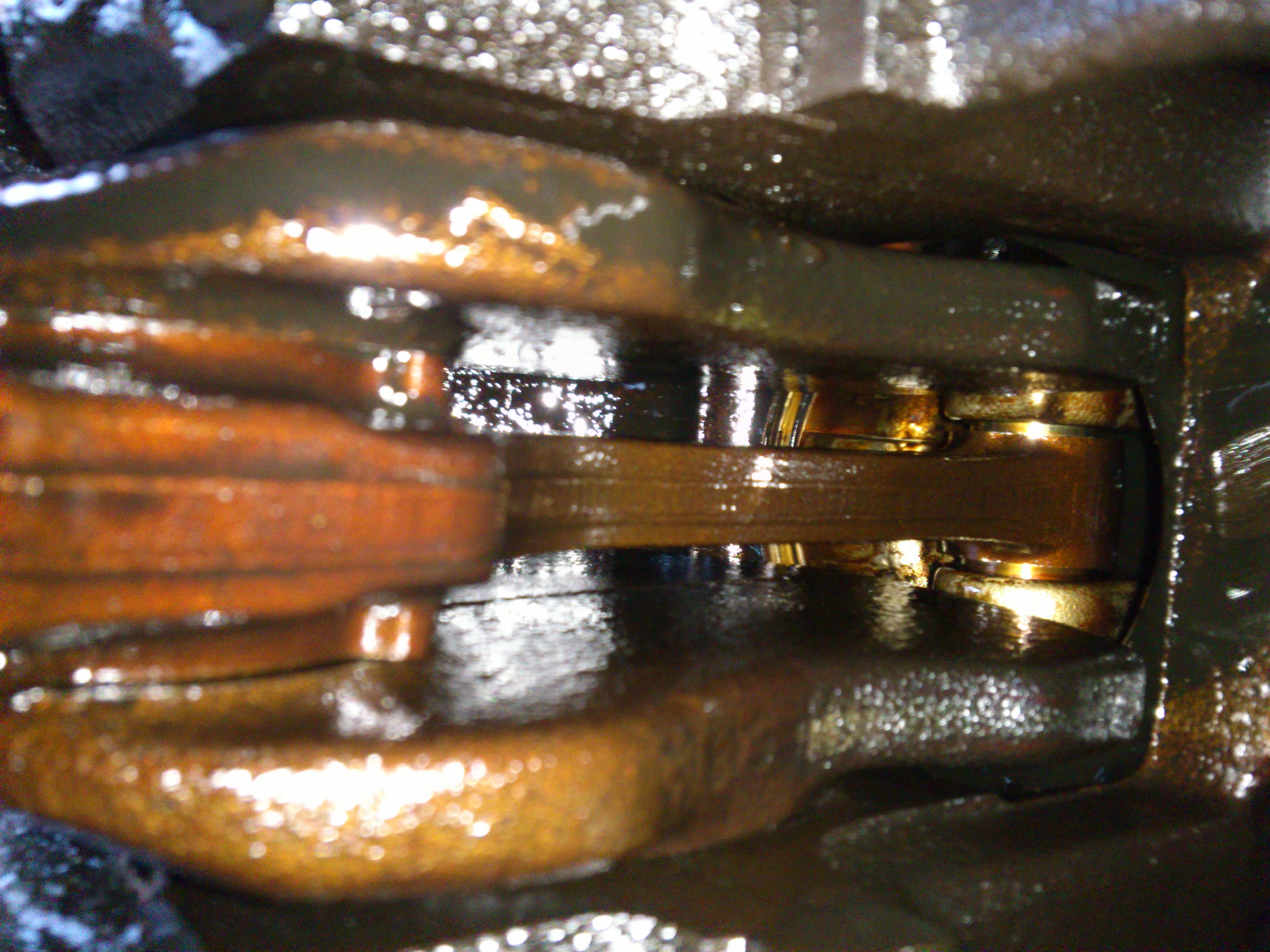

I finally got to the bottom of it and it is as expected, knackered!
Connecting rods on both Pistons 1 and 4 are bent quite badly! The complete head seems in good order at least.
I'm going to just buy a cheap second hand motor though to save time and money going and doing the head gasket with a short block.
Here's a few photos of the rods and the pistons:
