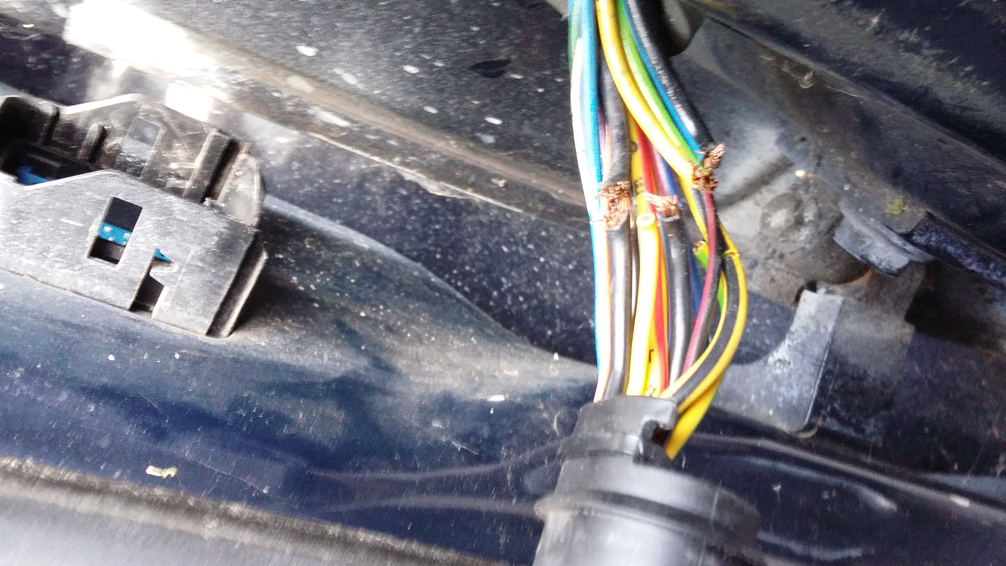

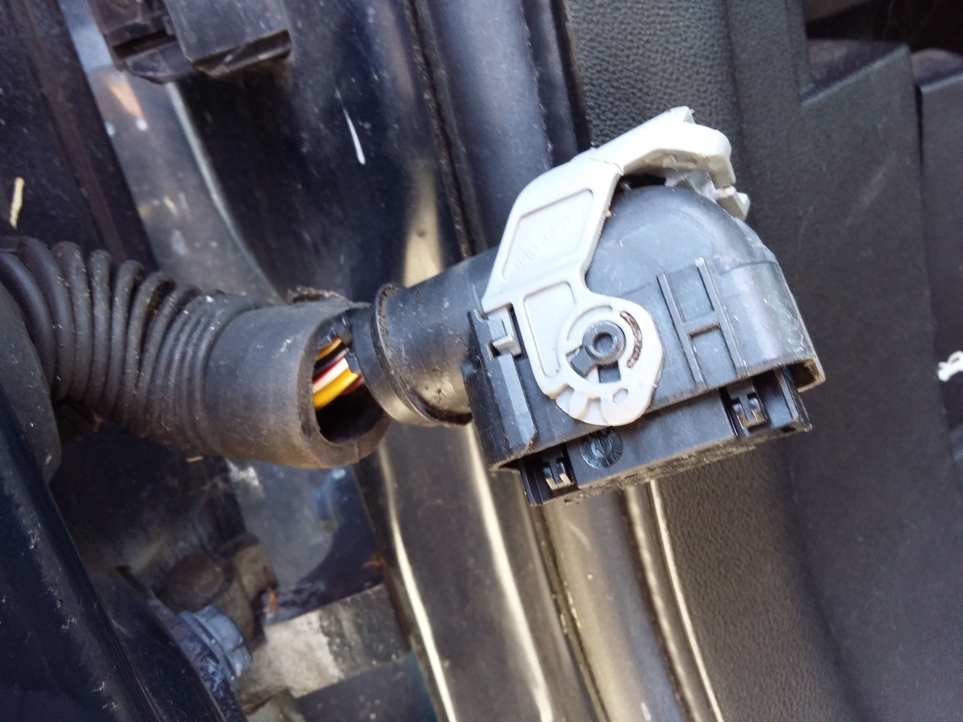

I found my issue.. broken wires :eek:
Solder repairs to drivers door wiring loom
All working great now :)
