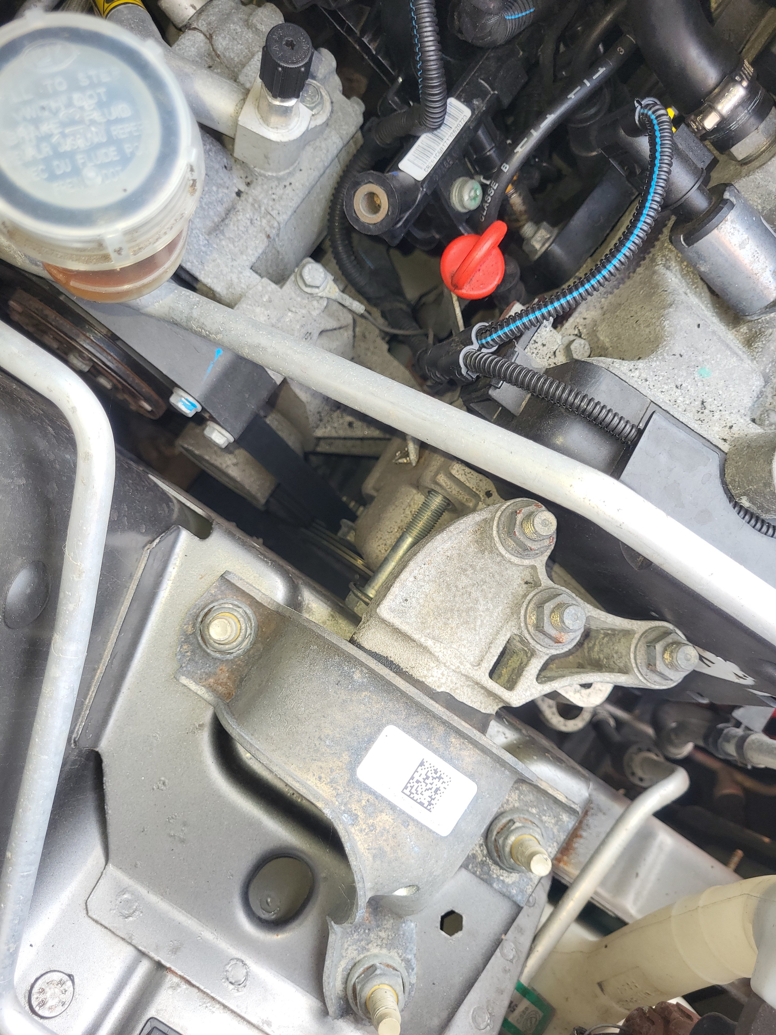

Got an issue with my wife's 1.2 500. She and our daughter remarked at a new noise when being driven. Always concerning . . .
It sounds like a rotating noise, bearing of some sort maybe.
It appears to be coming from aux drivebelt side and upon looking, the lower rear (nearest the windscreen) pulley is not rotating. It is metallic and grooved in design.
The belt is moving and the other pulleys are moving fine.
I assume this shall be the source of the noise. I have checked a Haynes manual and online and can't find a decent diagram of the engine side on to show what the pulley is.
Any knowledge of what this pulley wheel is called/for and how easy, or otherwise, it shall be to replace.
Many thanks

Is it the pulley in this 1st pic?
Does the car have AC ? It's not the ac pulley that's stationary?-normal, maybe take the aux belt off, start up and see if the noise is still there?
It does have AC. I'm not sure which pulley is which, main problem ( other than lack of knowledge ) was not being able to locate a suitable diagram.
The large one to the left of the pic ( top of engine ) ? if so, then no, it's the lowest one, smaller and lighter in colour than the one at the top.

Take the car to a trusted garage, they will quickly work out what it is I'd suggest, as the timing belt is also there don't leave the issue could be the alternator bearing, that's the smaller one at the
Could kick myself, back out there with a better light and it's on the side the alternator. Here is a video just shot of it. I have replaced a clutch pulley on a polo a few years back, so hopefully this won't be too hard . . .

Update. Of sorts . . . .
After a lot of WD40 the pulley is moving, though looks to be slower than the other pulleys. The engine sound is still there.
However the sound goes when the clutch pedal is pressed down. Which leads me to decide that I have run out of talent and it's time to take it to the garage. I assume its a flywheel issue.
Release bearing clutch, unless it really bad probably ok.
My usual garage is full for work like this till the new year . . Another one locally can do it in 3 weeks, when described what was going on he said the same thing.
