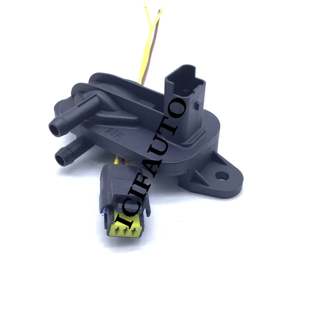

Above AliExpress part I used to replace original Kavlico. I must say in every way the part looks identical. Right down to the molding and 'Patended' imprints, without the Kavlico sticker label. The seller supplied the wire connector as a precaution as some have mentioned a different cable fitting. In my case it was a direct fit.
