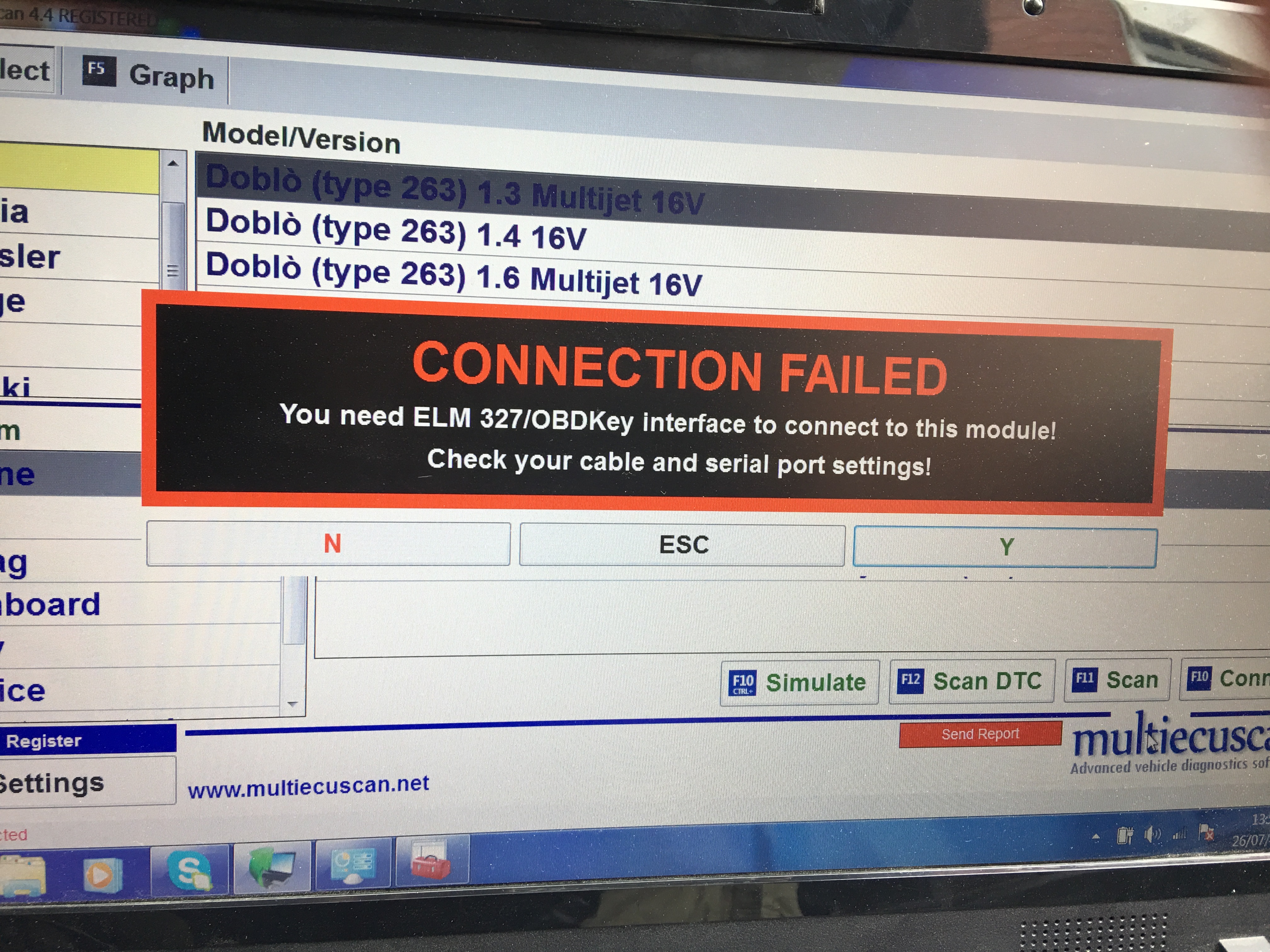

Trying to get it to work.... I can't even get the leads to work. I have downloaded the drivers, everything looks right in the control panel saying that drivers on everything ok. When I try to connect the software I just get this: AAAAARGH how do I add an image!!!
/var/folders/d0/dc75zj0x2rj602bjt7wm10380000gp/T/com.apple.iChat/Messages/Transfers/IMG_1221.JPG
OK, it says
CONNECTION FAILED
You need ELM 327/OBDKey interface to connect this module!
Check your cable and serial port settings!!
Can someone please tell me what I am doing wrong... Im really pulling my hair out with this now as.

I didn't realise there was settings in the software and had to select the type of cable... Anyway.... hooooraaaaayyyy.

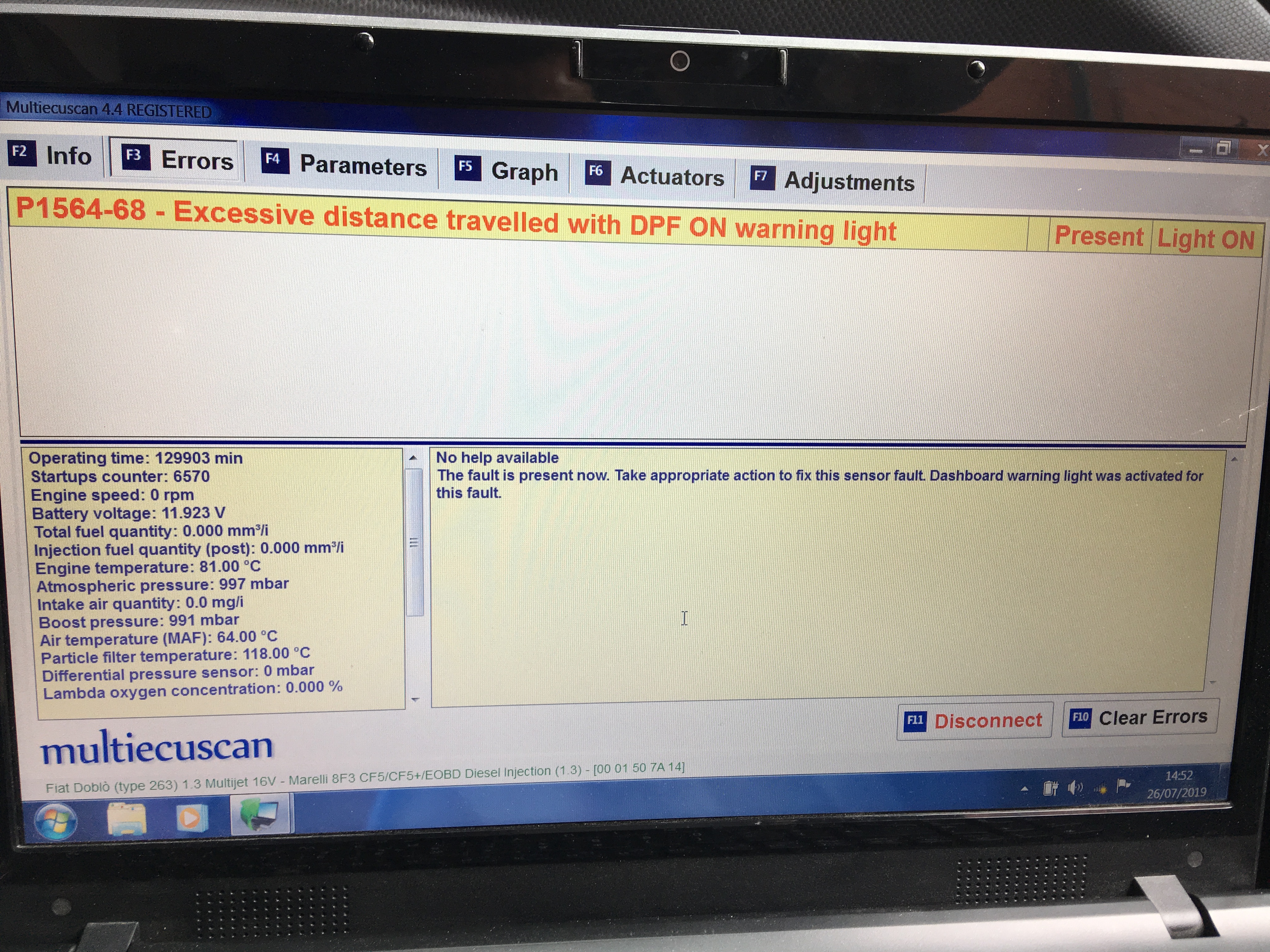

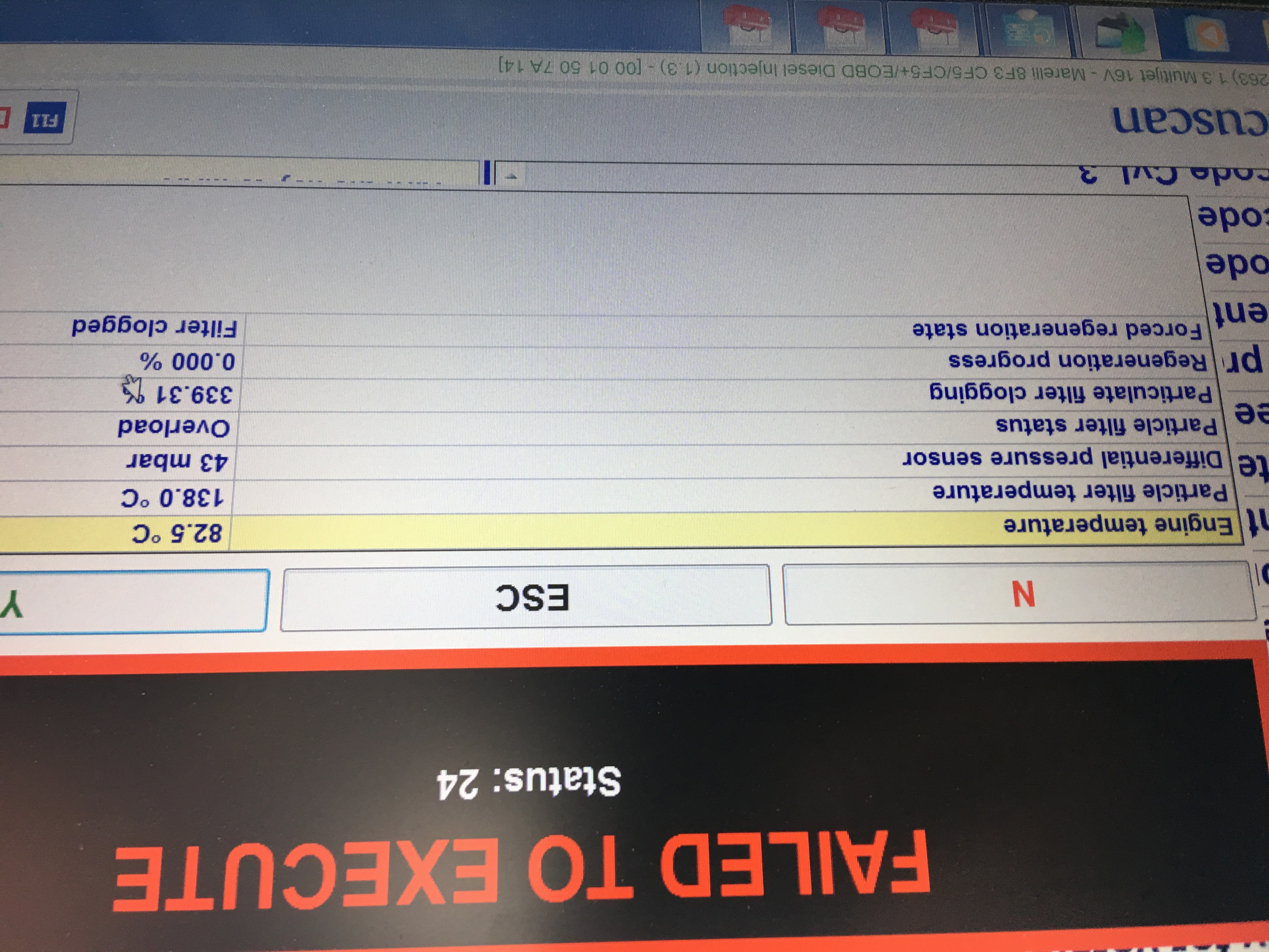

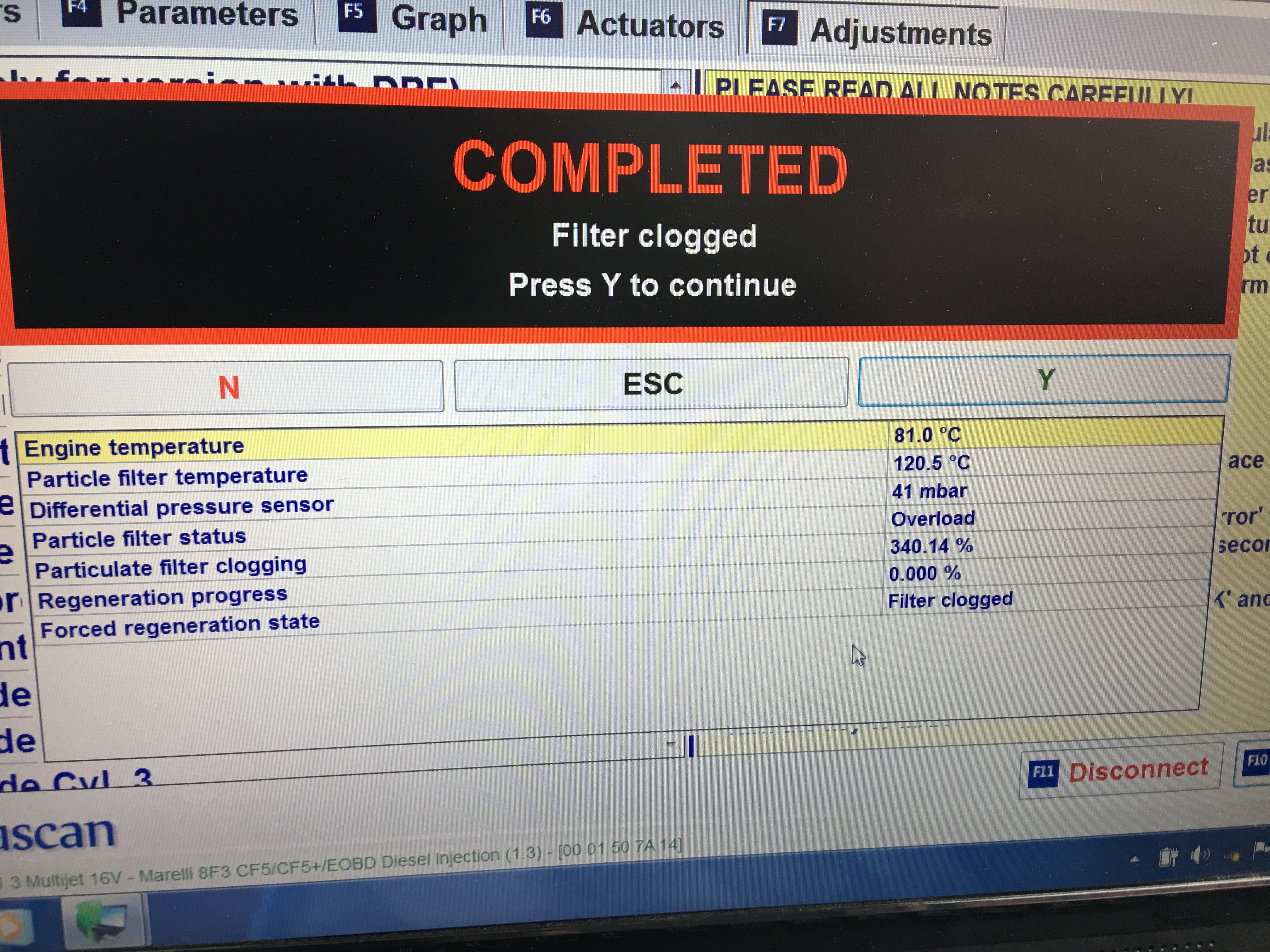

However, I found the faults etc and couldn't perform a forced regeneration. Can anyone help me with this and tell me what I need to do??
How do I do a forced regeneration if it won't allow it?

Hi,
Did you reset the faults before trying the regeneration? If not do this first.
If it will still not regenerate then reset the service indicator AND the oil change. The oil change is on the ENGINE ECU under the adjustments tab.
If it still won't regenerate you could possibly try the "DPF replacement " adjustment and force a regeneration.
Don't forget to reset faults before you try regeneration each time.
I guess you read this, but the engine has to be fully wamed up befor you can force a regenereration.
If all this fails then you will have to get the DPF cleaned or replaced.
