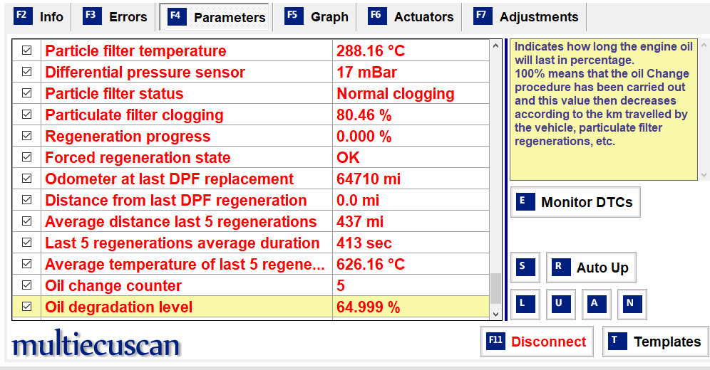

The oil is due for a change in October, the counter reads 5, the degradation level is 65%, there's no smell of diesel in the oil.
I took an MES screen grab after I did a forced regen. It shows the differential pressure sensor at 17mBar. Clogging at 81%. Fuel consumption is normal.
Would you think that it could be down to an intermittent pressure sensor, which works most of the time and occasionally gives a spurious reading creating the P1206 error?
Many thanks
Ron

Hi,
It may be a faulty sensor or blocked or leaking pipe between DPF and sensor.
You cn use the recording / graphing function of MES to monitor the pressure and rpm while driving (don't watch the screen while driving). You can review the graphs later to see if there are any odd readings.
Robert G8RPI.
