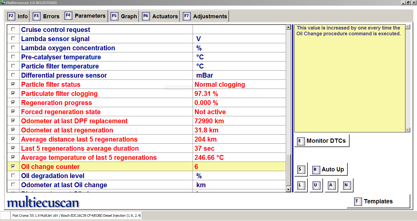

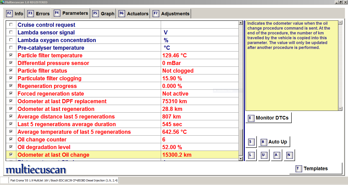

Hi there,
I sold my Croma nearly a year ago but I still look in on this forum occasionally to see how everyone's getting on. I thought my experience could help with your particular problem as I too experienced many DPF problems until I became enlightened reading this forum and using MES. Its was a subject I paid very close attention to as I do a lot of short journeys.
The first thing to say is that in my experience anything up to 100% clogging is classified as normal clogging (higher % = more clogged) and I took numerous readings. The second point is that, again in my experience, a forced regen using the software achieves very little. I found that taking the car out for a really good hard drive was by far the best solution. I have posted on here before about how I did this (see link below). Make sure you have plenty of fuel in the tank as it won't work if the tank is nearly empty (not sure what the cutoff is). Also, I was never able to induce a regen through driving below around 80% clogged no matter how hard I drove. I have also attached a couple of MES readouts (before and after the procedure in my earlier post) taken on the same day which show the level of clogging 97% before and 24% (also classified as normal clogging) after. I've also attached a 3rd reading taken at a later date after another clearout that shows 15% classified as not clogged.
With regards to oil deg my 2nd reading shows 72% and my 3rd taken 3months later with no intervening service/reset shows 52% so a higher % means newer oil.

Thank you Stuart that's very helpful before I regenerated the em light was on and it was in limp home mode when connected to ecu scan it said it was 106% blocked after regen it said 80% emlight off and said blocking normal. We are off to Cornwall soon so It should be able to sort itself out.we don't use the Croma for short runs usually but we have been doing a lot of the off the drive on to the road and back to get my sons punto out which may have upset it!
