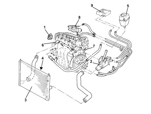

Hi Brian,
Sorry for the slow reply.
According to ePer
Operating strategy
The additional engine heater is fitted in the coolant circuit between the engine and the heat exchanger.
The heated coolant is supplied first to the engine. Once the coolant is heated up, the heat, depending on the heating level selected, is directed into the passenger compartment.
and
interface with the engine cooling system: the coolant leaving the power unit is directed to the heater and is returned to the circuit by a dedicated electric pump.
The cooling system is
But does not show the heater hose. The Remove Replace gives the answer, The inlet to the heater is from the cabin heat exchanger.
The outlet from the heter goes to the thermostat housing
So it's in the hose between cabin heater outlet and thermostat housing. It needs a pump to circulate
