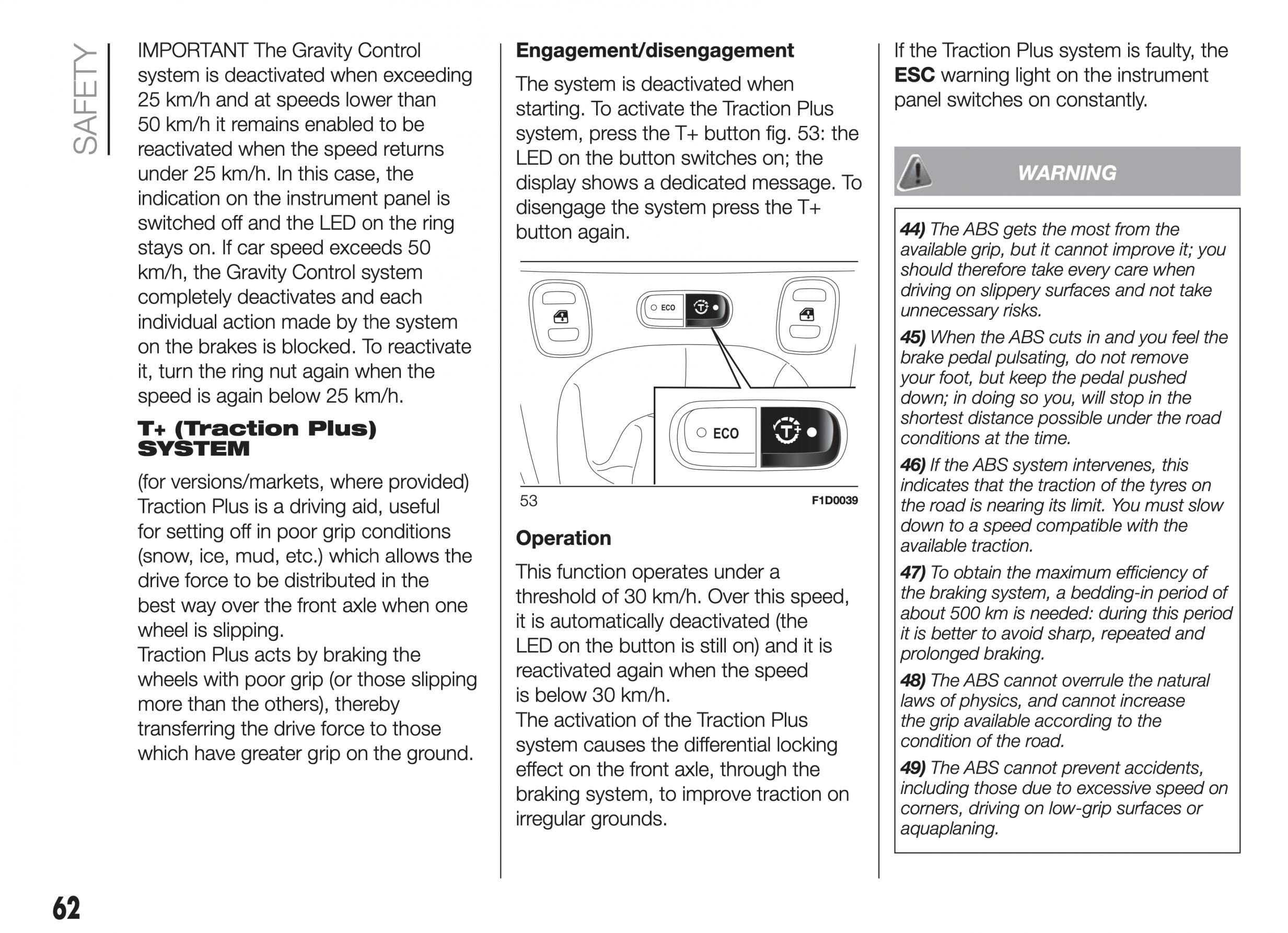

Snowy up here in Northumberland and travelling up our snowy road I could feel the Traction+ working and reducing throttle. All going well. At the drive I decided to back in “up” the drive and in reverse we got nowhere and did not feel the Traction+ or see lights flashing. Just made it off road and safe. Good.
I I had driven forwards up the drive I guess Traction+ would have worked and got us further up the drive? Does Traction+ work when reversing?
I asked a Fiat dealer and they were very helpful and went away to check but couldn’t confirm if it did work when reversing. Anyone know?
