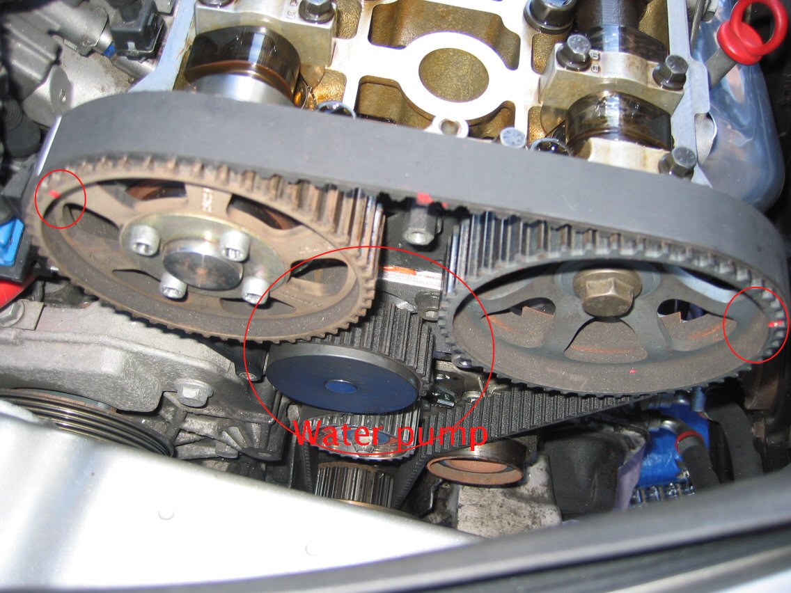

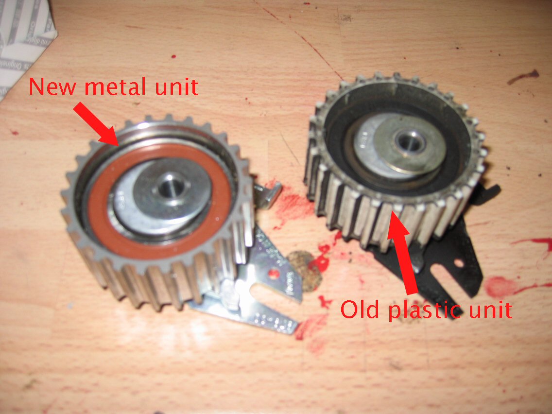

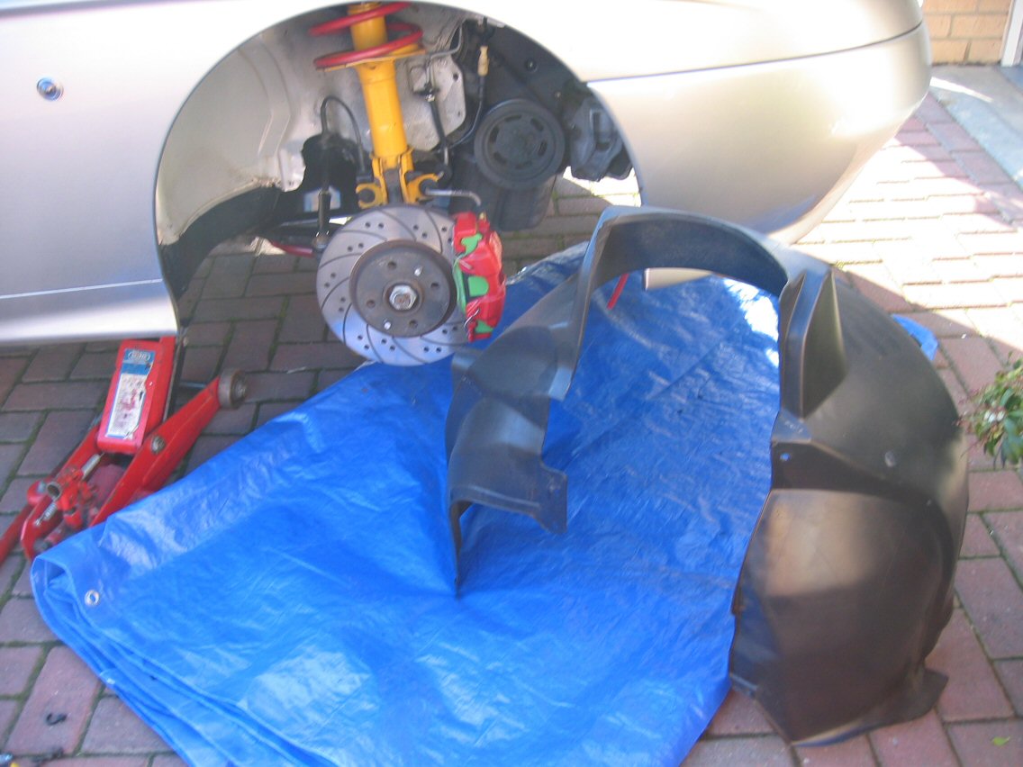

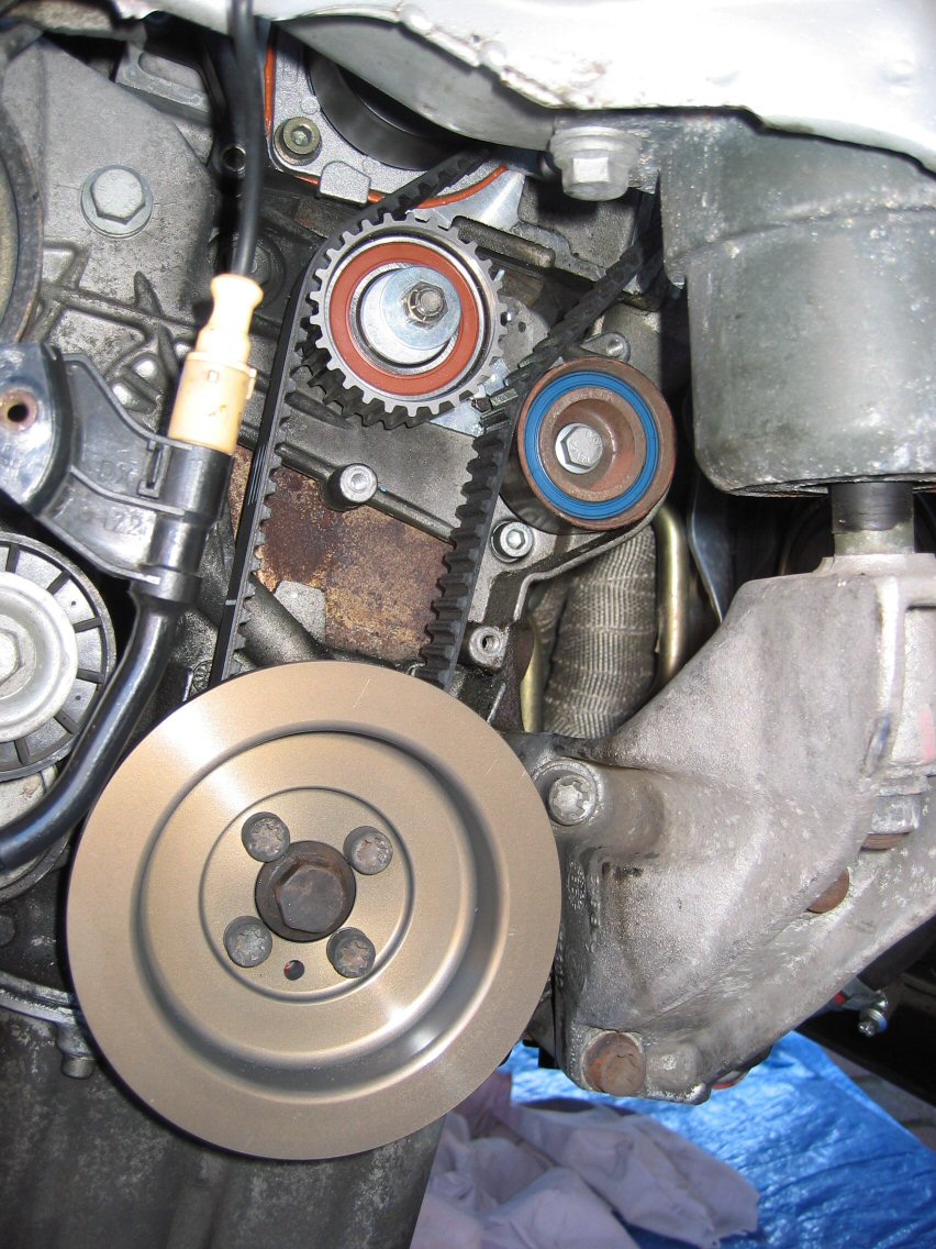

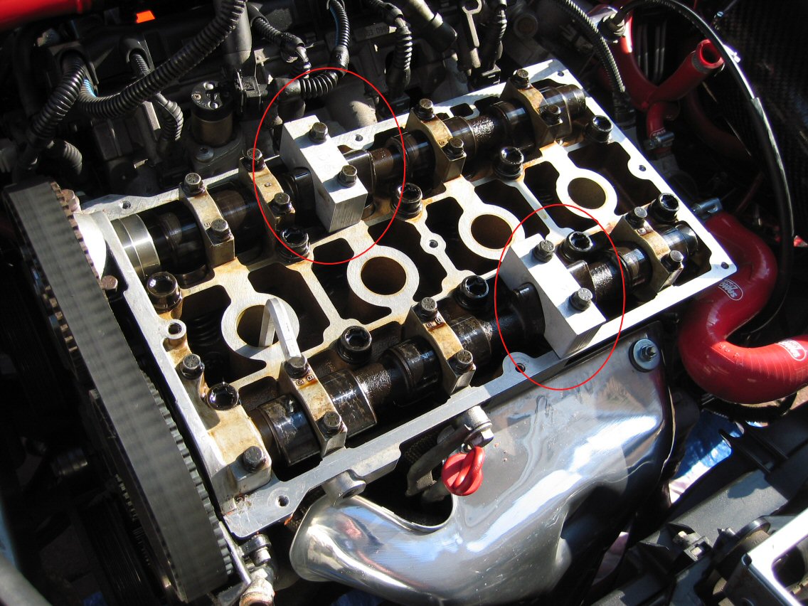

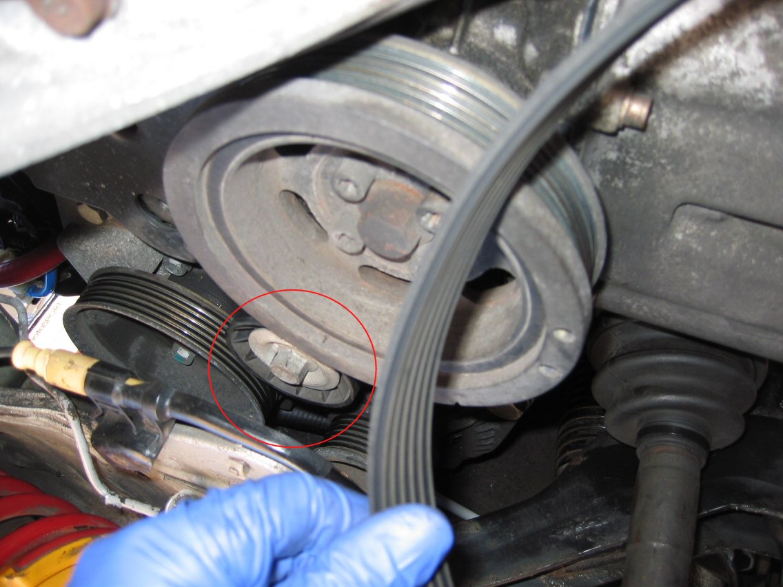

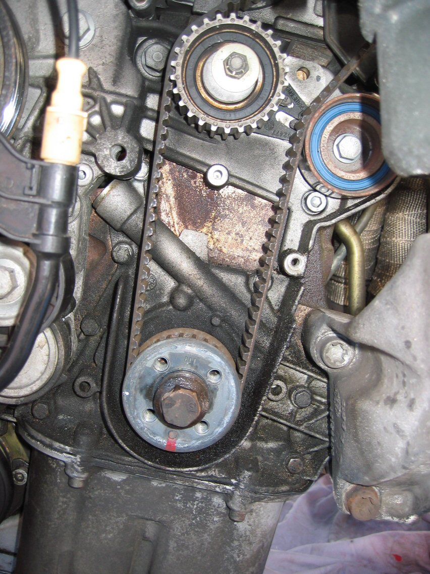

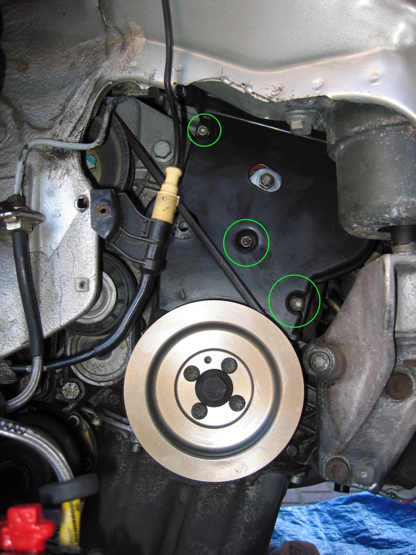

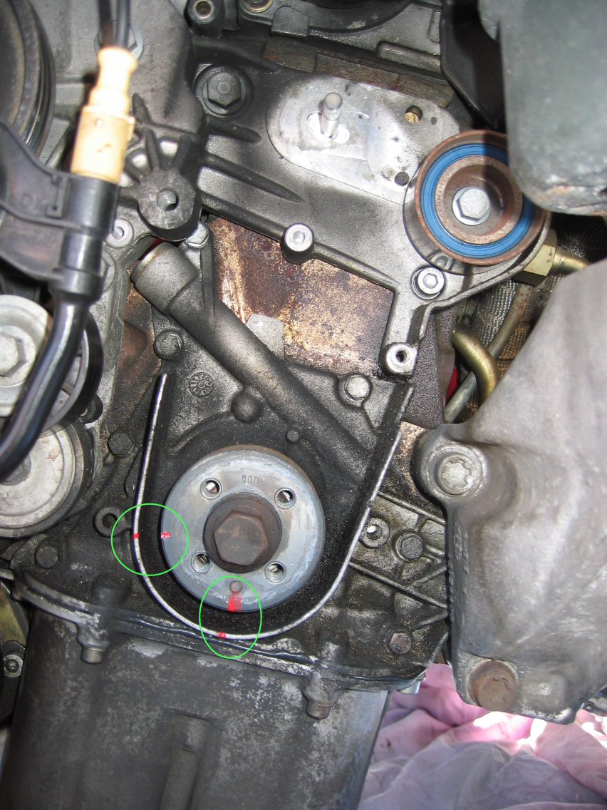

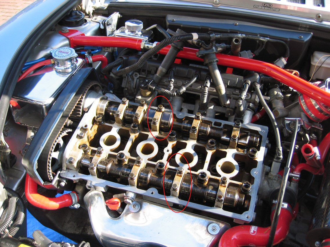

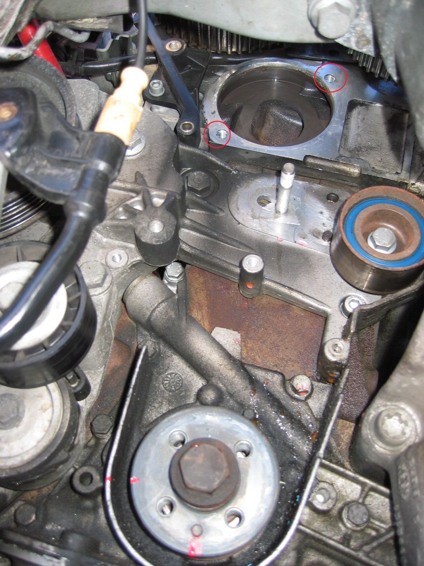

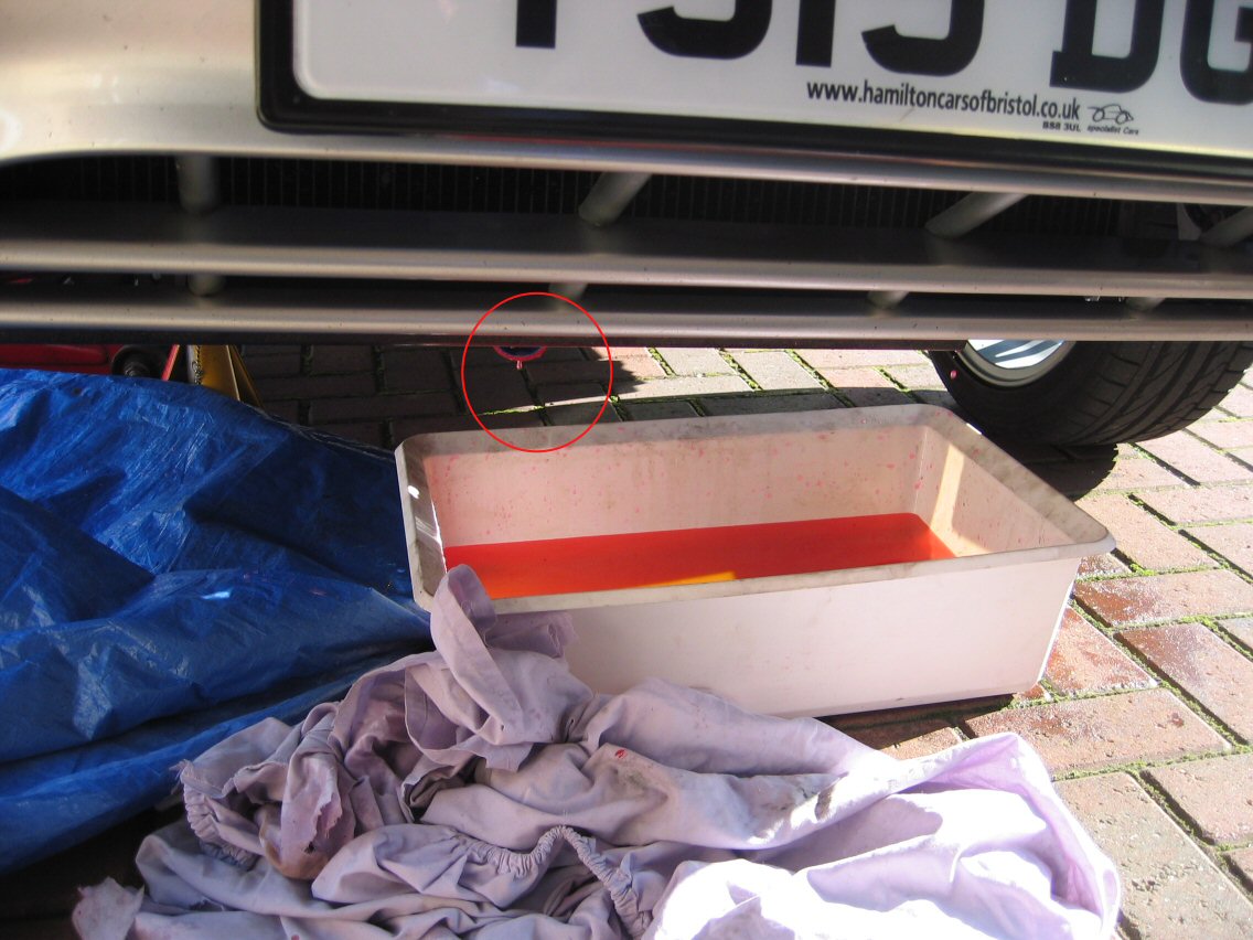

Today was cambelt and auxiliary belt replacement day since the sun was out first thing this morning. I also replaced the water pump and fitted the smaller auxiliary belt drive wheel while I was at it.
Below are a load of pics showing the steps taken (y) If you want any info just ask.
