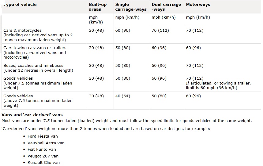

So, can we clarify this clearly and once and for all?
If this is wrong let me know:
(from direct.gov)
There are two possible scenarios that the Doblo could fall within:
Scenario 1.
The passenger carrying version of the Doblo is the car that the van was derived from, the car limits apply.
For the Doblo Cargo the rules are different.
If the Doblo Cargo suffers from the 2000kg limit then it is a car derived van, so the passenger version is fine as it is a car that the van was derived from!
Scenario 2.
The passenger carrying version of the Doblo is a van derived car, the car limits apply as it has windows and back seats and is designed to carry people and their associated luggage etc.
The Doblo Cargo is the van that the car was derived from. Therefore, it is a goods vehicle under 7.5 tonnes and should follow the limits in the table above at all times.
Anyone follow that?:D
i predict a lot of people caught out by this!
I have been one of them, not only fiats but transit connect high top, and the vw caddy too. I got done on the A38 to Plymouth by a camera van in a connect (n)
NOT A HAPPY BUNNY!
This 60mph speed limit only applies to commercial vehicles.
It does not apply to a private car, be it an MPV or any other type of
private vehicle. The V5C gives the details of the vehicle type.
A manufacturer's van derived car as long as it is registered as a private vehicle
can drive at 70mph on the motorway and on dual carriageways with a central barrier or reservation and 60mph on unlimited single carriageway roads. (y)
If the weight parameter applied to private vehicles, Rolls Royce
would be out of business!! :D ;)

I was tugged on the a13, old bill gave the over weight limit and done me.
Funny though he said the limit was 60 but i was doing 80.
Didnt argue and swallowed
Good money maker for the powers that be. I wouldn't have known about this, I have a Doblo 7 seater, must look that up now.
The axle weights are always a little higher. If you were to load the vehicle more to one end you could be under the max vehicle weight but over the axle weight. They always are a little over.
It used to be that if a car derived van had no rear windows fitted the van speed limits applied but I think it's more the taxation class now. Goods or private.

As I've been seeking to find out what limits apply to my Doblo I went to hunt out the GVW - 1935kg - Also my V5C clearly states car derived van on it.
