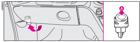

Hi thanks for your interest and reply I am not sure what the fire prevention button is ? Where it is? and what is it’s function? Any input // information would be much appreciated. My vehicle is a 2006/7 fiat Doblo highroof MPV fitted with 1.9 jtd 8 valve Diesel engine.
Thanks George
Hi thank you for your replies I located the inertia switch this morning and it didn’t require a reset so checked out supply to relay 85 and 86 got continuity on 85 earth I think and 8.62 volts at 86 not sure what that meant? So decided to charge the battery which I think could be suspect and do something else for a bit. The something else didn’t take long and I found myself giving the engine several coats of looking at with a puzzled expression. Whilst randomly poking and checking wiring connection for tightness I touched the plug that goes into the sensor at the rear of the high pressure pump it was tight but you could rock it in its holder and was easy to pull out Which I usually fight to get these type of plugs out but the clip was not holding it in . A few moments to investigate the clip Check the pins make sure it was working and the plug now seated properly and bottomed correctly when the clip held it.
