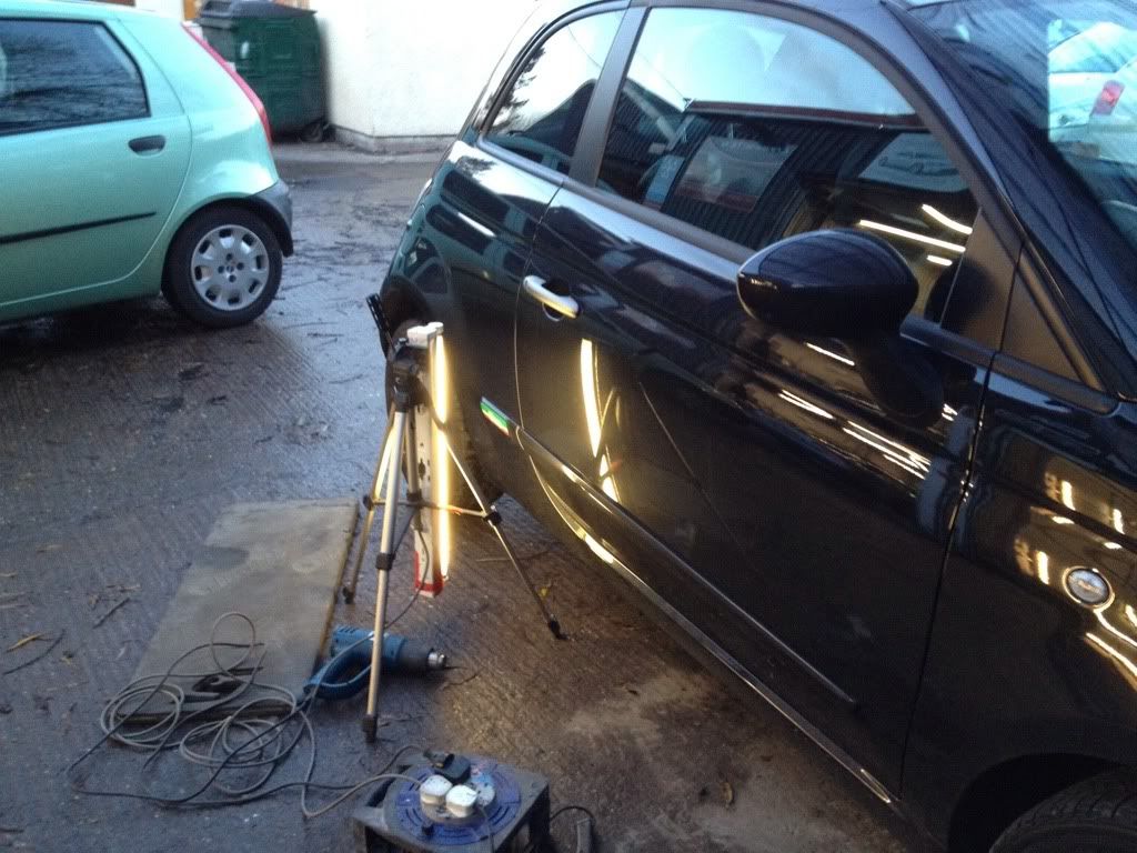

Currently being sorted. Typically, the area is double skinned so options are drill a hole or go for the glue option. I've gone for the latter!
Fingers crossed......
The dent is too small & sharp for the glue to do its thing so went for the hole option:eek:
Again, due to the location (on the exact join between single & double skin) it was hard to get at with the tools.
I ran out of time so hole bunged, liner refitted & booked back in for 1/12/12.
