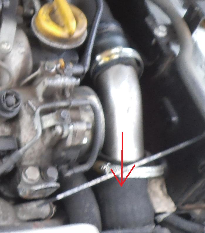

long run today down to elite in rainham 58 miles each way, on the way back lost boost pulled in to a carpark thinking boost pipe had popped off but a connector on the home made pipe i made ages ago was squashed in i adjusted it and it was fine after that,
Then about 20 miles from home oil pressure light starts flashing i did not see message with it and forgot what it means so i pull over check oil that was fine, start off again no light at first then it comes back flashed for a bit then disappears, i drive home slowly behind the lorries very worried, got home check manual and it just means oil change is due, I've just done that but didn't reset any thing with mes yet so was a worry for nothing :eek:
lost boost today overtaking on A12 no warning lights i thought boost pipe had popped off again, got to where i was going checked top boost pipes they looked fine too dark and wet to see bottom ones. came home and boost was back until i booted it again when nearly home. i am thinking that join in home made boost pipe is sucking its self in but popped out when i went to look. what do people reckon could it be some thing more serious?
