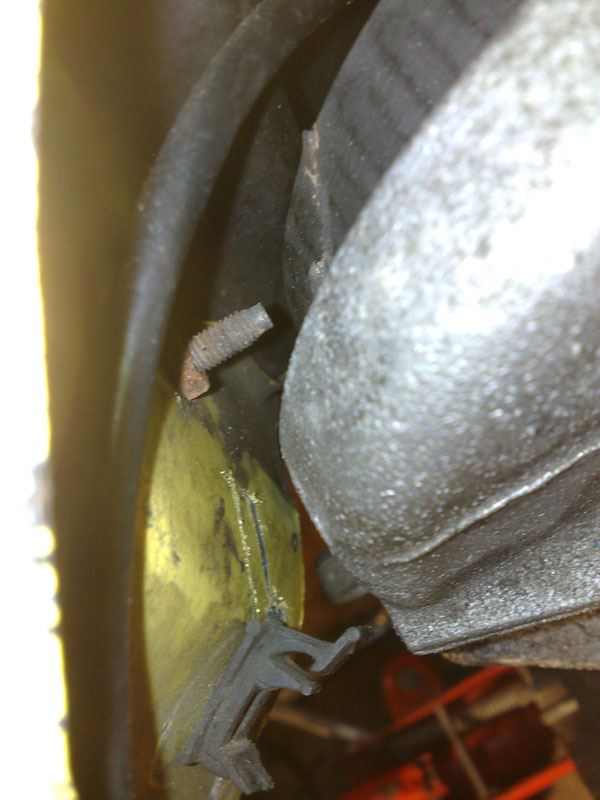

this was it on mine;
i ground that bolt flat else it would've eaten the cambelt

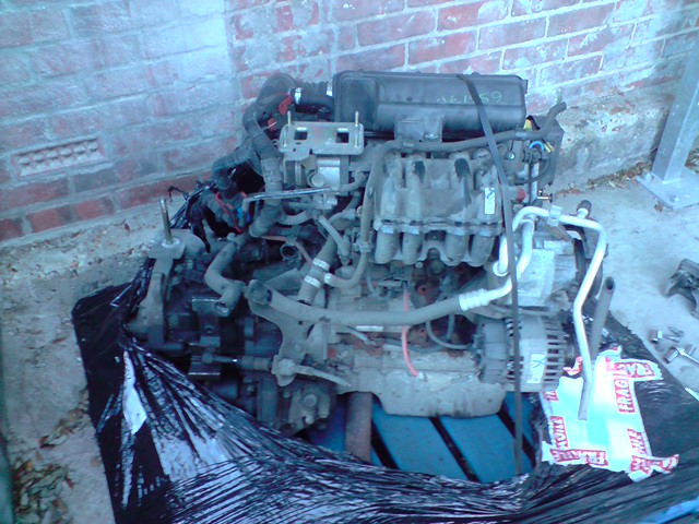

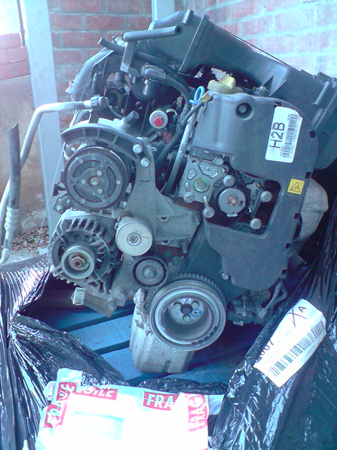

One new engine just delivered, complete with pretty much everything. lol

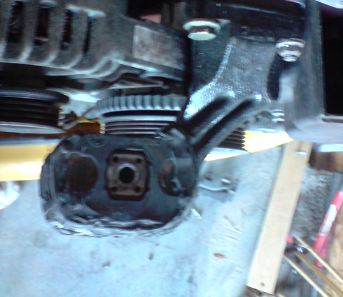

Photo showing engine mount that the power steering and alternator bolts to. This all had to be removed to attach the mount to

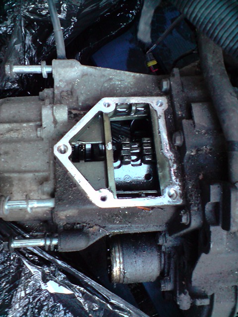

6 speed stilo gearbox with stilo selector on top
Selector removed
Cinq selector fitted after sealing up
Power steering and alternator removed

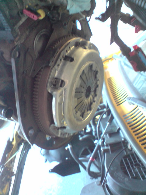

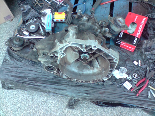

Gearbox removed and new clutch fitted with plate using a metal pole with a bit of electrical tape around the end
Engine mount fully cut down and fitted with spacers, cant quite see the spacers but the alternator spacer to fit the 60a punto one was made using the engine mount corners.
Gearbox off with new thrust bearing fitted

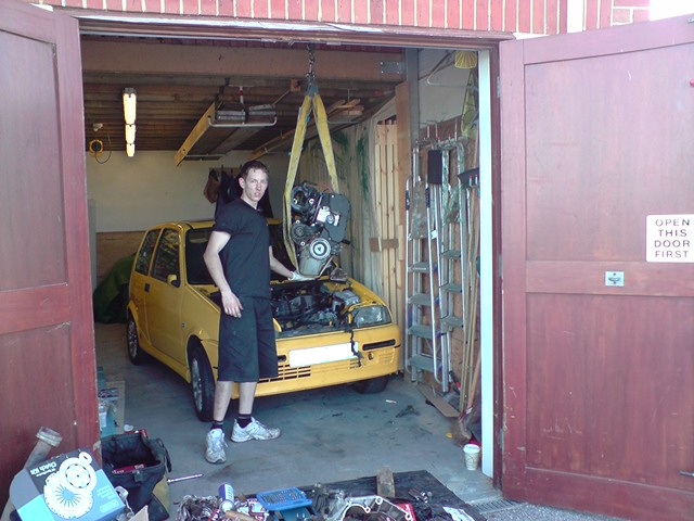

Engine about to go into car. All water pump, cam belt tensioner replaced. Bit of a pose, but had to be done.

All engine mounts were completely covered in sealant and bolt next to cambelt was replaced about a month ago in prep.

Gearox connected up last night, just to check everything is ok. The 6 speed box, clutch 'actuator?' arm thing is at a different angle so using circlip pliers you can undo the retaining clip and slide the arm off. The cinq one fits perfectly.
Might sound funny, but is there a way of telling if we have done something stupid and knocked the thrust bearing off of the spline without dropping the engine down. Cant see through the hole in the top of the box very well. Pressing the clutch in, i can see the clutch move off of the flywheel, but does that guaarantee that its the bearing pushing it and not the arm that moves the bearing, if you know what i mean.
