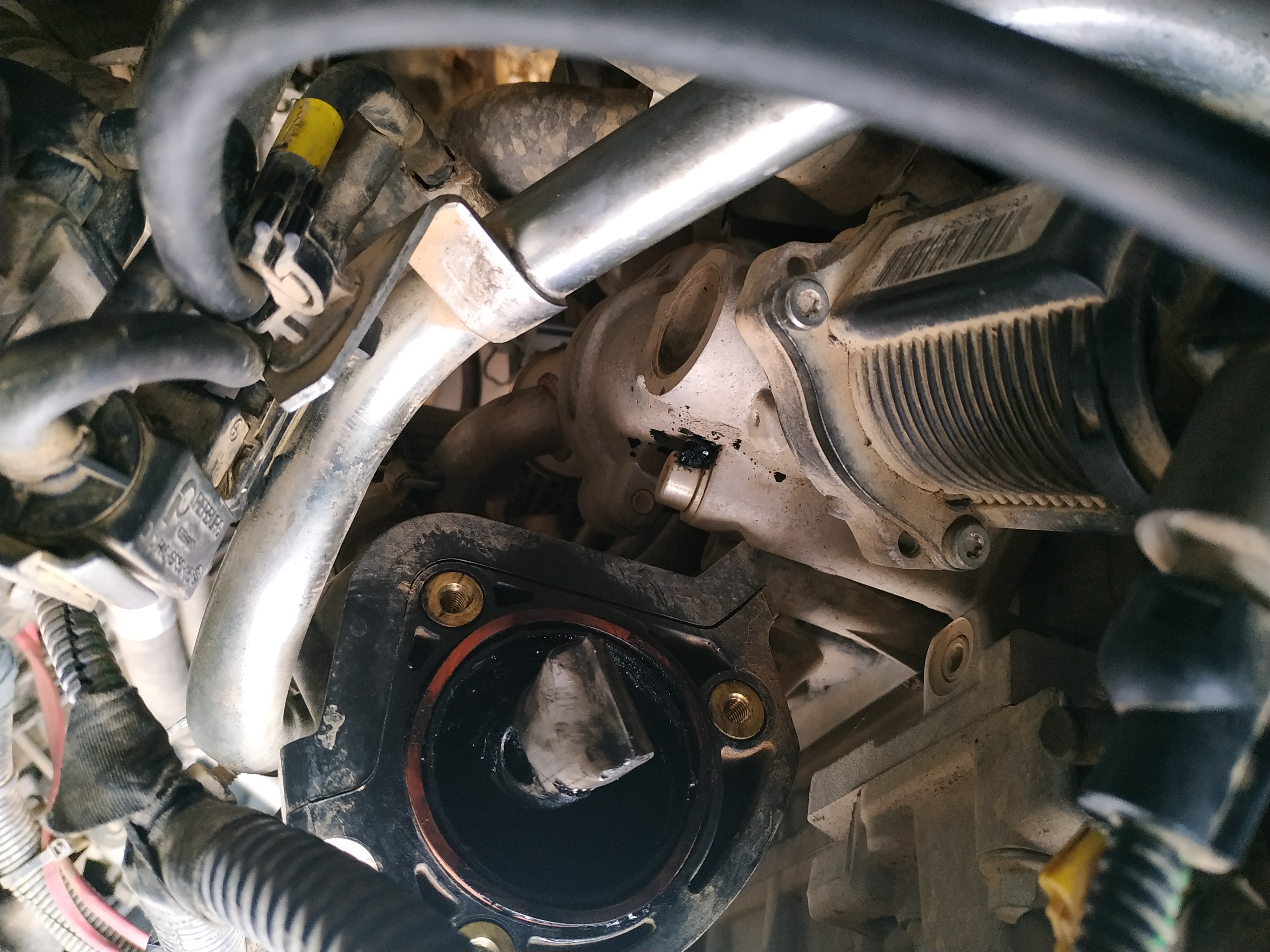

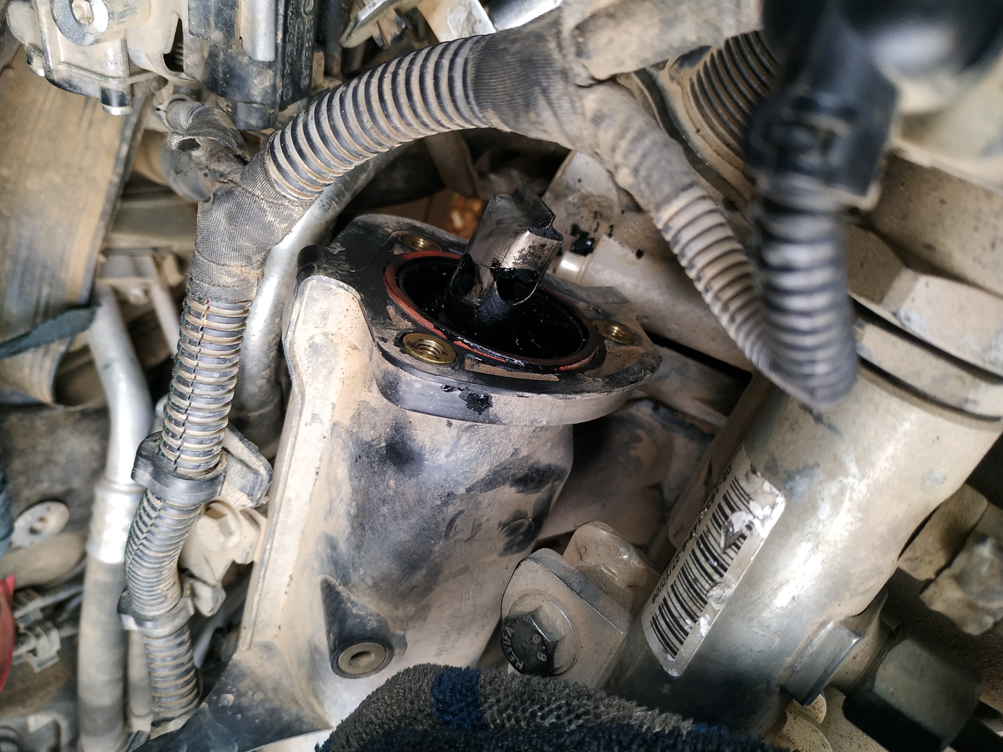

Taken off inlet manifold and its fooking caked.
Well i cant get it off i just took the pipe off.
I bet thst pcv is blocked and when the raidtor kicks in its sucking all that **** through onto the cylinders.

My GP 1.3 has also got a ton of crap in the intake manifold, unfortunately I didn't get around to cleaning it out over the weekend,
When I checked it last week, I was able get a long screwdriver in there but only got a small amount of rubbish out before it started to rain,
Anyway, hopefully I'll be able to let the manifold soak in a buckle of warm soapy degreaser this weekend, also I'll be using a long ish bottle brush to scrub the inside amongst other tools

Oh dear, looks like this chap is following the same route I often do. Failing to look at the simple stuff first! carbon/muck fouled inlet manifolds, ports and EGRs on diesels and direct injection engines goes with the territory these days. If it's got over 30, maybe 40,000 thousand miles on it have a look into the manifold - you'll be shocked. It'll probably go on driving reasonably acceptably up into the 70 to 80,000 miles if you're lucky though. When I sorted out "Tony" our old 1.9tdi Cordoba I handed the manifold in to a local engine reconditioner who put it in with the next load of components in his high temp chemical cleaning bath (think he charged me a tenner?) I got it back looking almost like new and it didn't hold me back for the coupe of days he had it because it took that long to clean the crap out of the head (My back was killing me by the time I finished!

Charlie comments above that I'm into carbon removal and it's true that, with me having owned several diesels and now a DI petrol I'm probably more interested than most. Here's a clip that shows how shockingly bad it can get This is directly downstream of the EGR (you can see the threaded holes in the manifold which would hold it in place) The diesels tend to be clogged with a gummy muck which is sometimes baked hard near the EGR and the bore size can easily be reduced by half. There are a multitude of, highly entertaining, You Tube videos of people trying procedures ranging from oven cleaner (I've tried this - VERY mucky but works really quite well) to others spectacularly burning them out! could just see that going down a bomb with my neighbours on my open plan front drive. The petrols I have very little experience with - yet. But it seems the deposits are much harder baked on, especially on the back of the inlet valves. As I've posted before there's a very interesting piece on the Oilem website about carbon fouling on the VAG TSI engines. Just of late I've been reading about a piece of kit BMW have developed, in particular for use on the Mini, which uses Walnut shell as a blasting media to clean the ports and valves. I like the look of this and as I have a nice big compressor I'm looking into building a DIY version for use in Twinkle (1.0 direct injection Ibiza) when she needs it.
