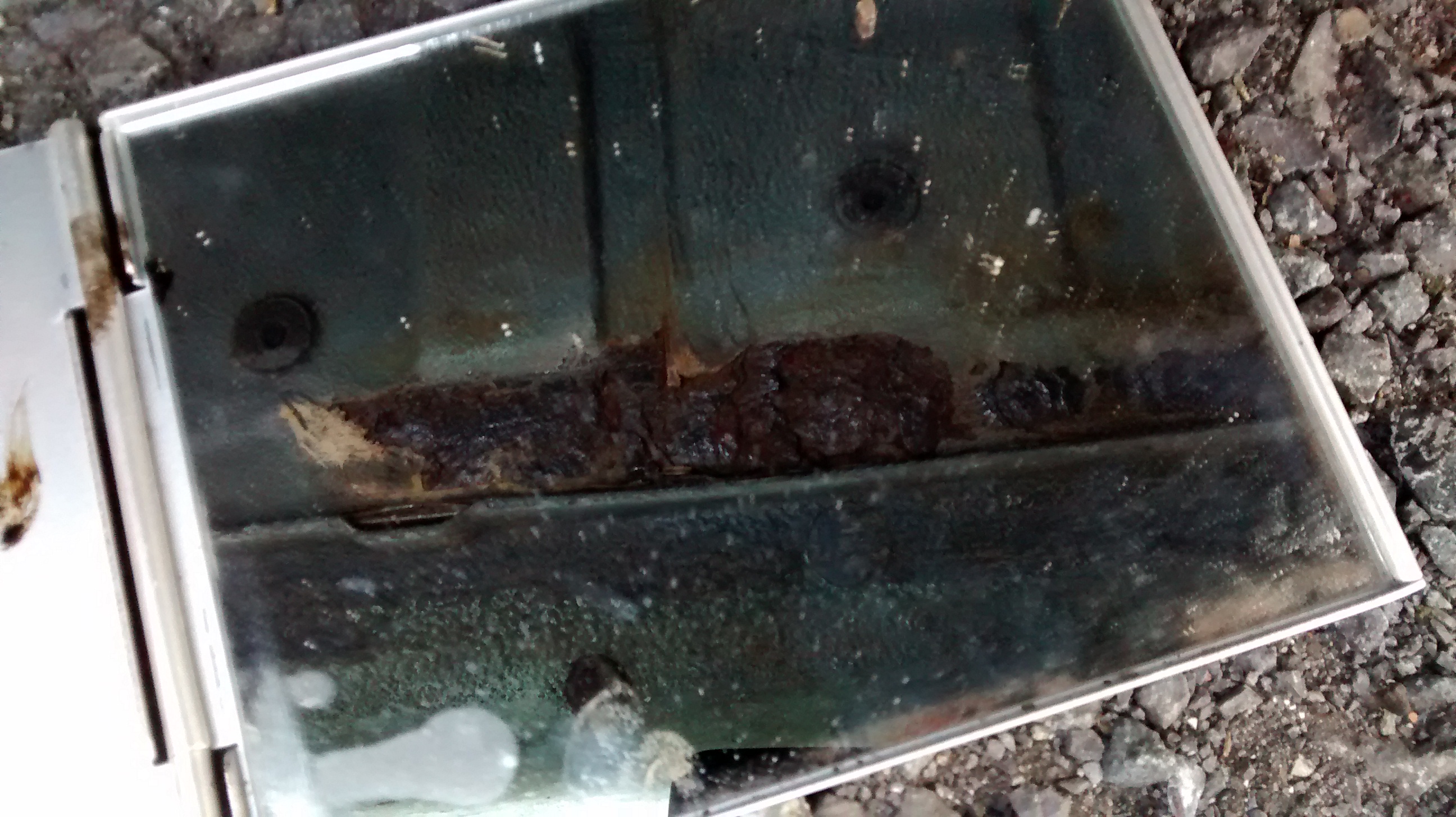

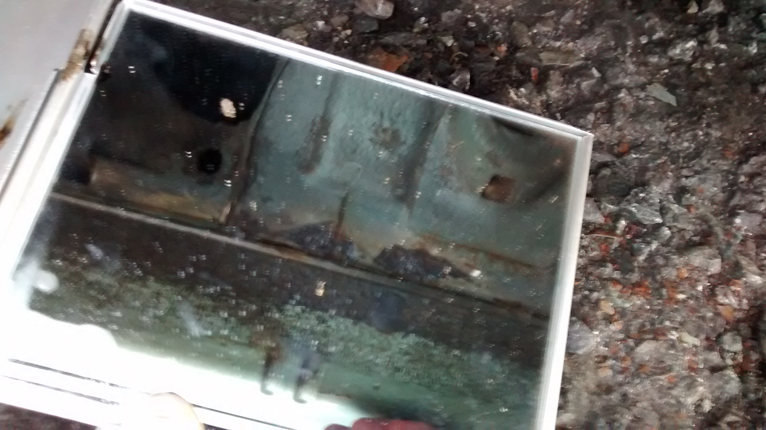

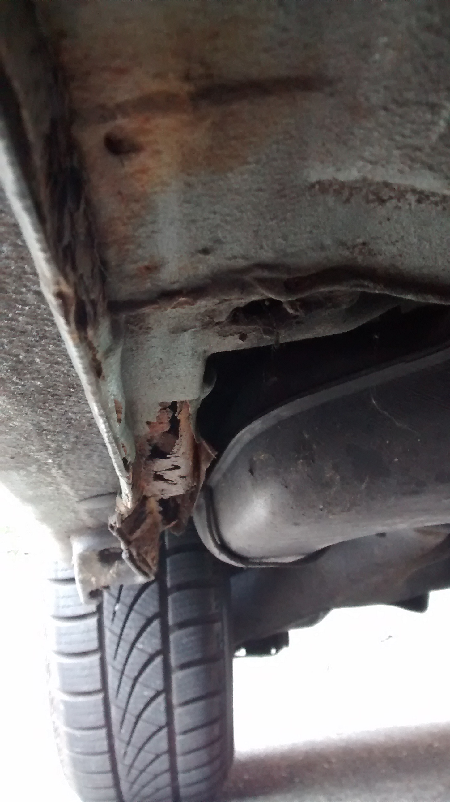

Well, I did wire-brushing, then rotating wire brush with drill. The hole's much bigger than I thought at first, this shows it pretty well (hard to get the depth of field, I'm just using camera on phone):

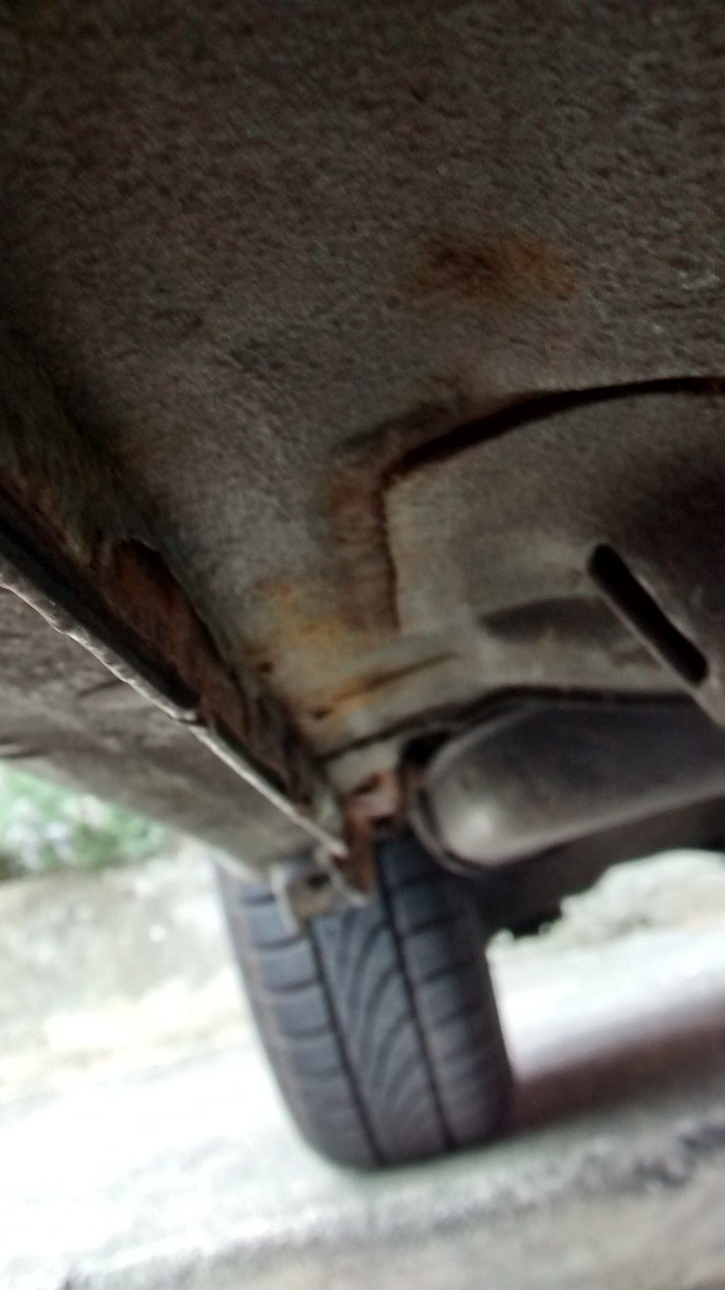

The hole is pretty long, in total i'd say there's (at least) a good 6 inches of sill that is holed. I didn't go too aggressive at the cleaning due to proximity of bits of fuel system.
Working down along the sill, the browny bits opened up pretty uniformly. I've tried to get a couple of pics:

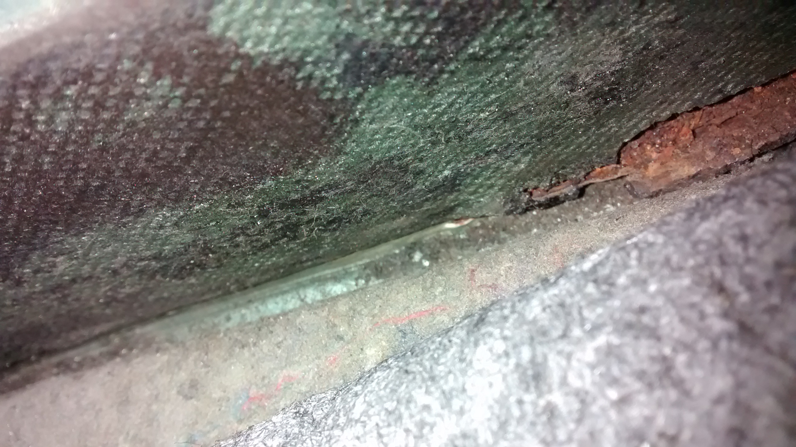

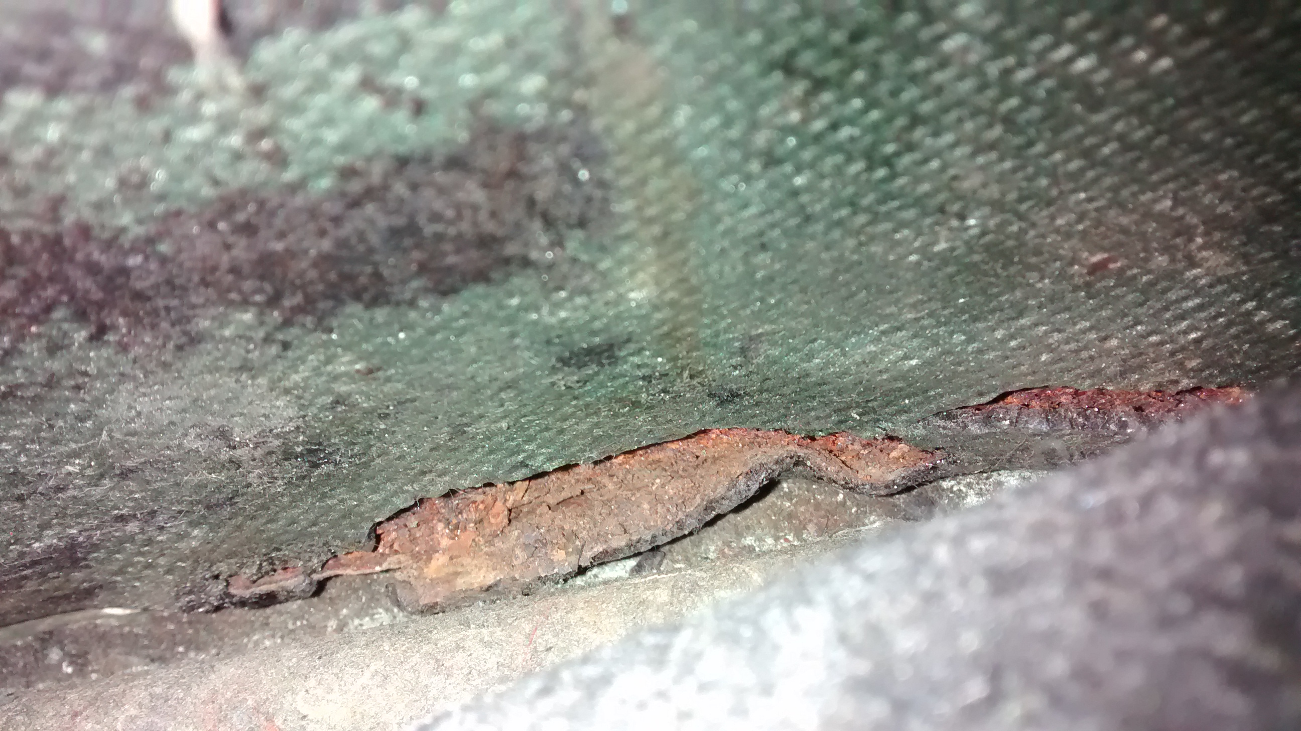

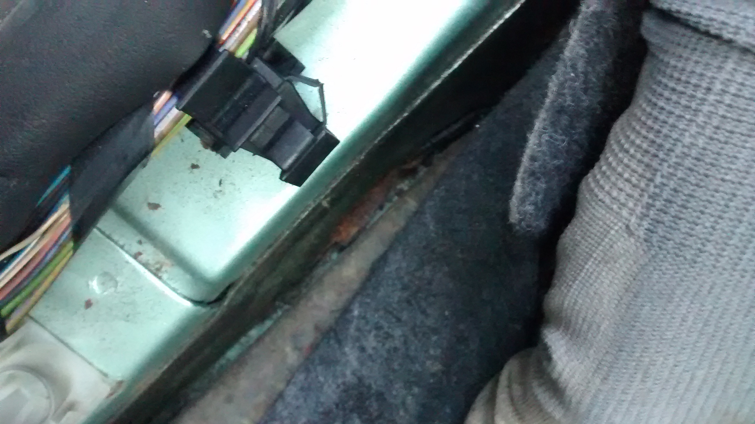

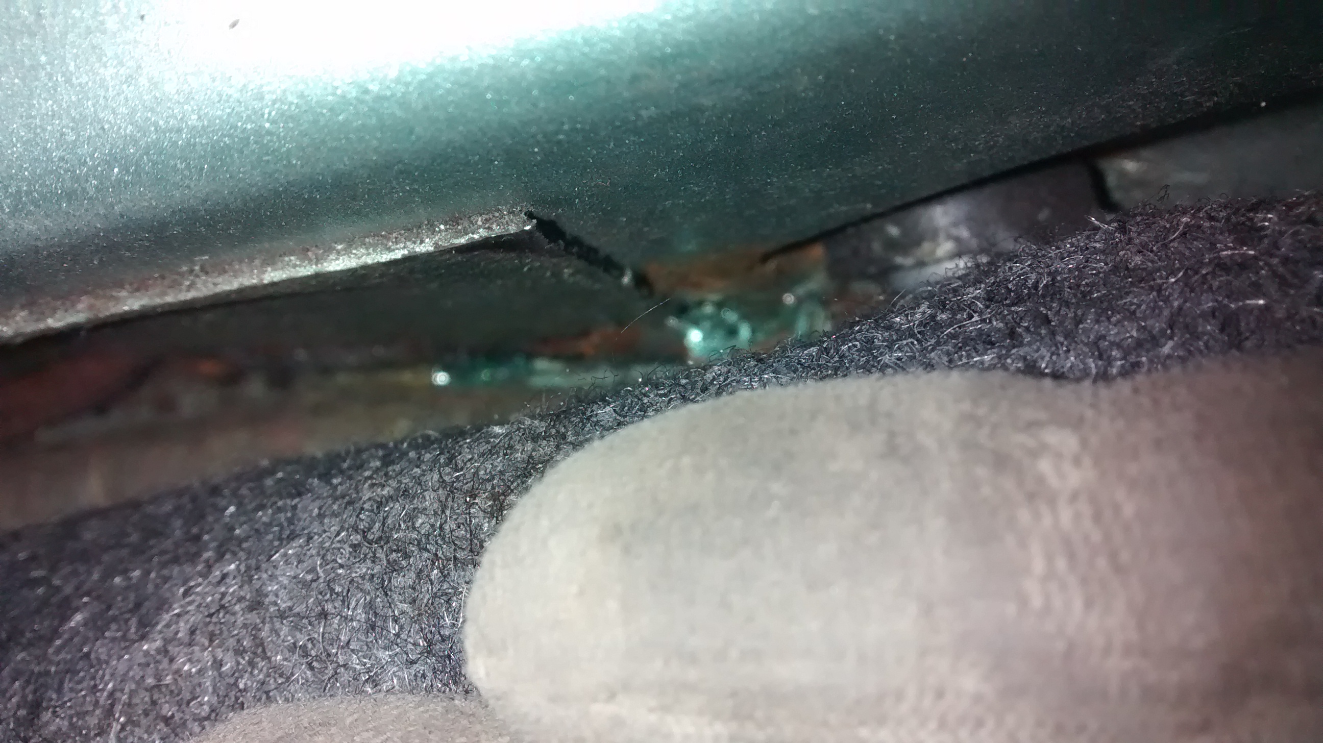

I then thought to look under carpets (as suggested). I did this on driver side at front just because it was pretty obvious to me how to take off trim. There's clearly rust down there too.
These pics are a little hard to understand maybe, but hopefully the first orients them and the others follow. Second and third are just at the bit where the sill and floor meet. I don't quite understand why this looks as bad as it does.

Like I said, prepare to weep...
It's the design at those points in the sill there are lots of overlapping lips of metal, all spot welded together. When the underseal blows, there's lots of places that trap water. Between the flaps. Unfortunately, the start can be where they are jacked badly on the sills.
Inspector can only fail what he sees.
Like I said about the rubber, it hides things until they can get fairly bad.
Fixable though, cut out long slot and patch new bits in, underseal then you can keep your car going.
Btw, unless you really need/love the car, this might be a reasonable point to part company, it would definitely fail mot now...chassis weakened.
On the other hand, it can be fixed.
