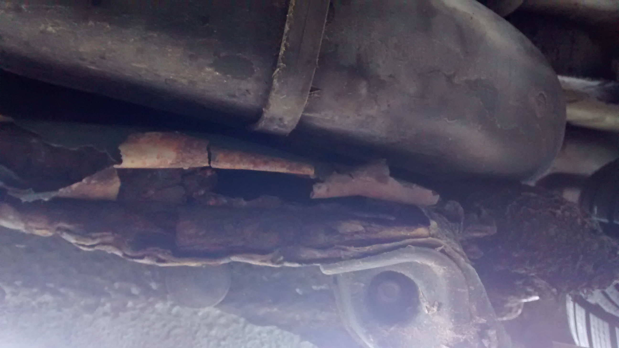

I was doing a bit of investigation under the car (Punto Mk2, 1.2 8V, 2000AD) today to see what corrosion scenario was. Had gotten a look under it while it was on lift when getting exhaust replaced, and they mechs had said it looked ok, but I wasn't 100% happy.
Anyway... gory details, and I'd appreciate some tips on how to proceed.

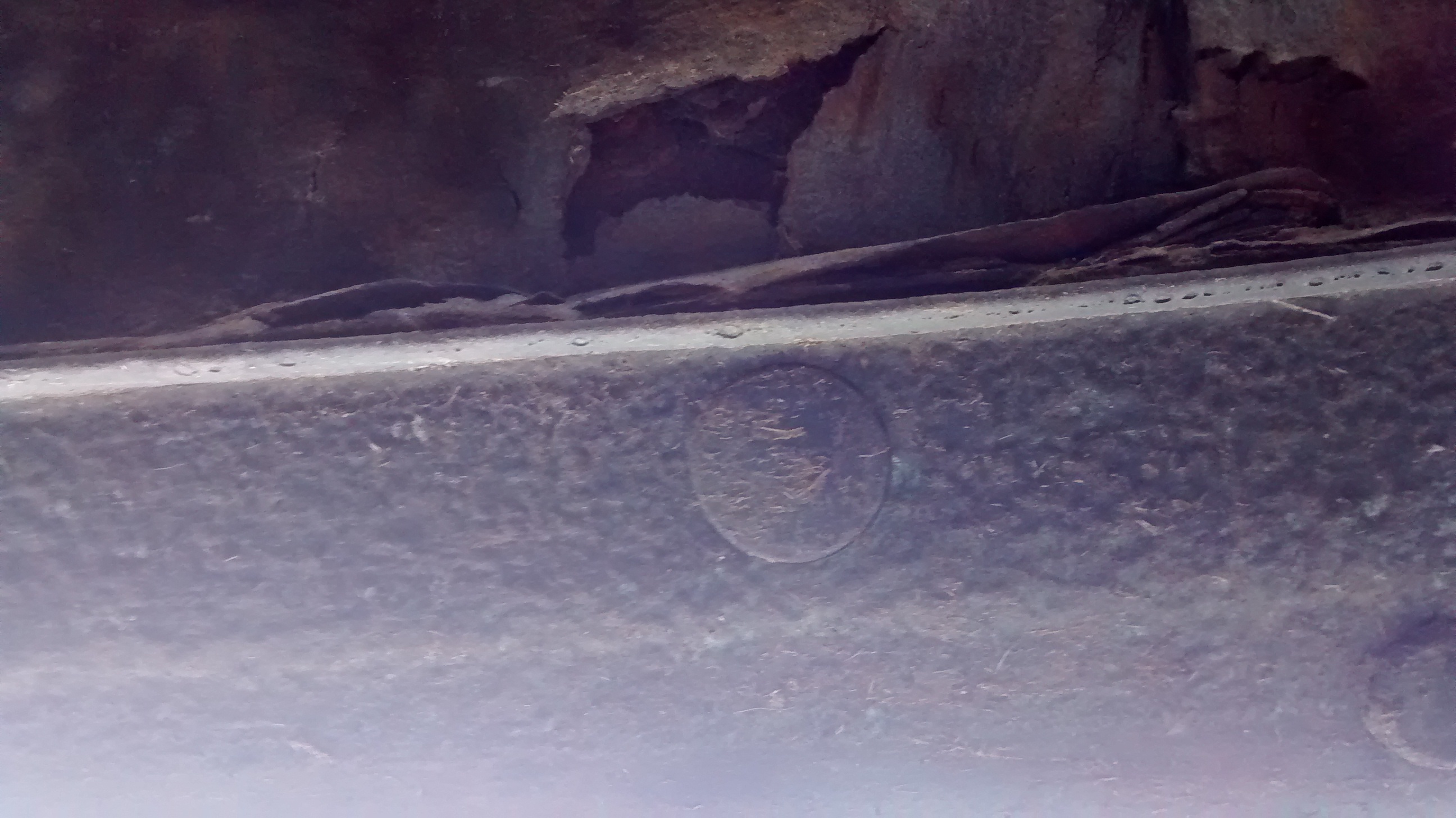

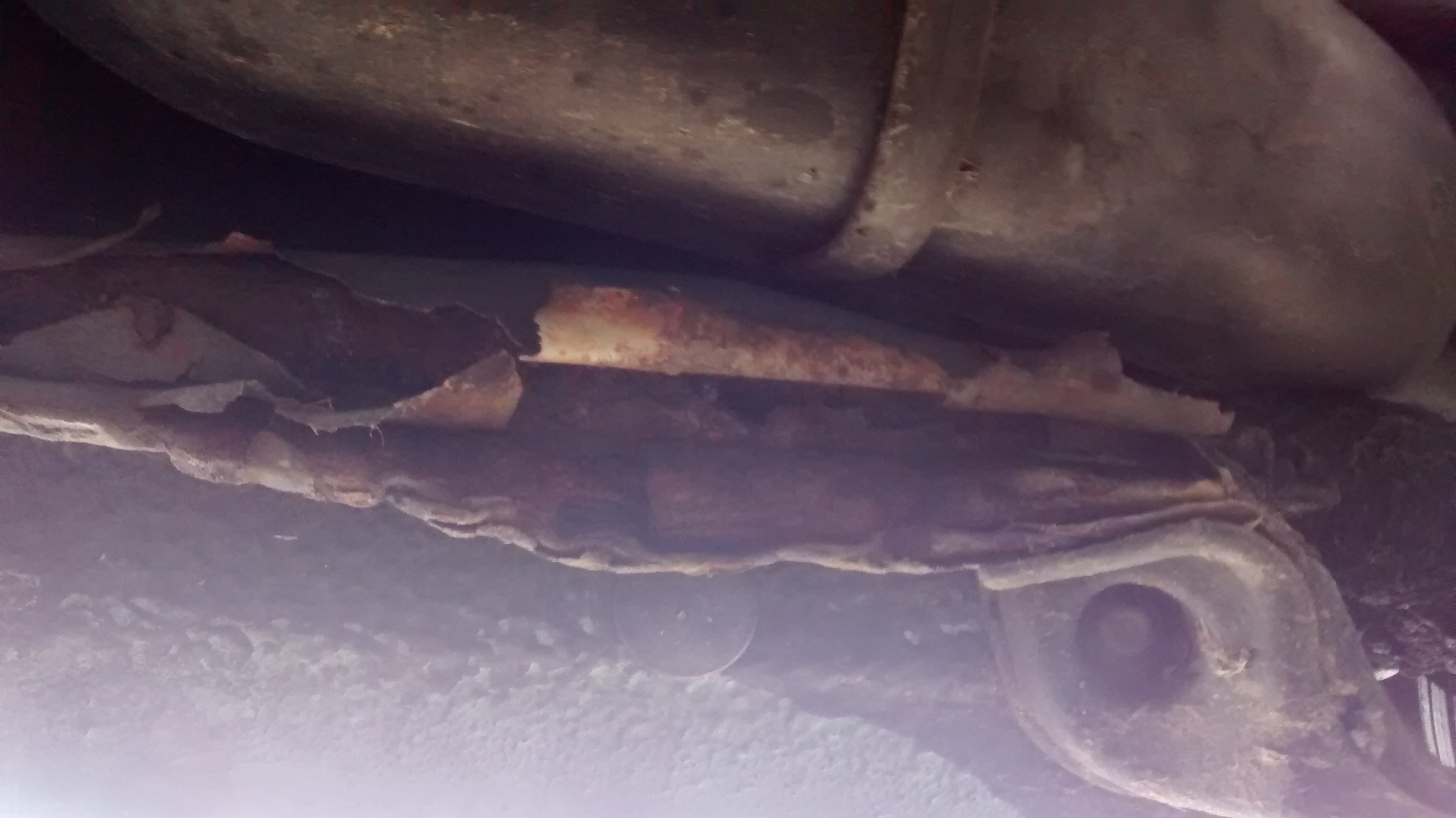

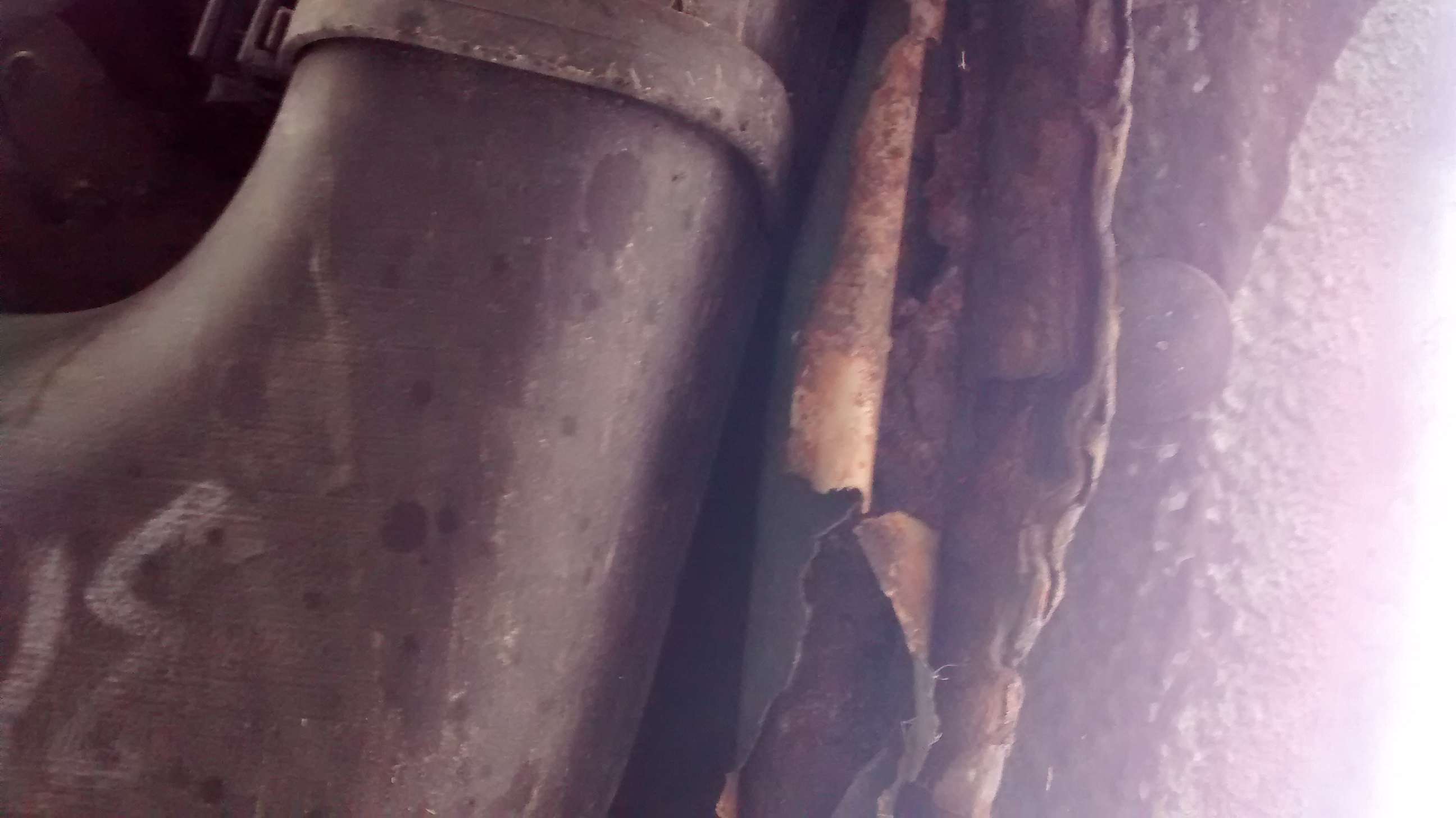

Worst spot is on rear, driver's side (near fuel tank).

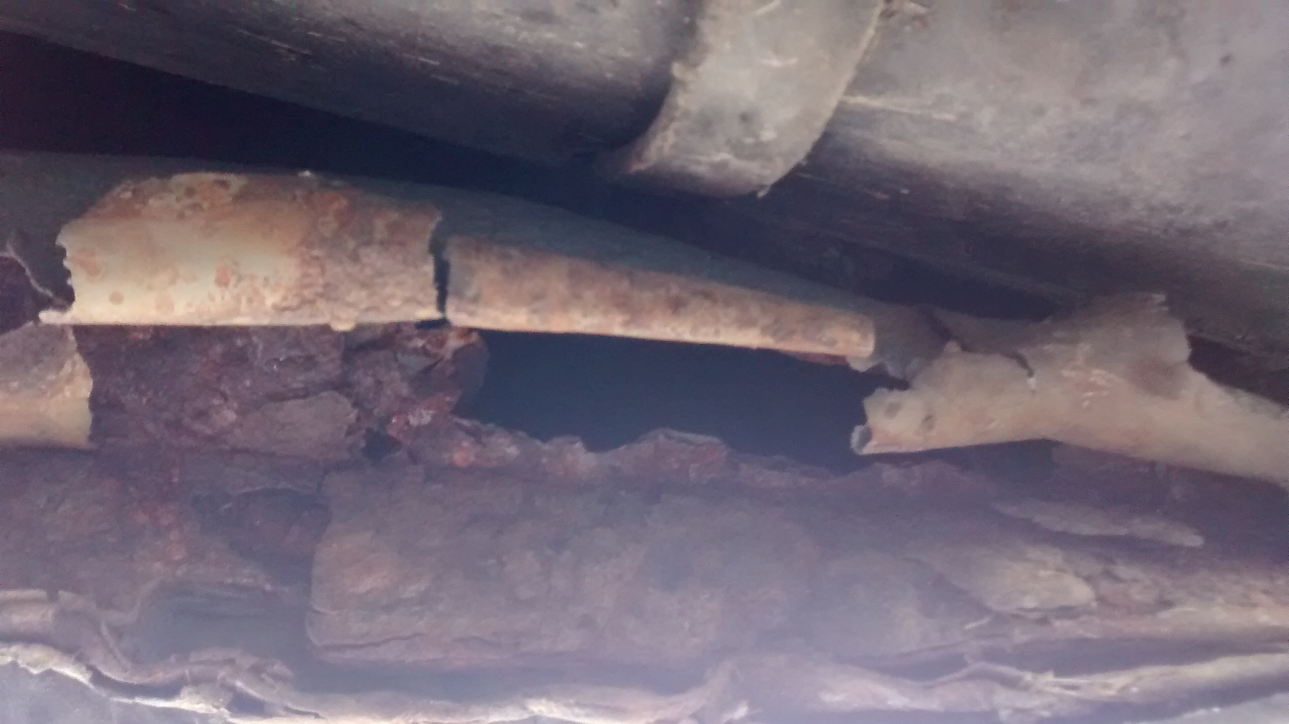

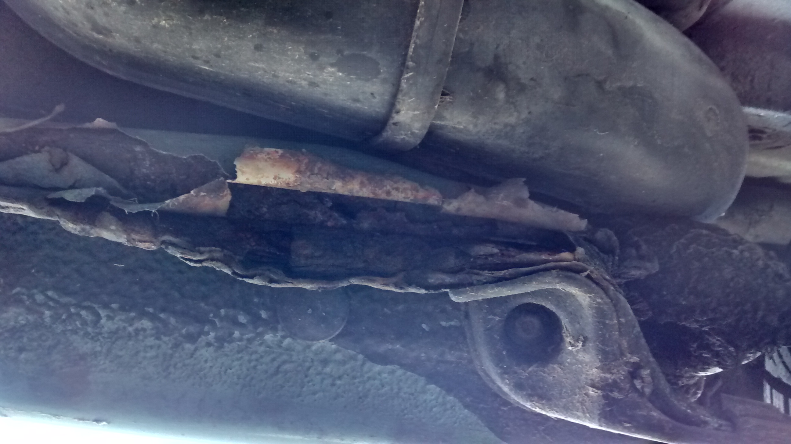

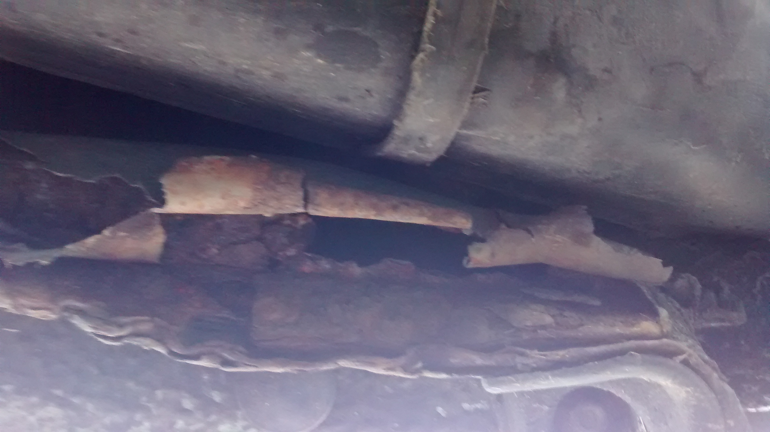

The pics here include shots before and after I brushed away lose bits of rust. There is a hole.
Other rear side not so bad I think, but could do with a bit of cleanup

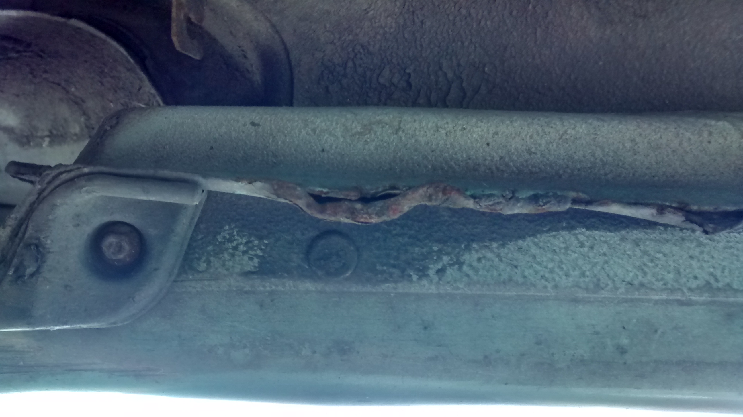

Middle and especially front ends of sills a bit ratty where somebody jacked them with wrong jack (or put stands straight on them) (either way, not me):
Had originally thought of doing a bit of a wire-brush (got attachment for drill) and paint job on the sills. Is that still feasible on middle/front?
Now looks a bit more than that needed on rear?
What would you recommend in your collective wisdom? If I went to garage, what would I ask him to do and what kind of costs?

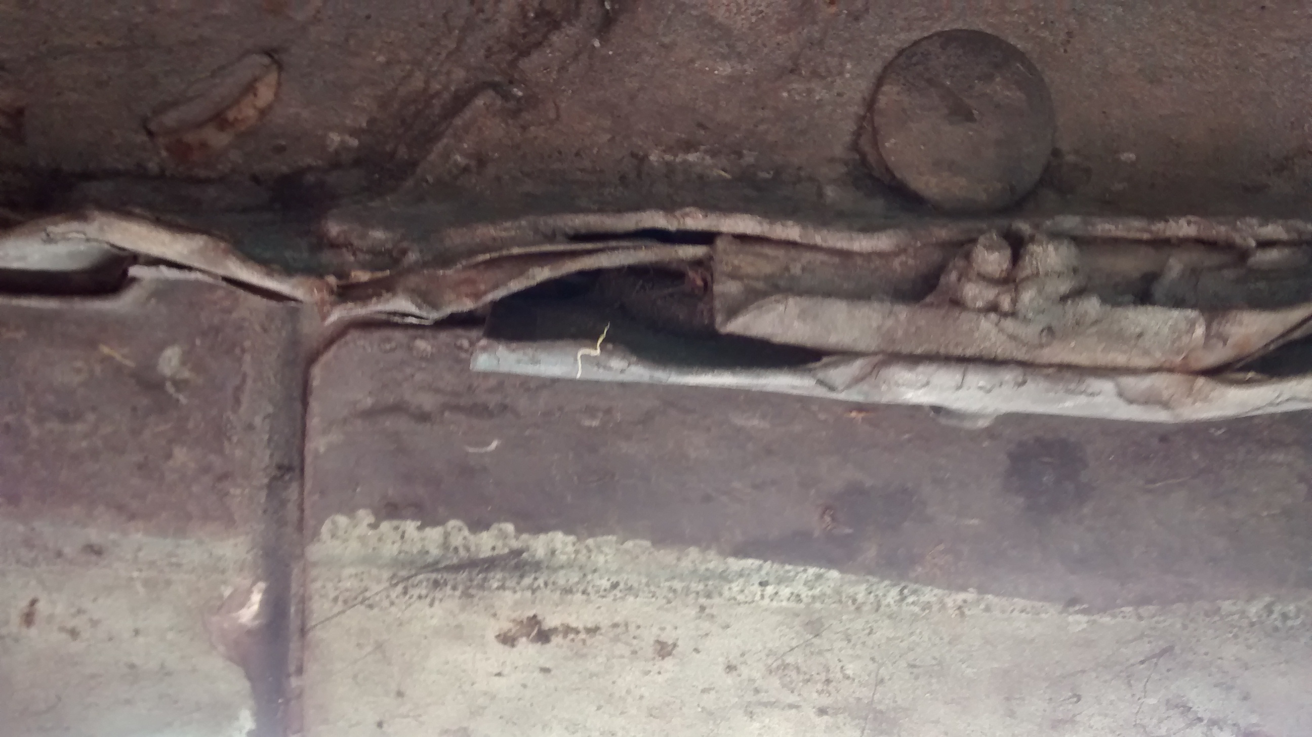

second last pic, looks like hole too.

the second pic, how big is that hole?
also one pic before last that is probably rusted through the inside
thats some real rust, and i thought my car was bad lolloo
The hole is about 1.5 inches long
how do i investigate rust inside? (what you said in relation to pic before last)?

Did a bit of poking and scraping with a screwdriver. Also a bit of looking in wheel arch on fuel tank side. It really seems to be from outside in rather than the inside out story. Damage to the rubbery underseal coating leading to what looks like classic crevice corrosion. The second to last pic isn't actually a hole, though it is a spot where the metal is thinned out quite a bit, but there's still (as far as i can tell this evening) some real metal behind it. Passenger side is overall very good by comparison.

really depends on the size...for a smallish hole like you're talking about, equivalent of 1 hours work rate or so. Charge out here is about £60 per hour. Don't expect any really neat welding, unless you take it to someone that does it for a living.
