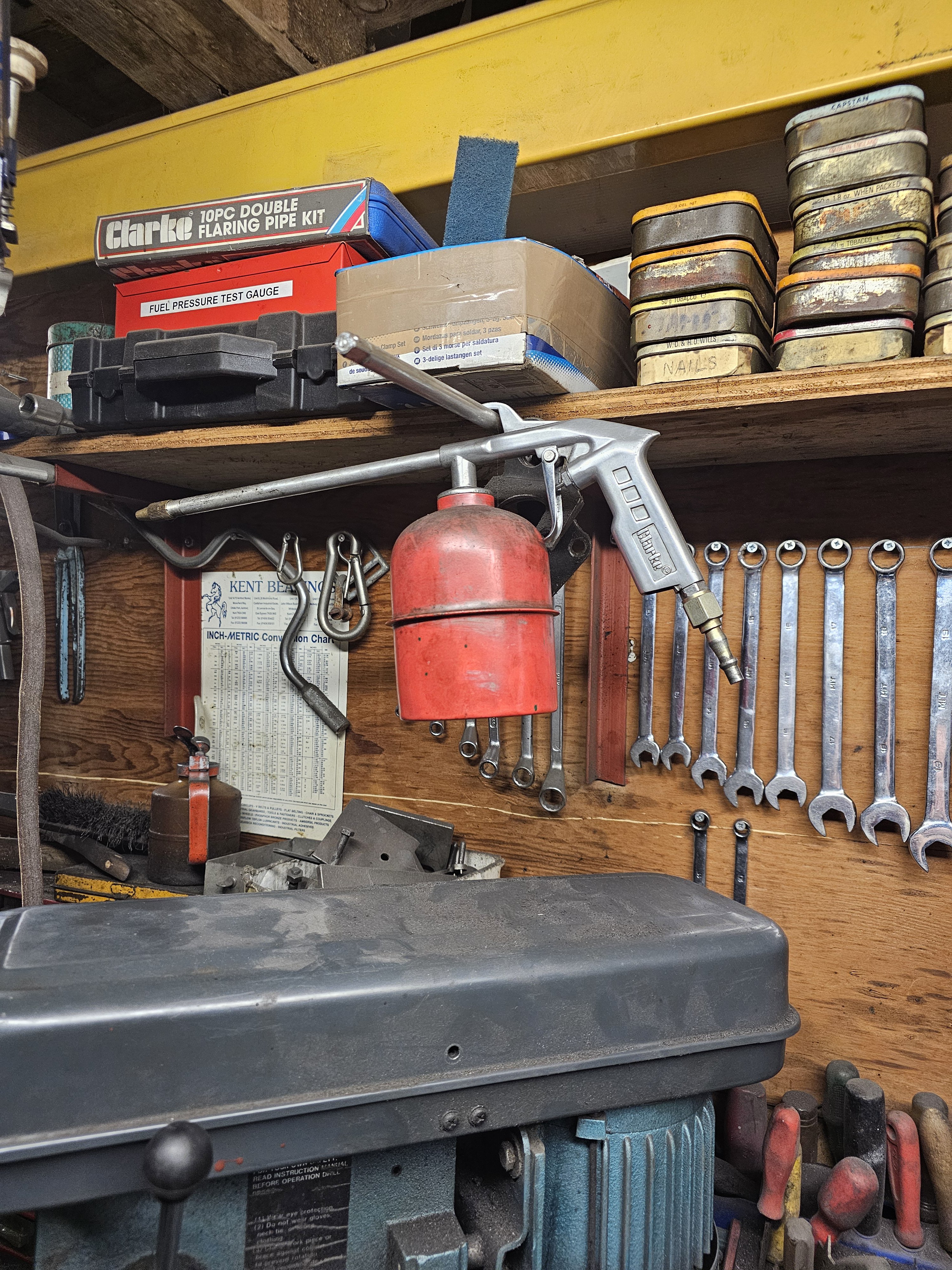

Hello @GettinBetter, I've been thinking about this idea and I like it. What spray gun do you use, please?
Just the standard shitz or shutz type gun. I'll find a pic...
Here's mine....
I like the small tank underneath, as it allows me to get into confined spaces.
As I use an airline, depending on how much you do you may need to evacuate the area, or do it outside.
Ah, OK with a compressor? I used to have one but it died. Useful tool.

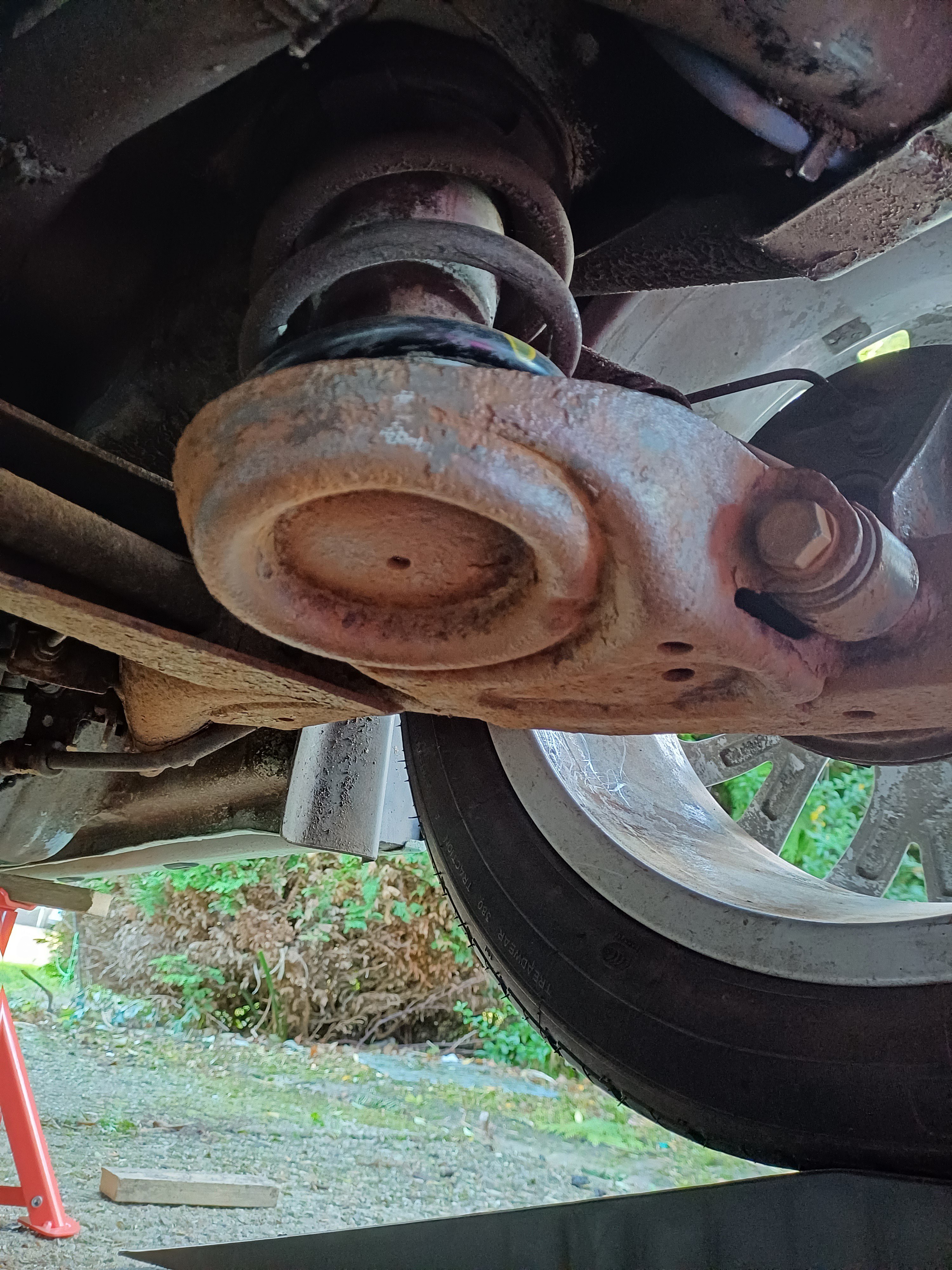

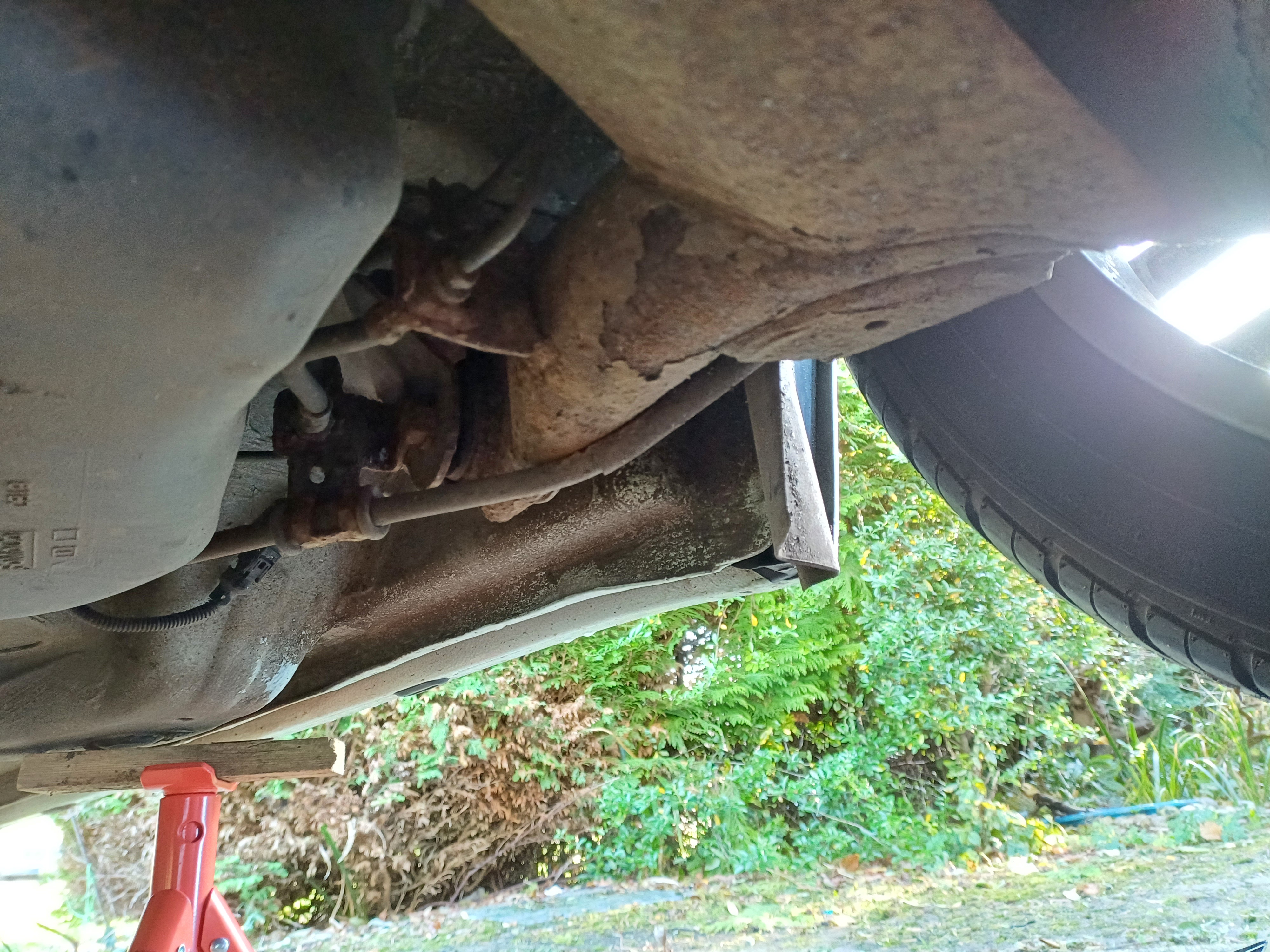

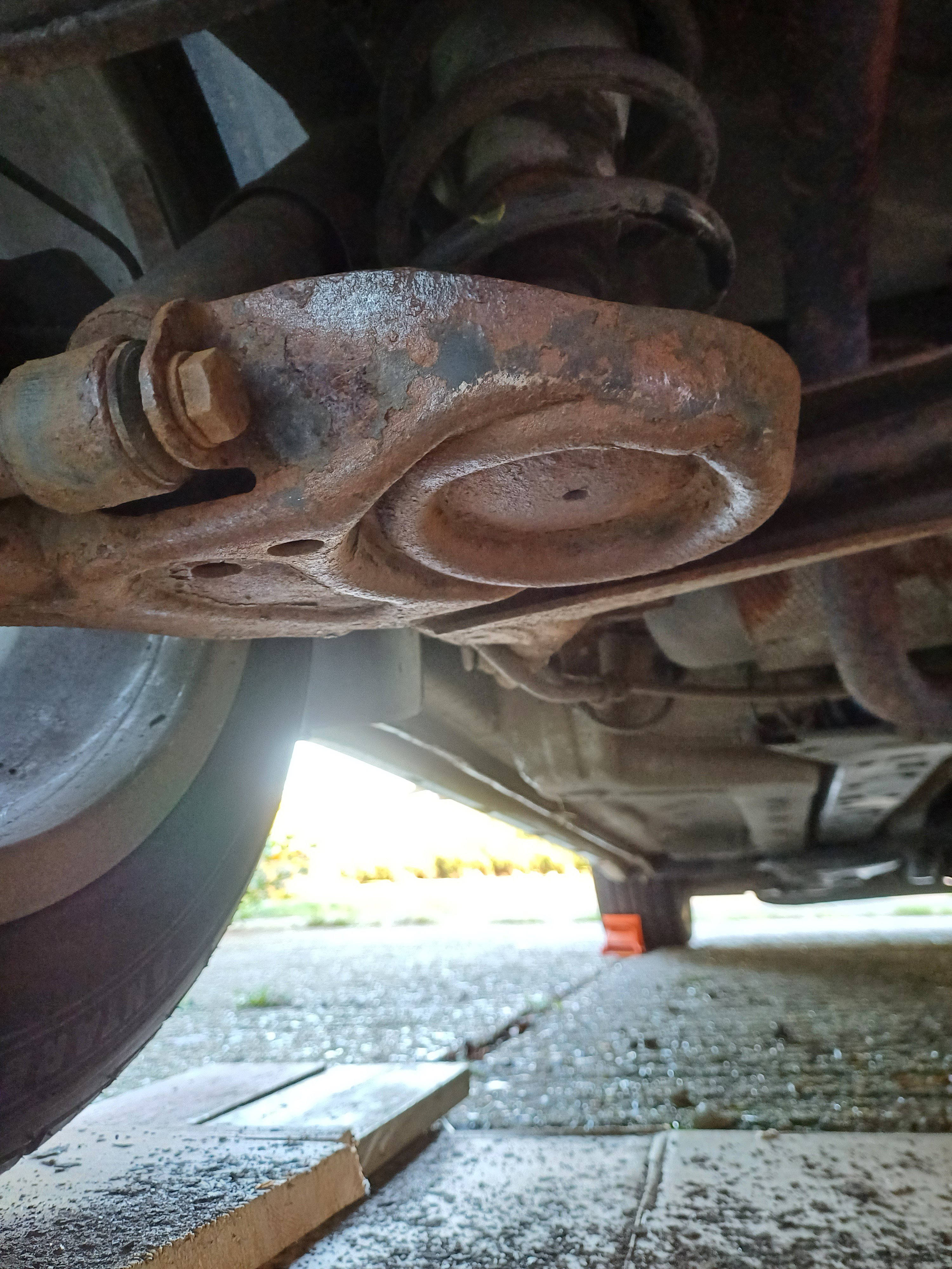

So yeah, the lovely @rmjbn1 advised I take some pics of the corrosion and post em on here.
Yeah. I'm scared. I poked some bits of it, and it's still solid underneath the rust.
Advice on what to do other than stop to having a nervous breakdown greatly appreciated.
Thankyou!
Ps They aren't in order, there are some right side mixed in with left side. Sorry.

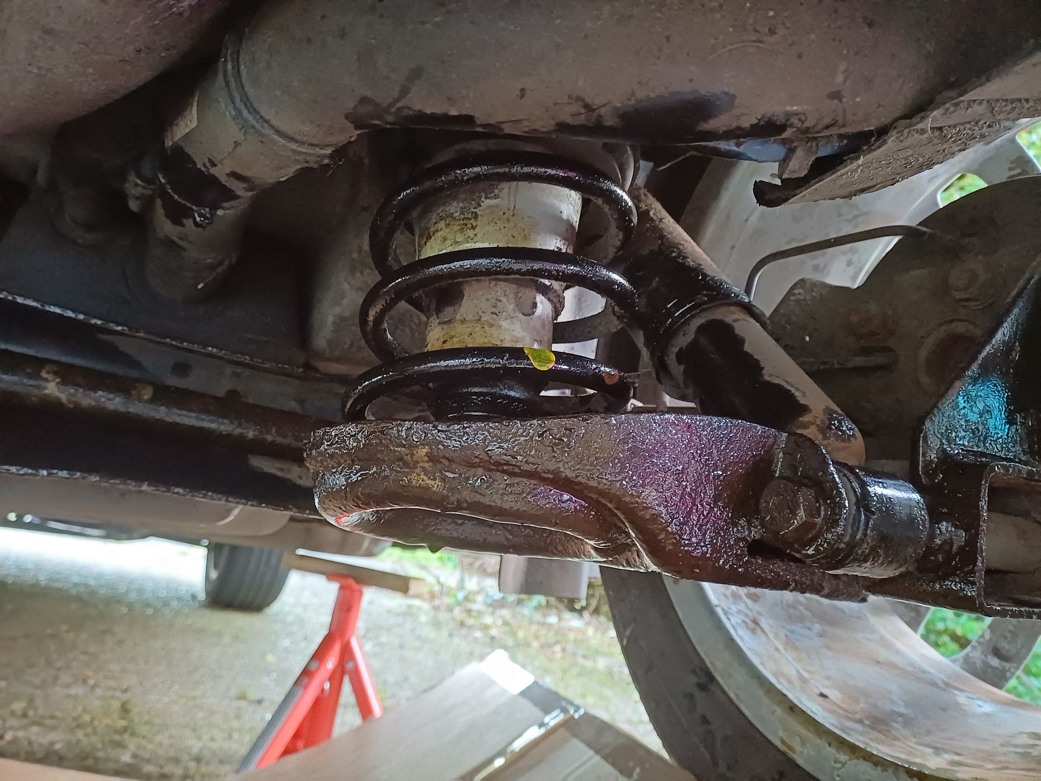

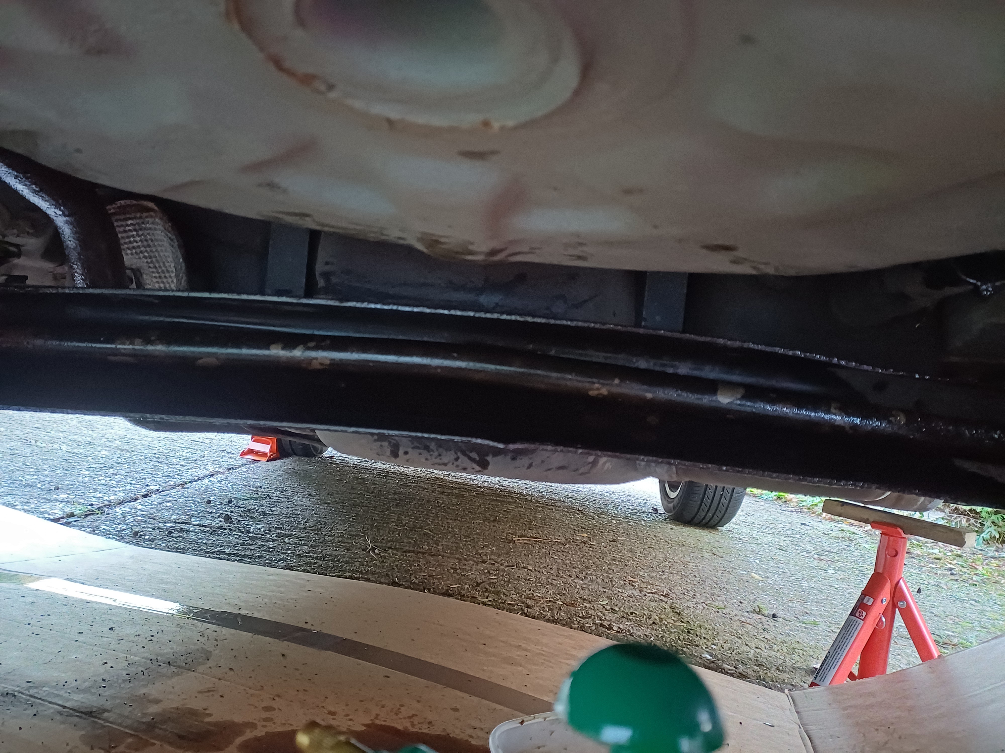

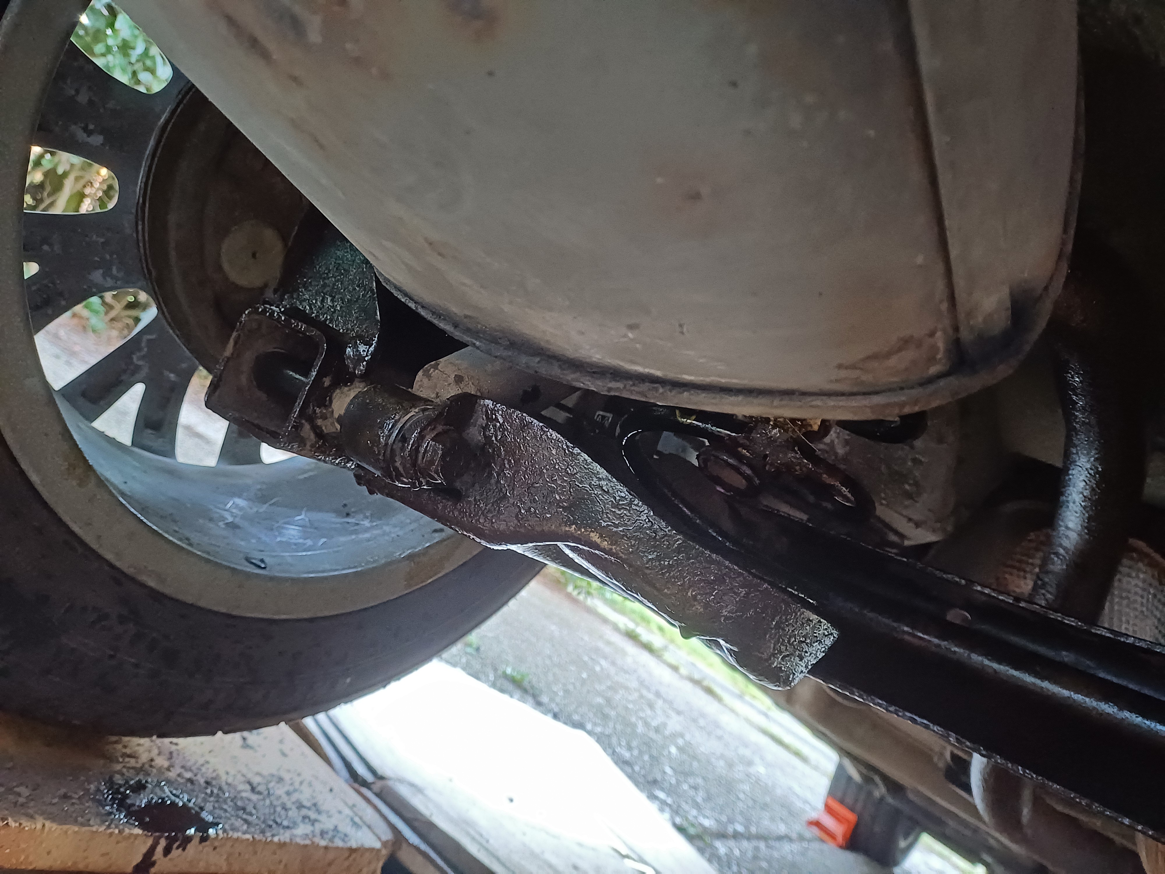

So finally got to this today. I didn't get as much off as hoped, as I wasn't up to it, and the cold sucked, but thought I'd share what I did! I wouldn't have known to do this without all of you, so thankyou so much. Even tho it's not perfect, it's better than nothing.
Next time I will take the wheels off, and do it a bit more properly. I now have more confidence with touching things on bubbles.
I used a mix of white spirit and oil on the axle thing, but the spray didn't work, only did jet, so smeared it on in the end. The rest is more oil than mix. I will pour some more in the pans in a few days, when bubbles isn't raised.

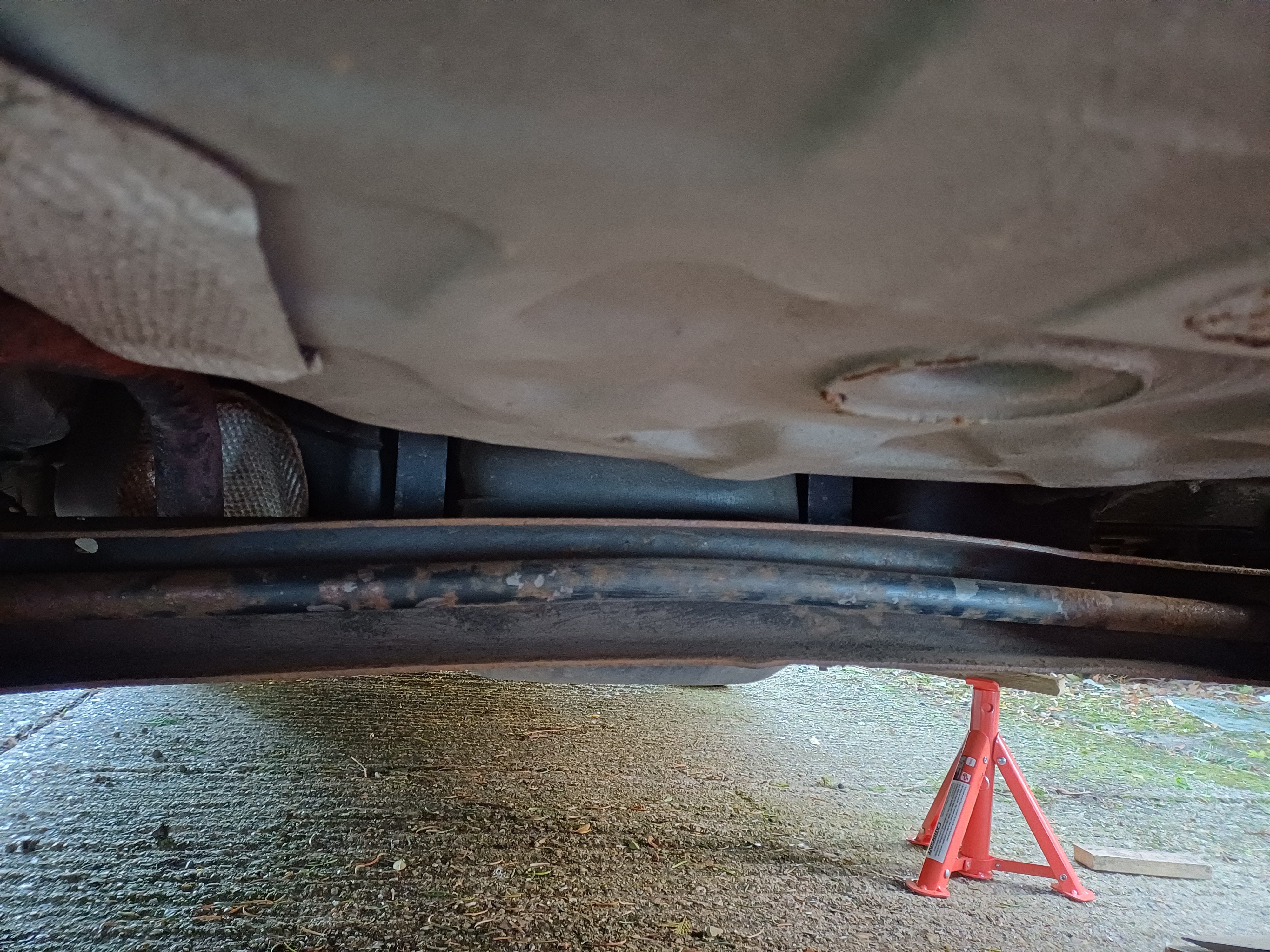

Also, idk what the last pic is, but it was suuuuper rusty. I only lightly went over it, as wasn't sure if I should touch it atall lol.
Thankyou all so much for all ure help, I will be back for more help, so brace ureselves. 🥰🥰🥰

You did well. Next time you'll be more experienced, and it'll be easier.
Seen far worse spring seats and crossbar than yours, - what you have done already should see you through the winter and come next spring /summer when its warmer armed with the experience from what you've done so far you could set aside a weekend get the wheels off and re-do it so your completely happy with over next winter!.
Give yourself credit for a good job- well done & dont beat yourself up about what you didn't do this time! its a positive that you didn't push yourself to do more when you weren't up to it! that kind of thinking leads to mistakes and accidents which your good sense /instincts avoided! -best result id say👍!
Good job:)
Yes, smear oil over that too, it's part of the rear axle.
Be sure to put protective sheets down when pouring oil into the spring pans, there are drain holes and oil will run out
Good job:)
