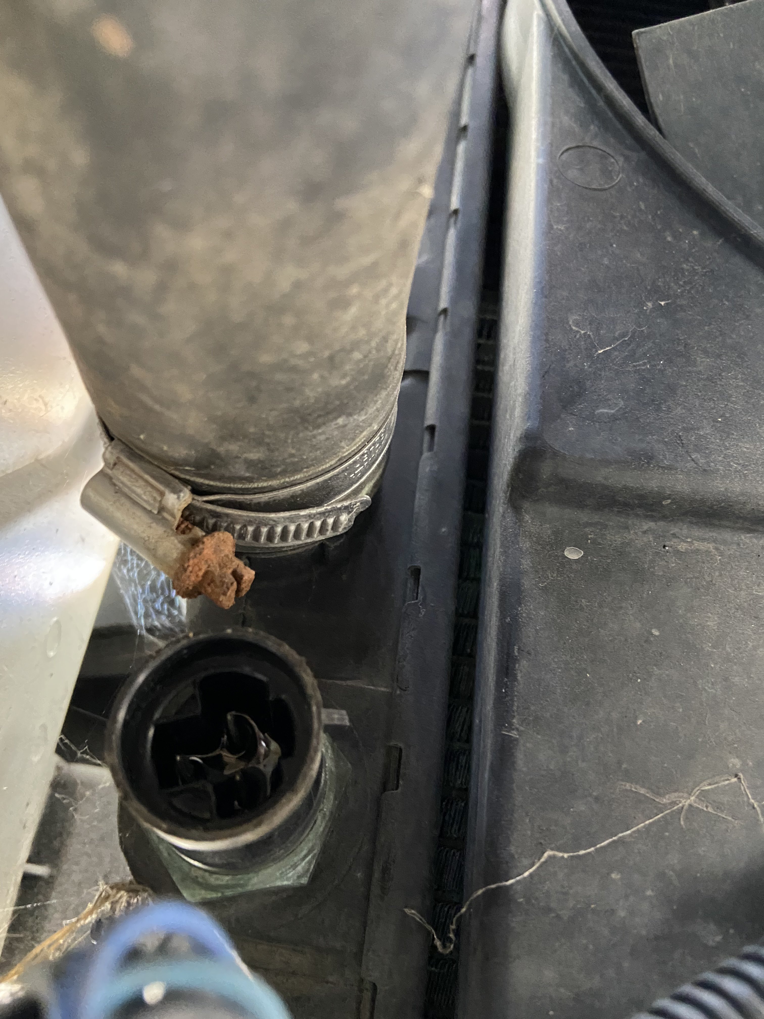

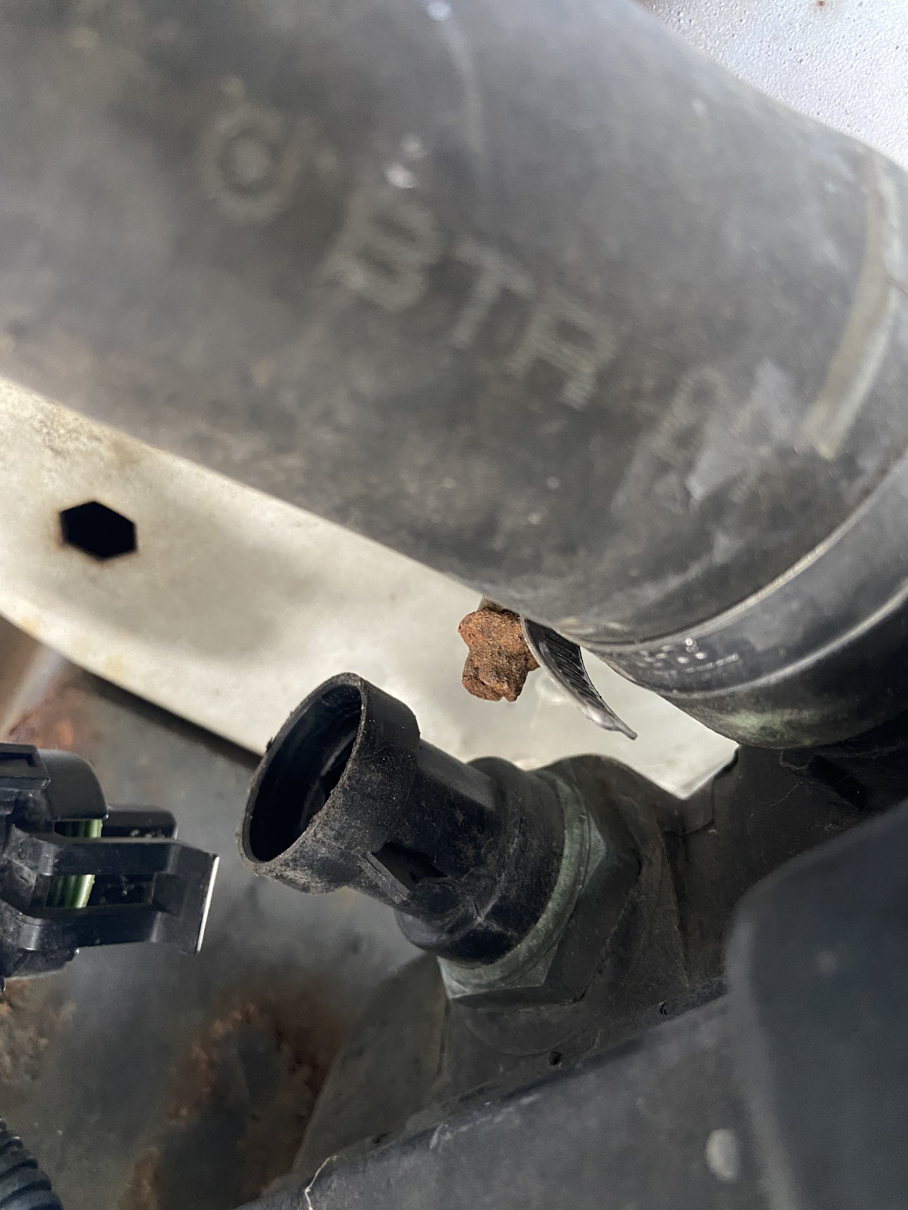

I have a 1.9l td ducato/boxer
I am struggling to find a replacement coolant sensor for radiator
It is on the ns of rad near bottom hose
It has 3 terminals and all the ones I can find have 2( as I would expect)
Any idea where I can get one
I assume this controls the fans
Thanks
