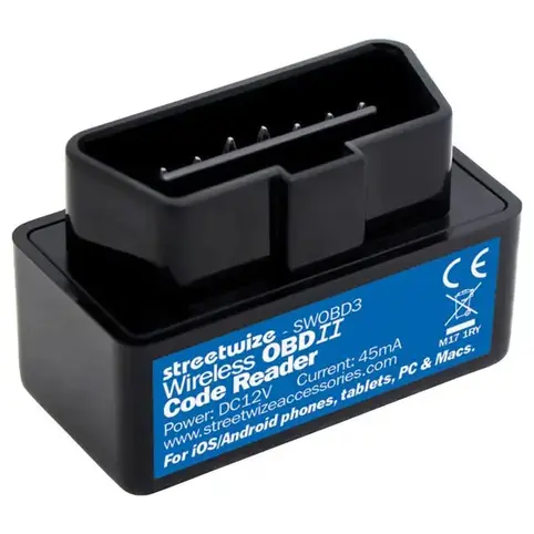

Sounds good. Do you have to have cables, or can you connect via a wireless OBDII Code reader View attachment 476090
like I can with google free car scanner app
Either. But to access all modules you will need an cable adapter as per the attached from https://www.multiecuscan.net/SupportedVehiclesList.aspx
I use a Vgate vLinker MS Bluetooth which enable access to all modules without any extra interfacing cables. I suggest you have a look at https://www.multiecuscan.net/

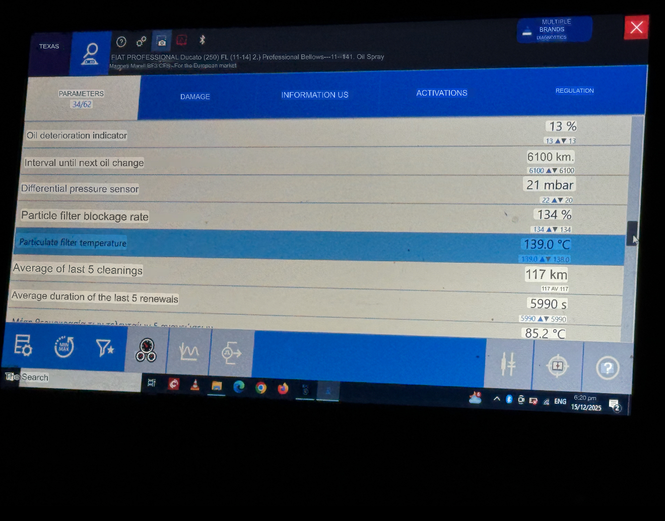

Hello, after disabling the ADBlue system and being able to drive for a few weeks, engine light is back on with the error code: P2002. It seems to indicate an issue with the DPF, but as you can on the picture attached, the pressure is actually low. How can a clogged DPF allows low pressure? We’re very worried of disabling or replacing the DPF, and that the problem would anyway come back

Check pipes to pressure sensor.
Have You replaced sensor with known good brand?
Is there soot in exhaust pipe?
Sensor brand is Bosch. Pipes were quickly checked by a former mechanic, no condensation nor fissures found. We haven’t checked thoroughly, nor if there was soot. We assumed that if the mechanic would have found something in the pipe, he would have said something
If there is soot in exhaust tail pipe the dpf may be cracked or damaged in another way allowing easy flow through dpf causing too low pressure reading, i do not know the parameters meaning too low pressure or even if it is too low.
Thank you for your response. Is there any way to confirm visually if DPF is cracked? We’re very worried to replace it, but still having the problem coming back (considering the high price of a new DPF)
Would be good idea to get fault code read with code reader that reads 6 digits after the P as it gives more information
I'm not sure that the P2002 is necessarily caused by the DPF being blocked or cracked. By the sound of it, it's about a successful regen being overdue, for reasons that may include DPF damage, but also other causes preventing regen.
Checking for a cracked DPF:
Wipe the tailpipe. If there's soot, the DPF has been cracked at some point in the past. If the history of the vehicle is unclear, you could wipe the tailpipe clean and check if the soot comes back after a few hundred kilometers.
A grossly cracked DPF will also show as abnormally low differential pressure under load, but I don't think a moderately cracked DPF can be easily distinguished based on pressure alone. At least I would have no idea where to set the threshold.
Checking for blockage:
Monitor the differential pressure at highway speeds. It should increase markedly over idle pressure but not exceed 100 to 150 mbar.
Again, blockage is not necessarily damage as it can also result from the regen not running on schedule. But if the regen does start and then fails with an error about the DPF, or fails to reduce the pressure to healthy values, and especially if the problem recurs shortly after a forced regen, that points to the DPF needing replacement. Note that the ECU will probably not attempt a regen while there are active error codes.

The car immediately went into limb mode when engine light came on, which means that we can’t go to highway speeds unfortunately
