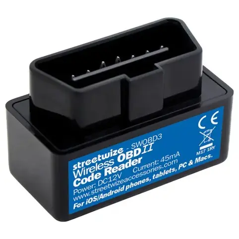

We bought an OBD reader to give us live data:
- No passive regeneration ever occurs, even on highways. Because of that, soot load increases steadily (around +40% in 1h30 of driving)
- As passive regen doesn’t work, ECU triggers an active regen as an emergency which works correctly and reduces soot load back to ~15%, confirming that the DPF itself is functional and not physically clogged.
- Exhaust Gas Temperature Sensor 1 (pre-DPF) is consistently lower than Sensor 2 (post-DPF) during normal driving, which is abnormal (it typically averages around 250–300°C, with short peaks around 350–380°C, which seems too low)
- ⁠The ECU keeps trying to launch a passive regen, but conditions are never validated
- During active regeneration, Sensor 2 becomes significantly hotter than Sensor 1, which is also abnormal
All this shows that the DPF is not the root cause; it regenerates successfully when forced. The system is effectively operating in “emergency mode”, allowing soot to rise to 100% before forcing active regeneration.
There seem to be a structural thermal issue upstream of the DPF preventing normal passive regeneration.
What do you think?
