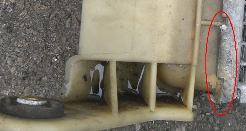

But the fact you can't see any leak then most likely it's in the same location as I experienced with my radiator leak, where the metal meets the plastic at the bottom of the radiator
Bottom left hand side
Of course, it's hot down there near the radiator, a small leak evaporates real fast and any drips fall into the lower radiator securing panel. It also only tended to leak when the radiator was at a certain temperature so it was real fun to catch leaking

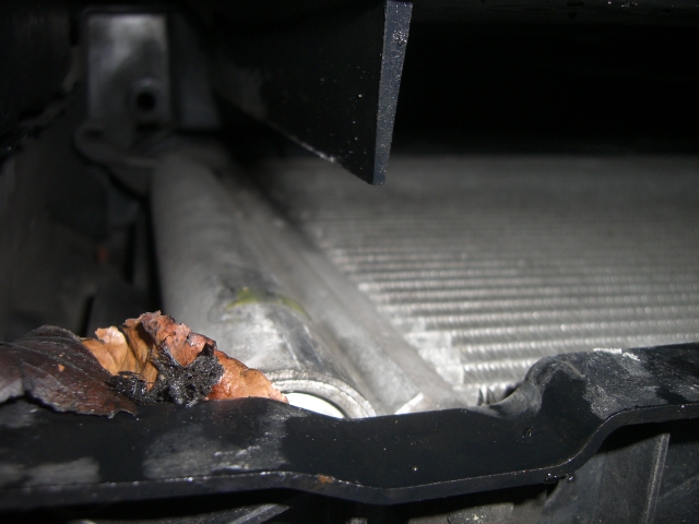

Anyway, I've taken some photos while I was looking for the A/C leak. There are some deposits around the filler cap. Might this be it???
While looking with the UV-light it was actually easier to spot differences (even without dye) and there was some dark areas on the radiator here. This shows the right side of it (left side when looking down the engine bay).
Right on top it is a butterfly valve like screw. I was able to tighten it about 75°, but it felt hard where it was - and I have never touched that before.
The butterfly valve is the radiator air bleed so a leak there would cause your symptoms and the leak would drop coolant just below there
