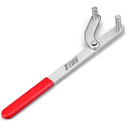

Thank you again Ralf.
about the fuel pump, the problem is that i don't have any space to work on it, the pump is tucked in inside a black, metal structural frame of some sort, in which it also bolts on, so my access to any bolt or seal in the pump is pretty much impossible. piping wise all connections are leak free so my guess is almost 100% on a dodgy seal.
I saw a video the other day about changing the timing on this engine and they also had that 6 o'clock cut-out and they warned about it being deceiving and having nothing to do with the alignment of the engine, so i guess that checks out and everything i saw checks out with everything you said 🙌🙌
But i wasn't aware that not-OEM belts could not line up with the marks and that left me worried. If that happened, how would i know if i leave too much slack on the belt between pulleys or if i leave it too tight, what i mean is if i leave it one tooth short (leaving the tooth matching the white line behind the pulley mark) the belt might stay loose between the camshaft and the crankshaft pulleys...Am thinking this straight or am i making a problem that does not exist? 🤔
Unfortunately i would love to also change the water pump because my car ran, somewhere in the past, without antifreeze (only WATER🤬) for some time which rusted a bit the inside walls of the engine, fortunately not much because i can only observe light brown coloring and no flaking.
i know for a fact the belt has been changed when i bought the car but i'm not too sure about the water pump so i must replace it too. Could i possibly use this tool in the attached picture to secure the pulley while unscrewing the bolt? That tooth tool doesn't seen to lock the pulley too firmly.

Yes.. I had a look at my pump.. it looks like you can't do much with it it situ except unplug the plastic hoses.
You don't need to worry about the belt marks. The camshaft pulley is lined up with the pointer on the cam cover, and the crank is locked.
The other pulley (on the fuel pump) rotates freely, it's not connected or timed relative to the camshaft... so if the belt between the pulleys is slack, the tensioner will pull it tight. The pump pulley spins/moves very easily... you can almost forget about it, as long as the belt is on the pulley.
That tool looks like it will do the job. When I do mine, I use a combination of the little pointer tool and occasionally I used a screwdriver through the pulley, to help keep the force off the pointer tool. I found the bolt where it attaches is slightly stripped and won't take too much tightening.. which probably led to the pulley locating dowel being damaged. Anything that stops the pulley rotating will do, as long as the valves don't move onto the piston.. they probably don't want to support the force of the pulley bolt being undone.
