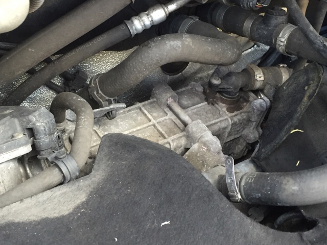

Guys anyone know if there's just a seal that can be replaced here?
On the heat exchanger, dealers say it's a new heat exchanger £500 plus similar ££ in labour!
ImageUploadedByFIAT Forum1455805805.611273.jpgImageUploadedByFIAT Forum1455805819.599355.jpg
ok so the connector pipe only comes part of the exchanger! but it obviously comes off the exchanger, the question is still ( as i don't fancy remove it without knowing, is there a way of repairing and or seal (O Ring) replacement
any ideas or help will be appreciated

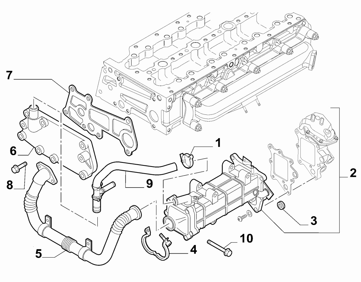

picture of Heat Exchanger
Neil. That pipe/connector looks plastic in the picture and the leak dosn't look to bad but my guess is that there is an o-ring on the tube and I would probably take it out and try some silicon grease on it.
Even if you sealed it with something stronger like a 2 part adhesive and it still leaks no harm done as you will have to replace it all anyway.
Do you have an assortment of o-rings on hand just in case.
Mike
