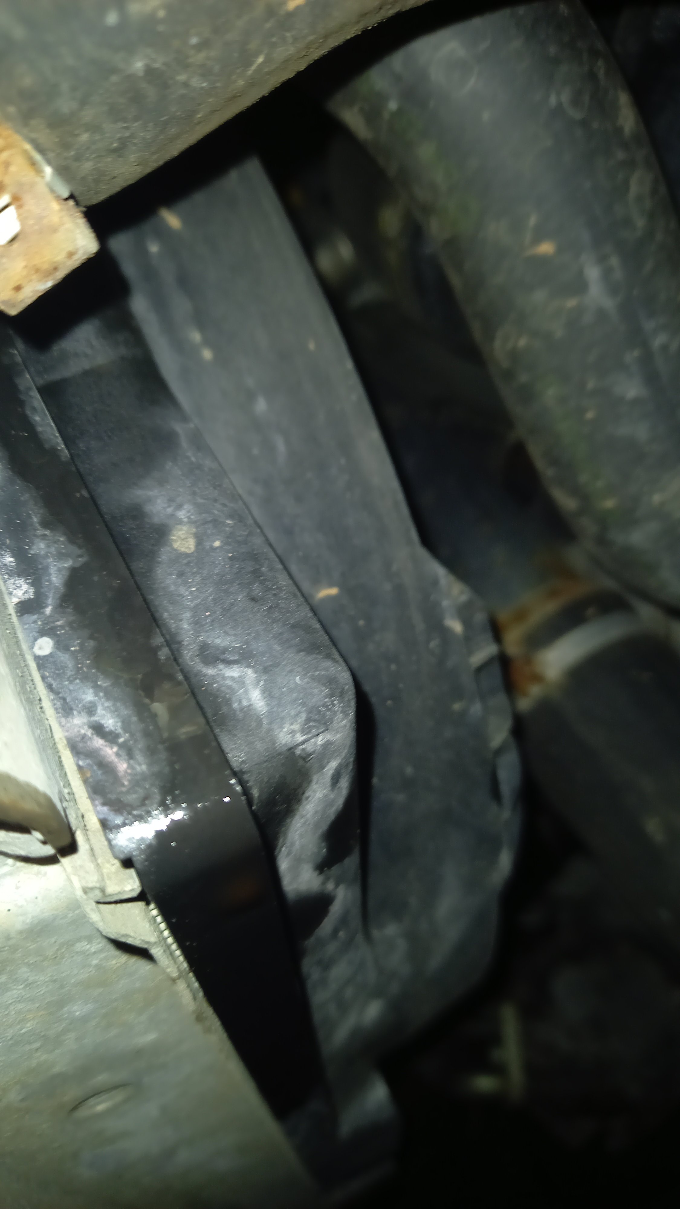

Have a slight slow drip from bottom right of radiator on ducato motorhome 2013 130 multijet.
Coolant runs down side of rad from part way up.
One image shows some kind of clip/mounting on side of rad. Seems to be where water may be coming from. Any ideas on how to fix? Or a new radiator?

Two points, if the you are sure it is coming out around the area in the first photo, then to me that looks like the metal crimping arrangement that holds the plastic end tanks with the inlet and outlet pipes on to the aluminium core of the radiator, there is a rubber sealing mat/sheet between the two pieces, but for all intents and purposes if water/coolant is leaking there then a new radiator is required.
The other point is double check the water isn't coming down from the plastic hose clipping arrangement as the clip below it looks rusty as though water has been dripping down onto it for some time.
Once the release clip is pulled the hose with it's plastic end comes out to reveal an O ring rubber seal, incidentally when/if you fit the new radiator disturbing those O ring seals may cause another leak!

Thats very helpful info. Thank you. The vehicle has only done 44k so would hope it doesnt need a new rad. Getting it checked out over the next few days.
