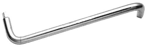

Sorry no pics! Was too busy to crawl under the car last week. Today I finally got the special key for the drain plug: It has square edges. The old fluid probably never got changed :( (130K km) was dark grey and cloudy... yuck :yuck:.
The new fluid I got in through the breather vent on top of the gearbox, drove around the block - looks ok! Thanks for all the advice and tips!

Link? just a random pic of the one I got. Purchased mine from local metallurgy factory (Israel) Its 8mm x 10mm square drive
