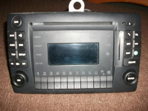

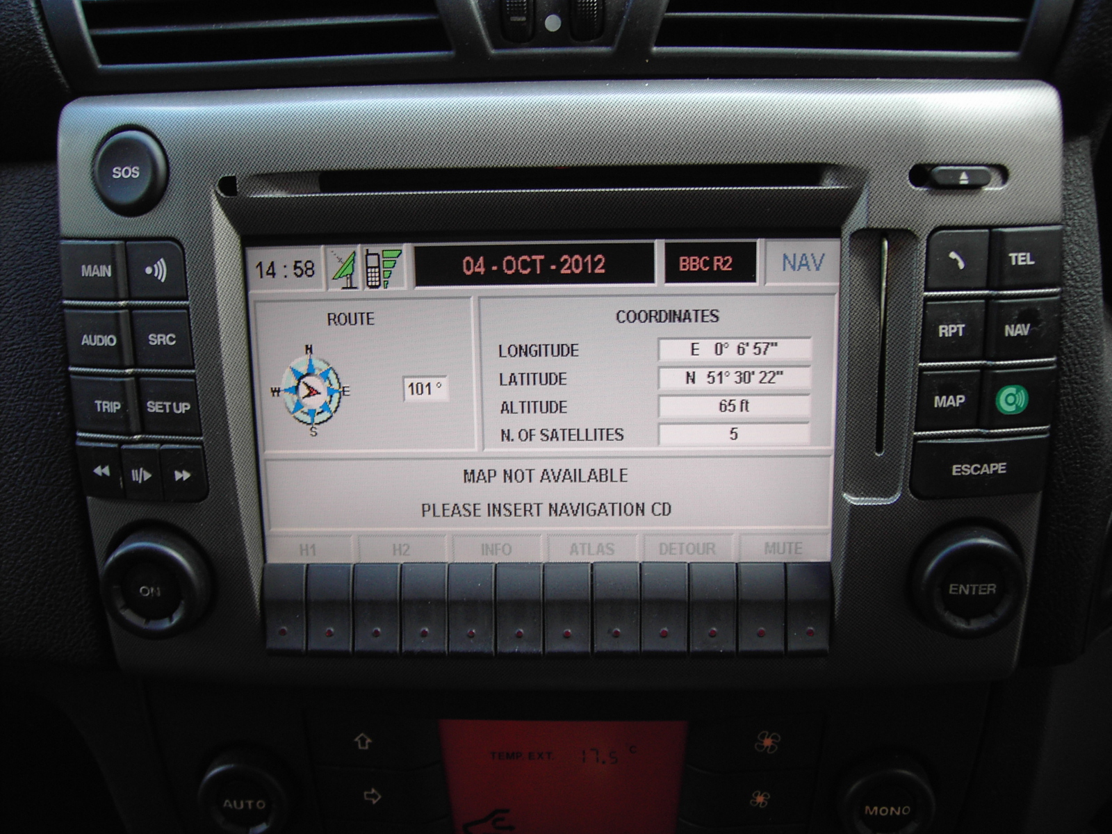

The first picture below is a Connect Nav. Second picture is a Connect Nav+
