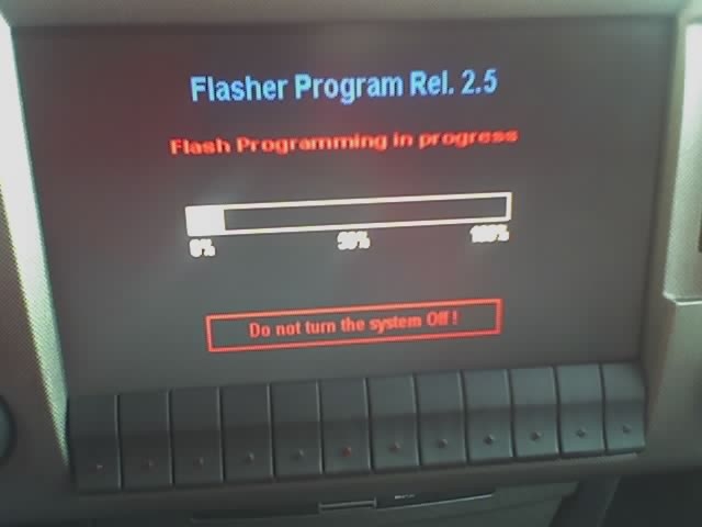

A few days ago I tried to update my connect nav+ (fiat stilo, year 2001), that had the release 5.2, to the 9.8 version!! During the process, around 10%, the connect shut down and the CD didn't eject.
I ejected the CD by a screwdriver. Now the connect is noir and it doesn't work any more...
How can I reset the system or I can find a solution?
Please help me...

re: Connect NAV+ 9.8 Update CD & Setup CD
Did you use a poor quality CD?
If you did, use a decent CD and read the guide on how to burn it properly, and then try again :).

I think the CD was ok but the only possibly problem can be that I burned the CD with disc-at-once and not with disc-at-once/96 because it isn't it in my version of nero (7 premium). Does you think that could be this the problem?

Maybe, the first section of the process is to read the disc and ensure the program is correct, then it erases the old eeprom (this is the bit where it sticks at 50%), then it writes the new eeprom.

Hello all!!
I have resolved my problem!!
In practice there is a combination to decontrol the navigator: when you insert the upgrade disc you must press the bottons "3,4,5,6,tel" and your navigator flashes for one or two times; you must wait; if the upgrade doesn't start you must shut down the navigator, wait a few second, restart it and try again with the combination... You do so until when the upgrade start. When the upgarade start you must turn the right small wheel to the right and to the left during the whole installation and you will see that the installation ends with success!!! At the end you must change the language with setup CD, but this isn't a problem, you must follow the only procedure of the instructions.
I recommend to the admistrators of this forum to publish this solution on the page of the instructions for the upgrade 9.8!!
ATTENTION: This is a procedure that it must have done only from who has the navigator that extinguishes during the upgrade!!
