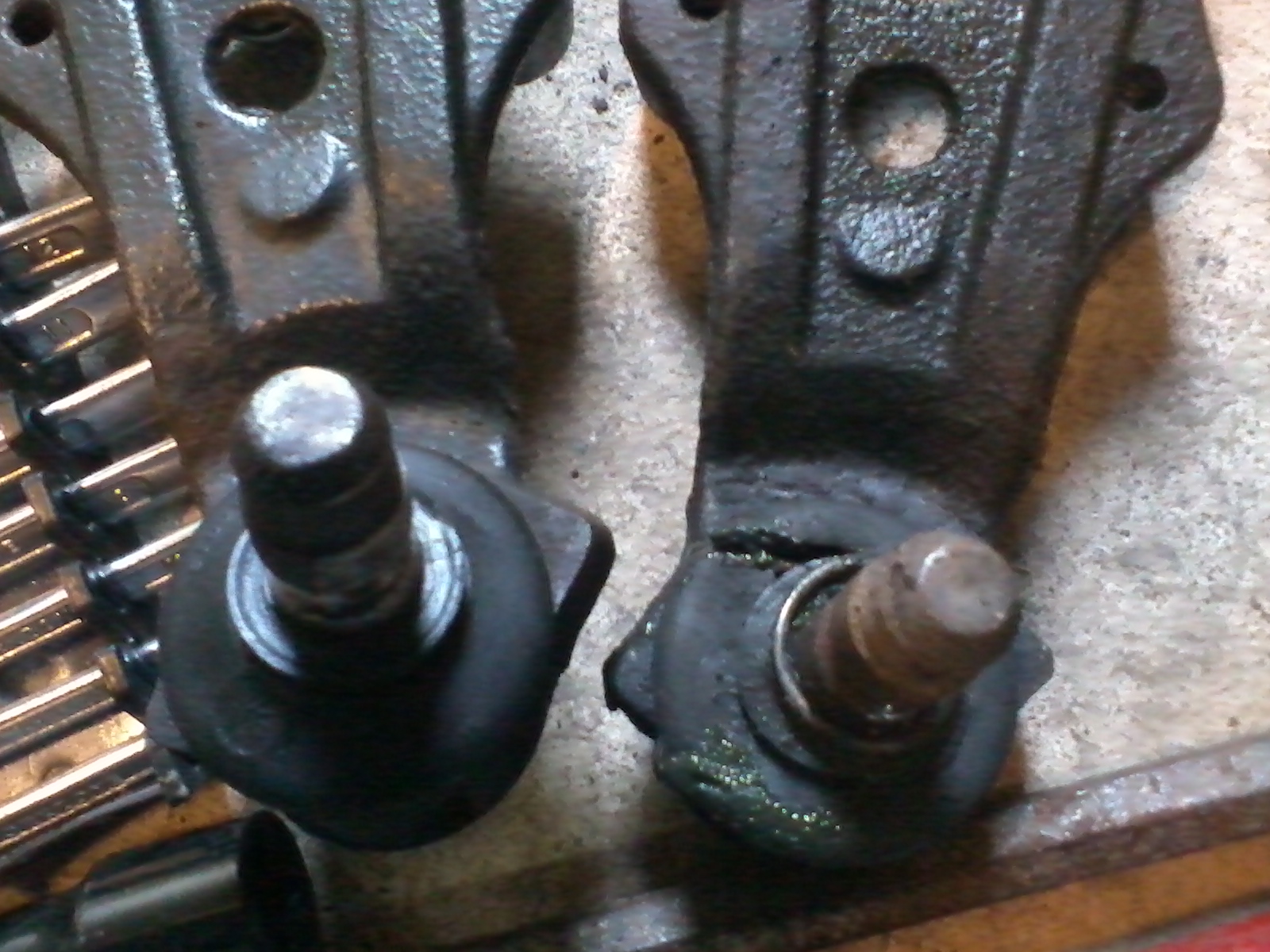

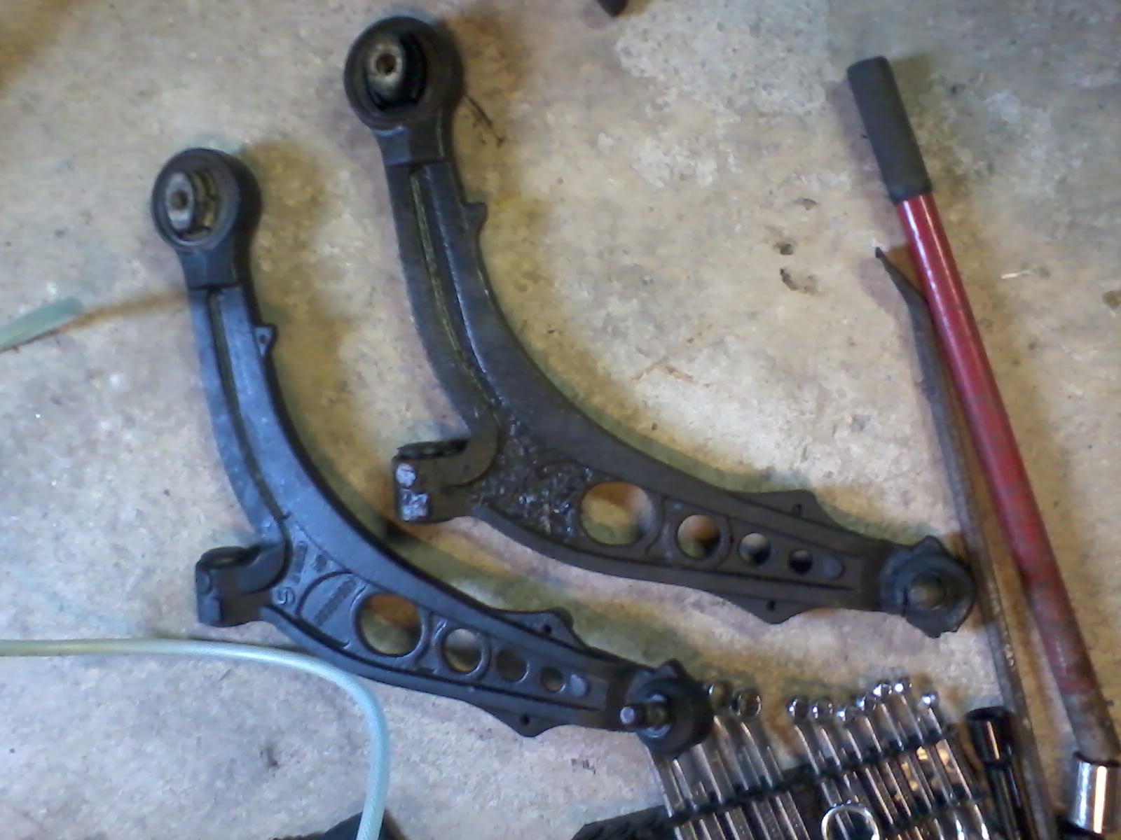

Those covers where transfered from old shocks to new ones when I was doing the lowering, the only thing I can see that doing is folding up to much, kinda kinks when its compressed and doesnt return to normal lenght...
Jacked up the passenger side there this afternoon, would the ball joint on the wishbone count as a dust cover? The rubber on it is cracked, cant seem to find just the ball joint on shop4parts, only complete arm
Picked up a complete wishbone in scrapyard, all bushens in good condition and dust cover intact on ball joint.
New part was coming in at €65, picked this one up for €20.
Fitted it this morning, wasnt too hard to do...
Gave it a quick clean with wirebrush
The split cover on the old one..
Much easier when you've the proper tools!

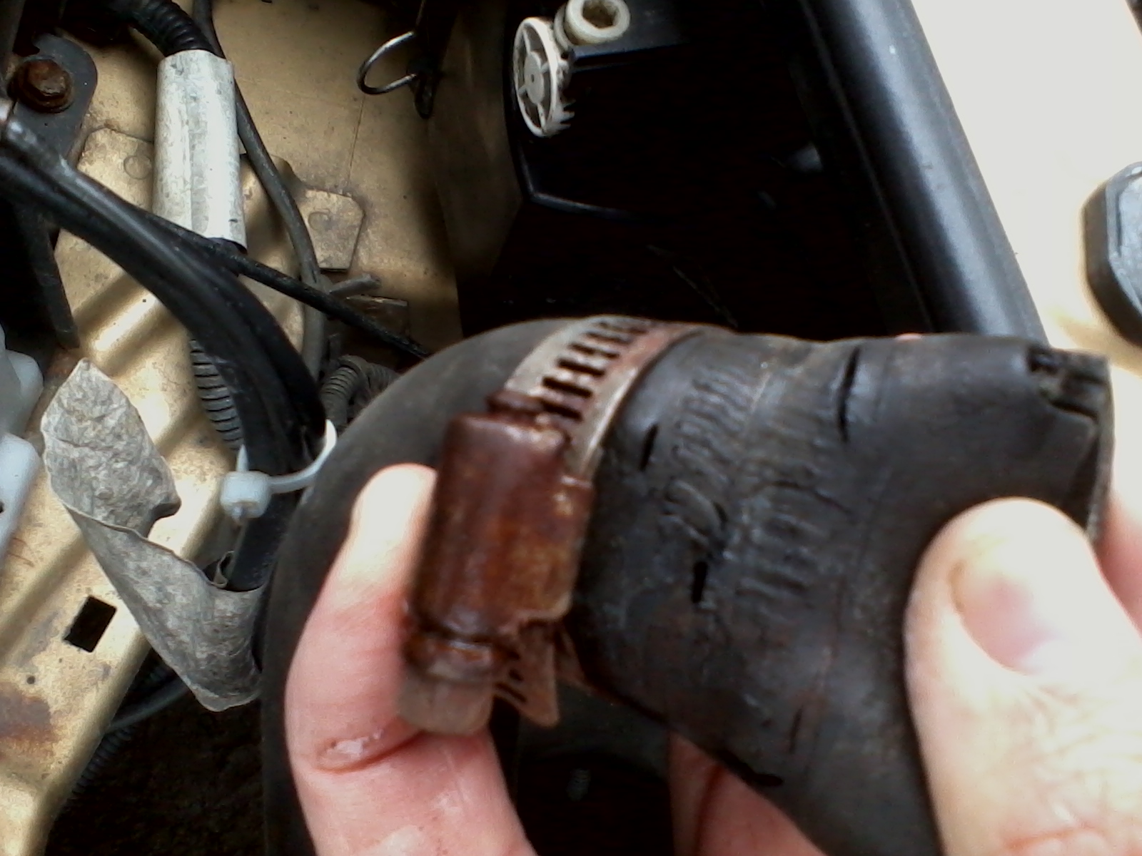

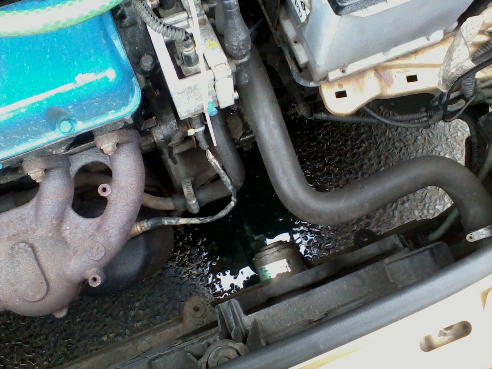

Then this happened this morning.
Only noticed it as I came back up the motorway, after driving 20~ miles. Was coming across a back road, had to stop as a low loader was loading a digger and dumper.
Seen a small bit of steam coming from under bonnet, didnt have engine idling as i knew it was gonna take a while for them to get loaded.
Popped bonnet and see a pool of coolant on road, pushed a few pipes then noticed the leak at the thermostat, just around the jubilee clip.
Had to get a tow for about 500m to my uncles shed, got the clip off, seen the cut in the pipe so just cut the bad piece off, reattached it and filled the coolant to get me going again.
Have priced a pipe at £22 from fiat so may need to invest in it soon.

my bodge job on the coolant pipe lasted exactly 1 week, thankfully the part came in this morning so its on now with new jubilee clips, topped up and bled.
I think the pipe that fail was the original pipe, so 12 years old and it would have been on and off a few times in the past 12/15months with the engine change and then the thermostat change.
