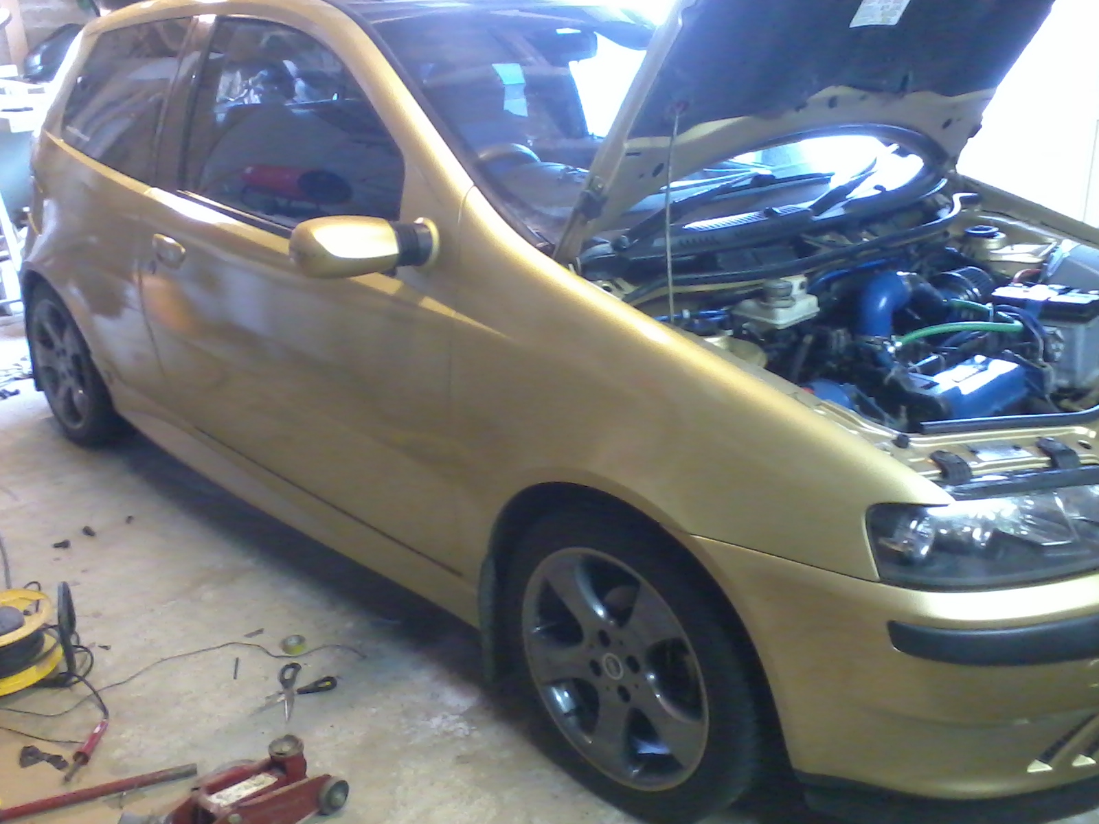

Its not that great, needs claying as its rough in places from overspray, then a few runs. But for a small 24 litre tank and a cheap spray gun + my inexpeirence, I cant really expect a professional body shop finish. Not worth spending thousands on a pro paint job when car would only sell for €500...
Im happy enough with it, just wanna get it back on the road now.

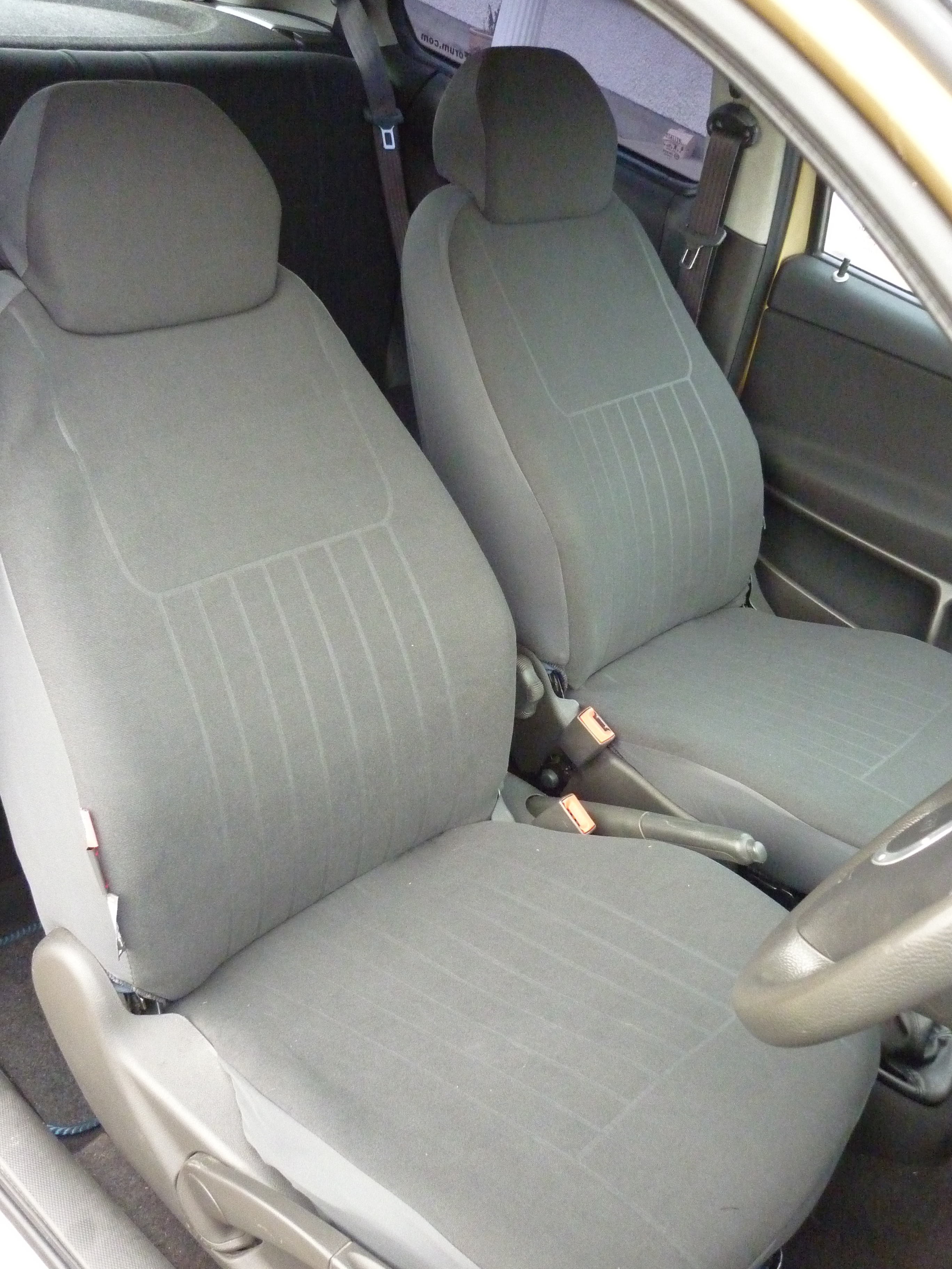

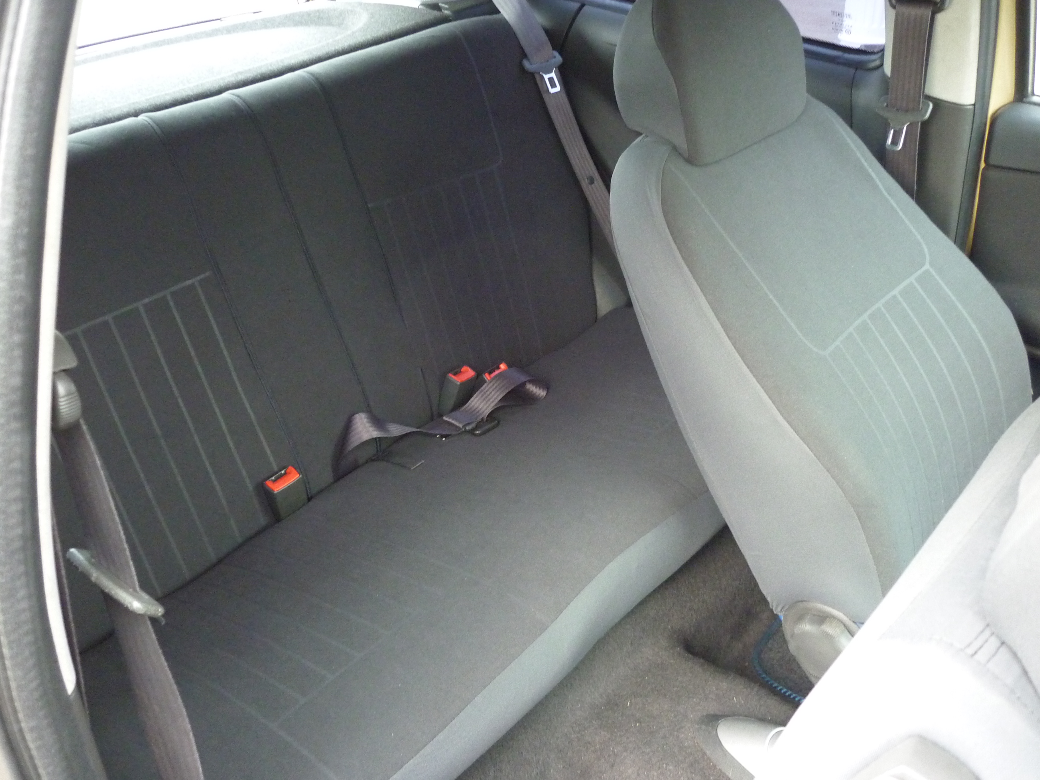

Got a set of car seats, rather than spending money on an 147 interior, picked up a set of black/dark grey covers to match the door cards. Weren't to hard to fit, just took a bit of time getting them all fitted nicely.
Bit short on the back of the seats, but cant really notice it too much.
