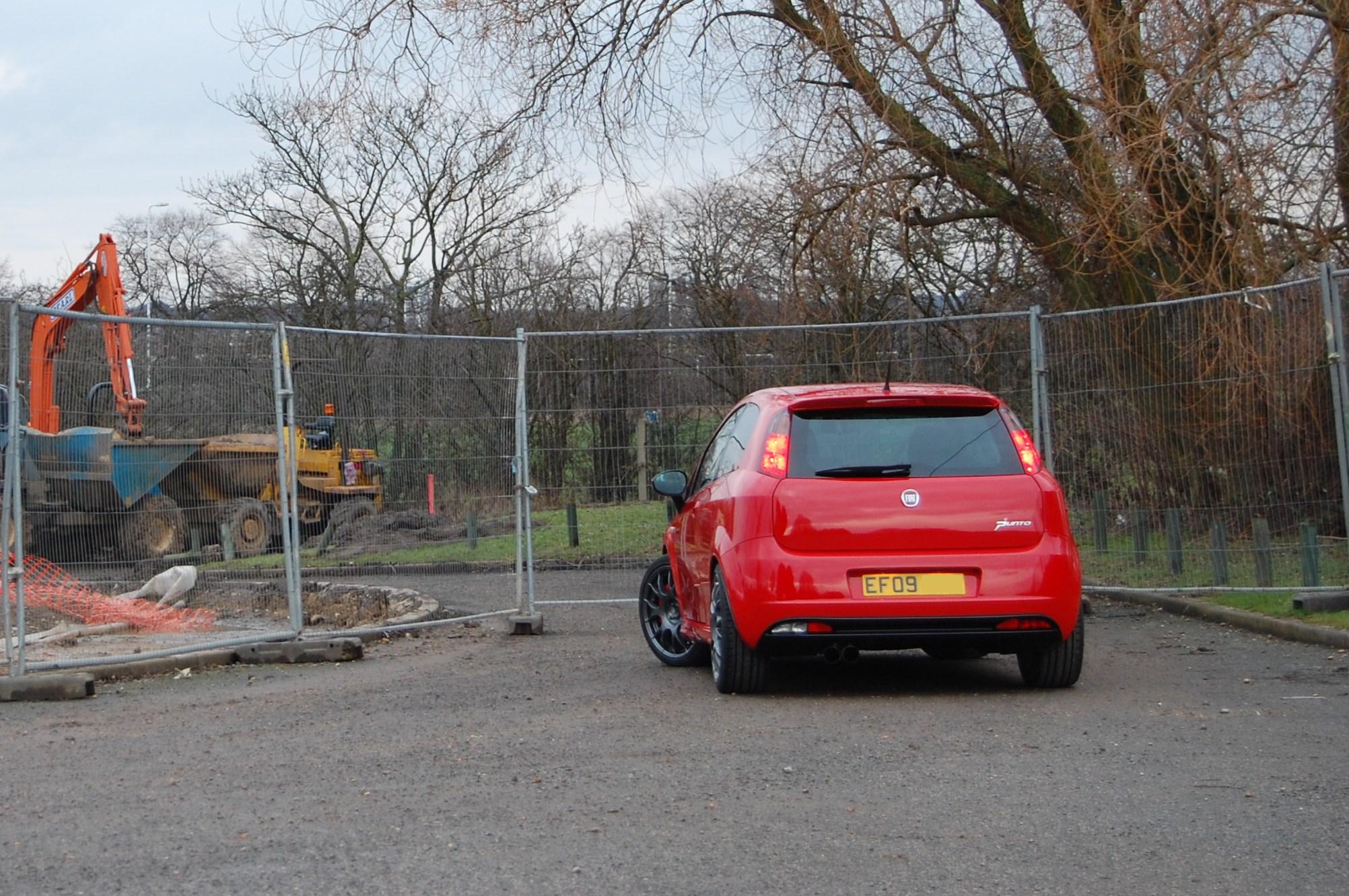

Well, the ten week wait was certainly worth it :D. Coming from the Seicento this thing feels like a Roller or something hehe, though I find the seats give me a backache after a few hours of motorway driving.
Optional sub was well worth it - you're not going to get real deep bass from it (for you audiophiles) but for what I need it for it's perfect.
Has an annoying rattle when going over bumps, coming from behind me...need to look into that one.
But on the whole, love it. Here's a few pics to get the ball rolling, though if you've seen one you've seen them all...

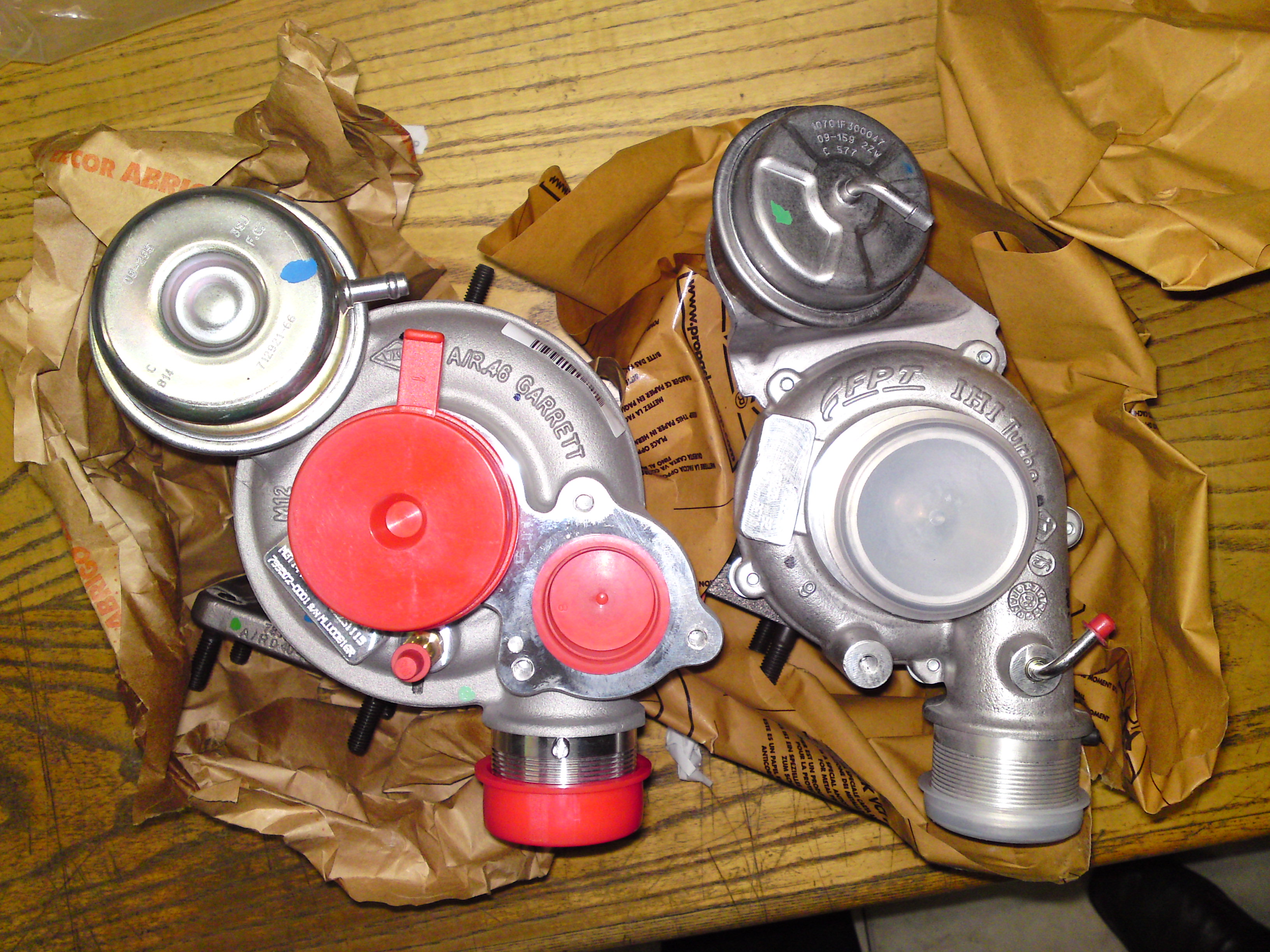

Turbo is a small Garrett they retail at about £200 in the USA, but yes slightly bigger than T-jet turbo.
Forgot to add, the Garrett turbo on these cars is pretty small.
Said so in the first post :D. BTW I haven't said anywhere that the SS turbo is particularly large; it is in relation to the T-Jet unit. Should we be worried for the longevity of the T-Jet guys knocking on the door of SS power?
I imagine the evo turbo is pretty large, but isn't this more a function of having to fill an extra 600cc (have to excuse my evo knowledge...I think they're 2-litre)?

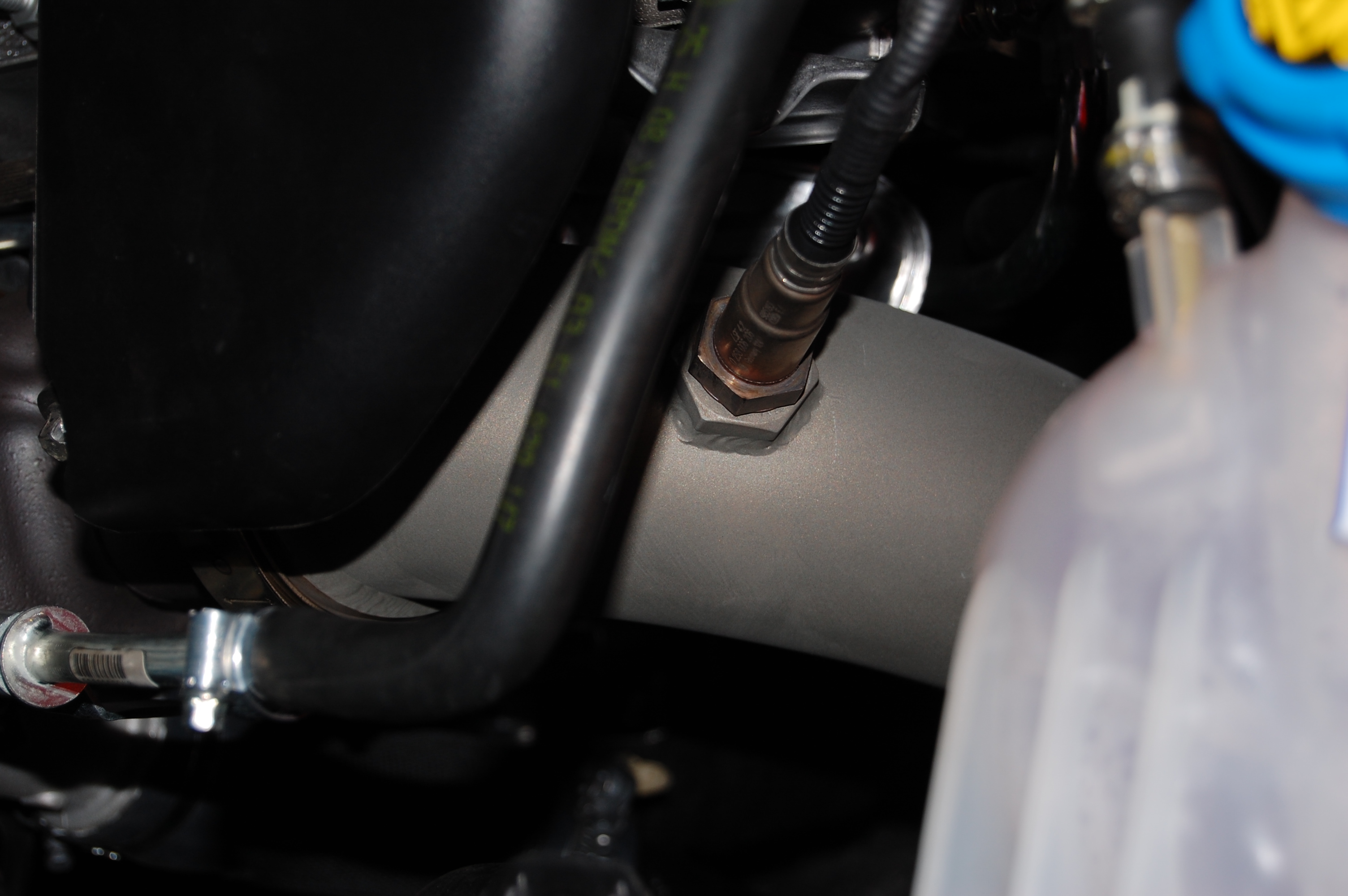

The engine cover is in the way partly so I can't get decent pics, but I can say that Hayward and Scott have done a very impressive job.
I'll get some better pics once the car's been cleaned and the engine cover comes off.

With the original T-Jet map the car ran c. 195bhp and c. 240 ft-lb torque. IIRC the peak boost was 21psi. Fuelling was OK (so all my slow driving was actually not needed :D). When we revised the map the car boosted to 26psi (too much) - the ECU logged an error code and stopped the car from boosting above 15psi after that. The code reader thingymajig was out on loan so all we could do was call it a day.
However, when I got home my mate said he happened to have just such a thingymajig and after clearing the code the car was back to it's usual self. Shame it's not at Red Dot anymore so the mapping refining will have to wait until next week or so.
Can say that 195bhp is quite pokey though :yum:
On my way back from Northampton I passed by at Tony's and had a look at the graphs and we discussed the situation. There is quite a bit more power left in the set-up. The problem seems to be in the T-Jet ECU.

You have got it back to front. The larger engine fills the lungs of the larger turbo quicker meaning it spools up quicker, hence most smaller capacity cars use smaller turbos so to avoid lag. But a bigger turbo works less hard and therefore produces a cooler charge and can maintain a higher level of boost longer as cooler charge means less chance of detonation. So when you want to get consistent and reliable power you need a bigger turbo working less hard, but you get the lag. This is why things like the FQ400 EVO has lots of lag compared to a standard FQ 260 as to make & maintain the higher power reliably it uses a much bigger turbo.
What was the power output at the wheels as I assume the 195bhp quoted is a calculated flywheel power?
I would look at the compressor map for the turbo as you are running 21psi, thats 1.5bar of boost. Owen Developments use a roller bearing turbo on there Punto GT conversions which means it is a minimum of a GT25 to get 230bhp, I guess that the Garrett turbo you have (I can check when I'm in workshop as have Abarth data for Trofeo series) will be something around GT15/17.
