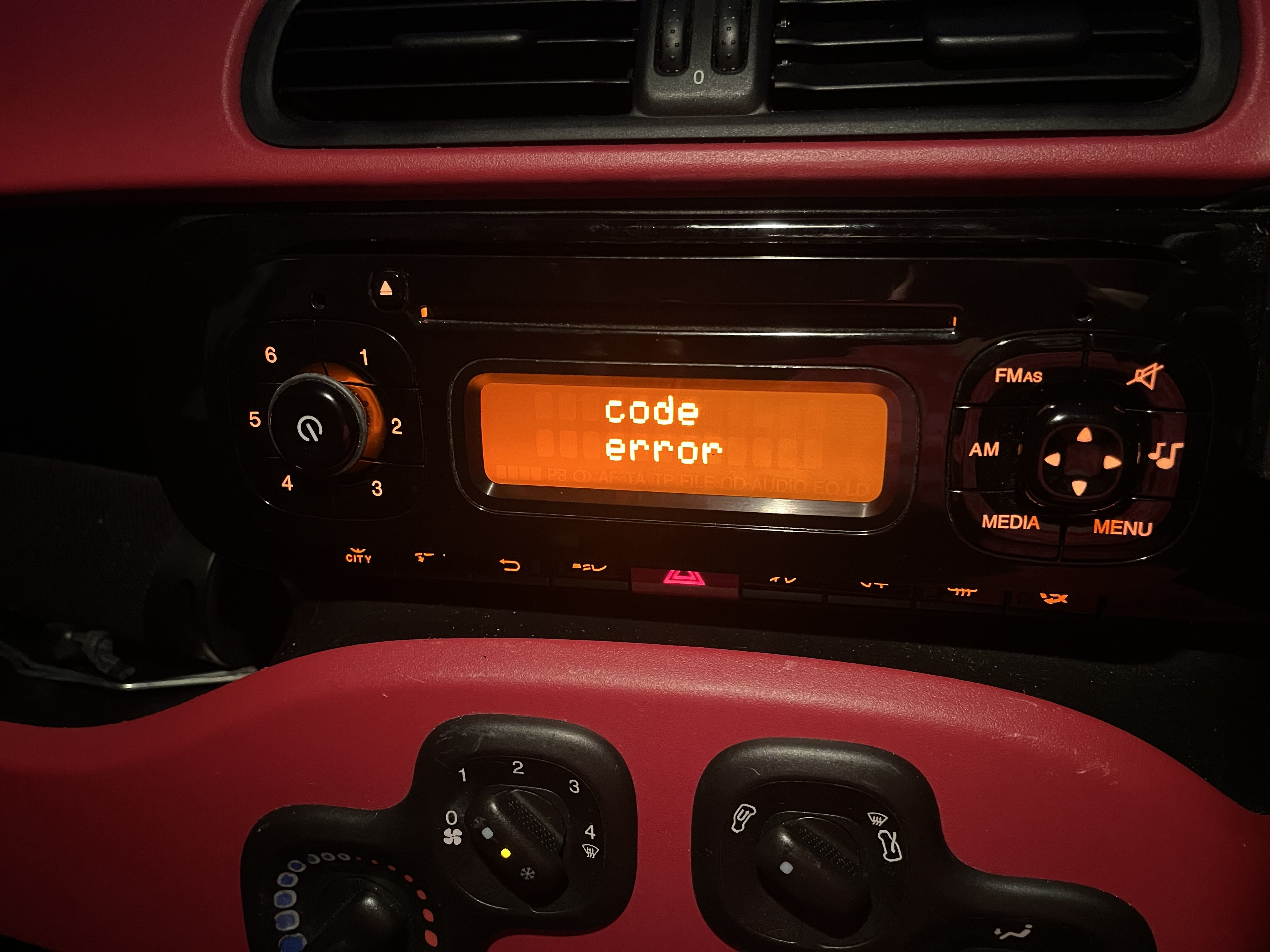

I’m putting the original Blaupunk stereo back into my panda (took it out and had Pioneer for a while) it said “code error” I’ve tried disconnecting the battery but it’s still the same. Any advice please?

I have the stereo code but nothing but error code odd displayed giving no option to enter the code. It’s does nothing at all.

It didn’t even get to the point where a code can be entered. I switch it on it says Fiat and then code error nothing else, no option or way to enter the code at all, no buttons do anything, nothing is operational.

Thanks, have tried this without success I’m afraid. The stereo has been back in the car connected for a week now and it’s still not operational. I’m at a loss, it’s very confusing as it worked fully before removing it to replace with a Bluetooth pioneer, they want great, hence trying to put the original back in.

It don’t get to the point where I can enter the code, I have the right code from my Fiat handbook but no buttons work so I can’t even enter it, it’s totally inoperable.

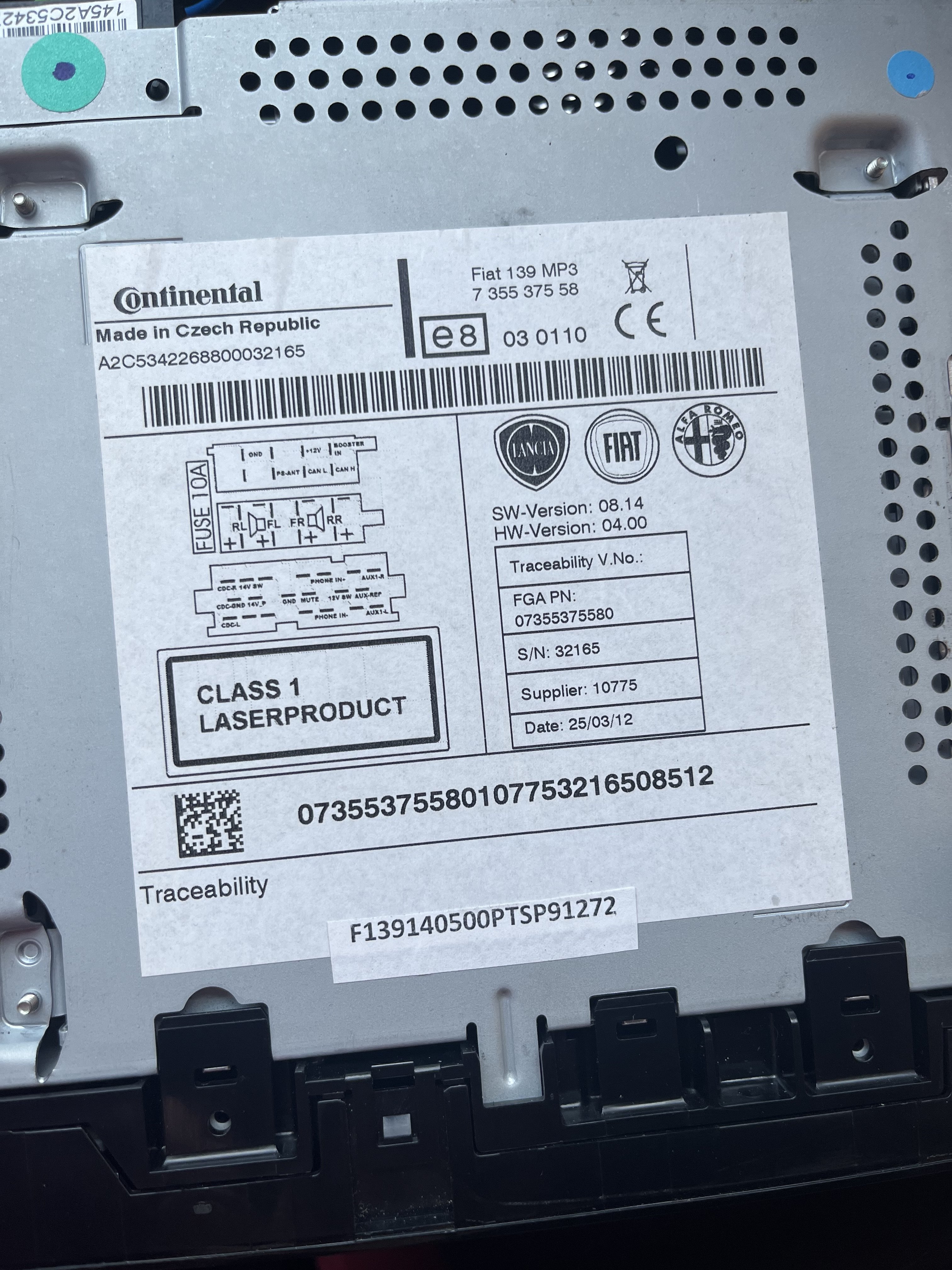

What model and age is your Panda? Those with Blue&ME or the later uConnect radios don't have a radio code as such. Instead there are linked to the car's main control computer (the Body Control Module or BCM) which cross-references the chassis number of the car and the serial number of the radio that was installed at the factory. Are you putting back in the exact factory-fitted radio that was previously removed, or another that looks the same? if the latter, that will not work.
Edit:
Looking again - you say it's a Blaupunkt radio you're putting back in. That is unlikely to the the Fiat factory-fit radio (as, so far as I know) the originals were not made by Blaupunkt (they're often labelled 'Continental', as in the tyre company, on a sticker on the top of the metal case, but no brand shown on the front). Can you post a photo of the radio you are putting back in?
With a non-original radio, most older ones use a code to lock them. If you put the wrong code in a couple of times it will 'lock out' for, initially, a minute before you can try again. then for two, five, 30 minutes etc, up to a max of 48 hrs... maybe thats why you can't enter a code? (It remembers these even if the power is disconnected, so unplugging won't help)
