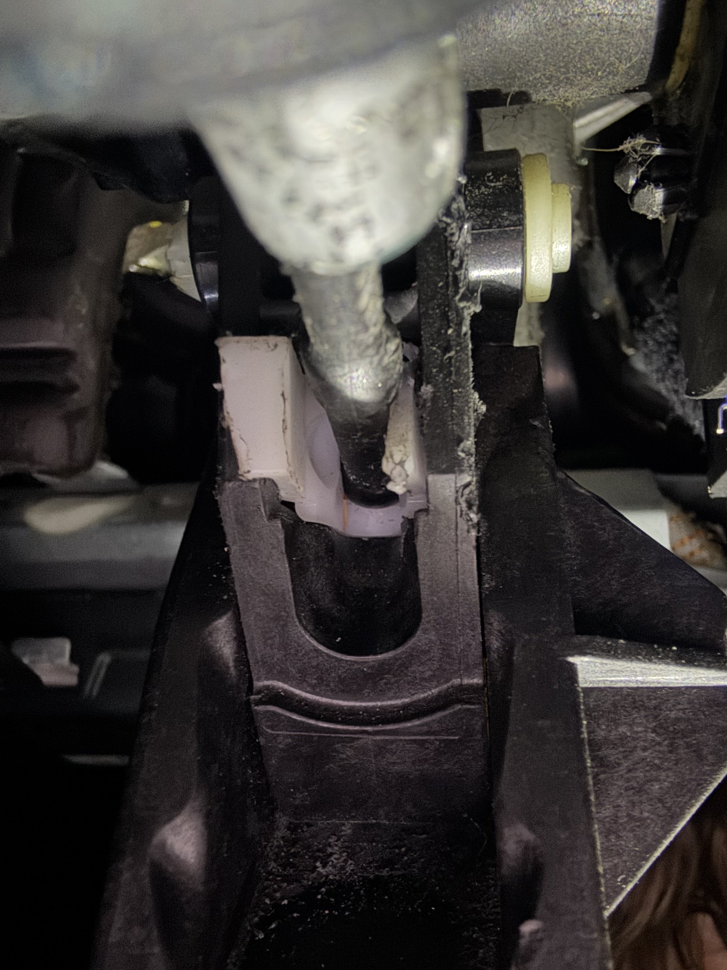

Latest update. This job is an undertaking lol. Everything up to taking the pedal assembly out is easy enough. Tried to do it without taking the assembly out, but that clip on the cylinder is a $“?!. So took the pedal assembly off finally. To do that, you have to drop the entire steering column to get to the top bolt on the intermediate shaft. After a few hours today I finally managed that. Got the clip out in a minute after getting the whole assembly out. Got the steering put back together and pedals hung and decided to call it a day today. Back at it again tomorrow.
