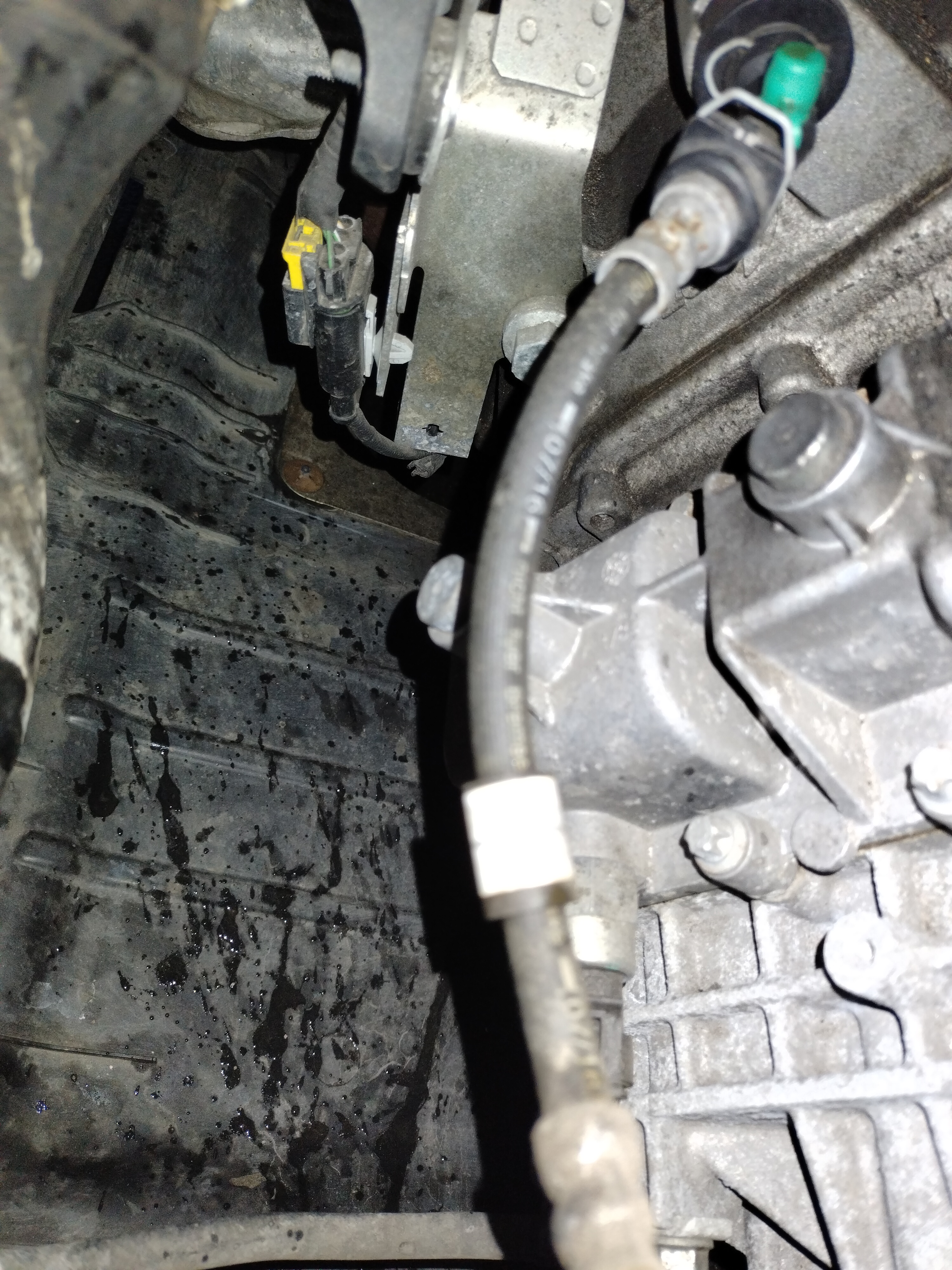

changed the brake and clutch fluid today it apperes ive got some air in the clutch circuit as the pedal is about a inch lower then it used to be still changes gear fine however
dont seem to be able to get the air how run around 700 ml fluid through the circuit using a hand vaccum bleeder get nothing but tiny bubbles probbaly such in around the pipe where it connects to the nipple on the slave
any tips to get it out?
i think ive made a small improvemnt by pushing the slace cylinder push ram in/backwards while bleeding its too dark now to tell ill go for DRIVE IN THE MORNING AND WILL SEE

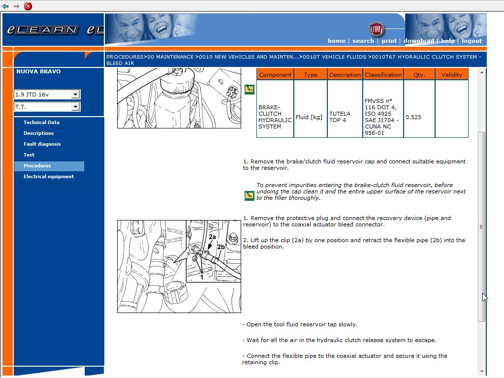

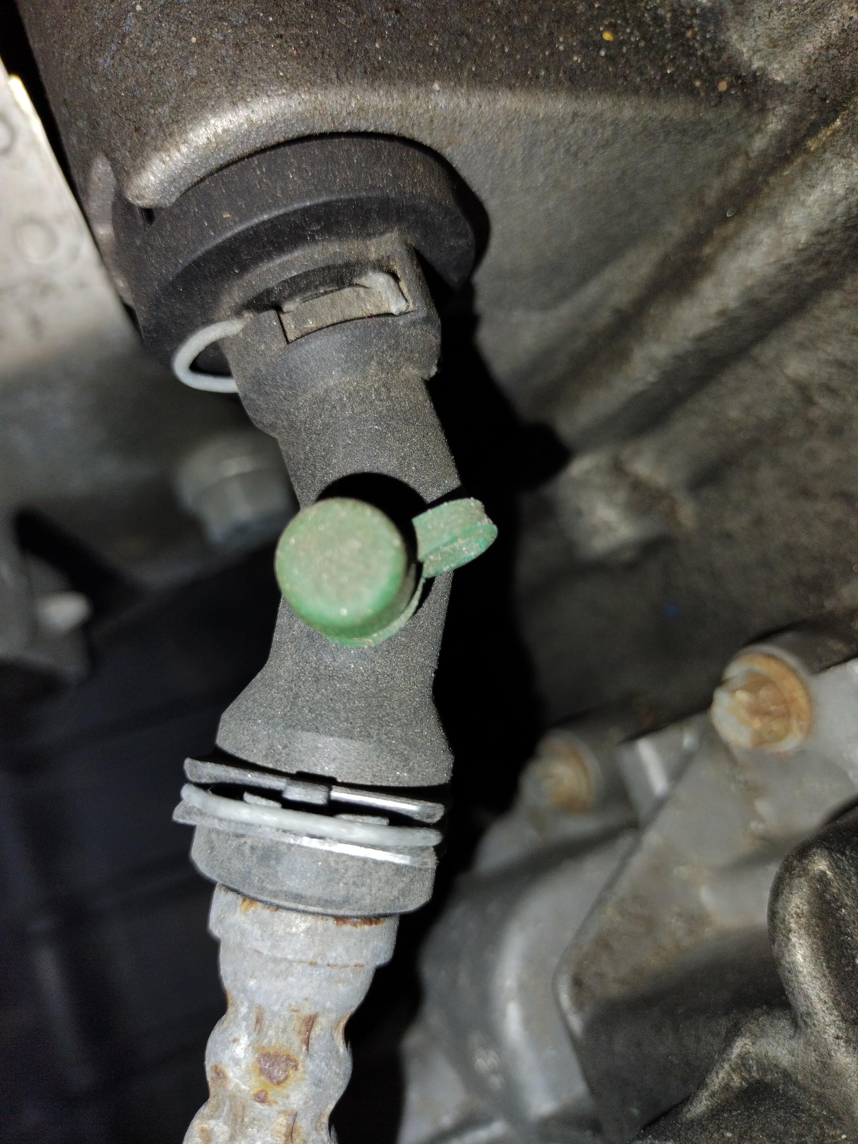

Hi,I'm planning brake & clutch flush/bleeding job on my Tipo t-jet. I struggle to find out how to open the bleeding nipple. There is nothing to unscrew just a nipple fixed to the slave cylinder. Do you know how to open it?
Thank you.
Looking again re you sure that the clutch slave
Didn't think the they had a internal slave and I can't see arm that's part of the slave cylinder or the clutch lever on the gearbox it pushes on to
I looked again, it must be the slave cylinder, it's connected to a hydraulic hose too, the puzzle is how to open the bleeding nipple. There is nothing to unscrew either side.
Thank you.
Report here somebody managed to bleed one like this
