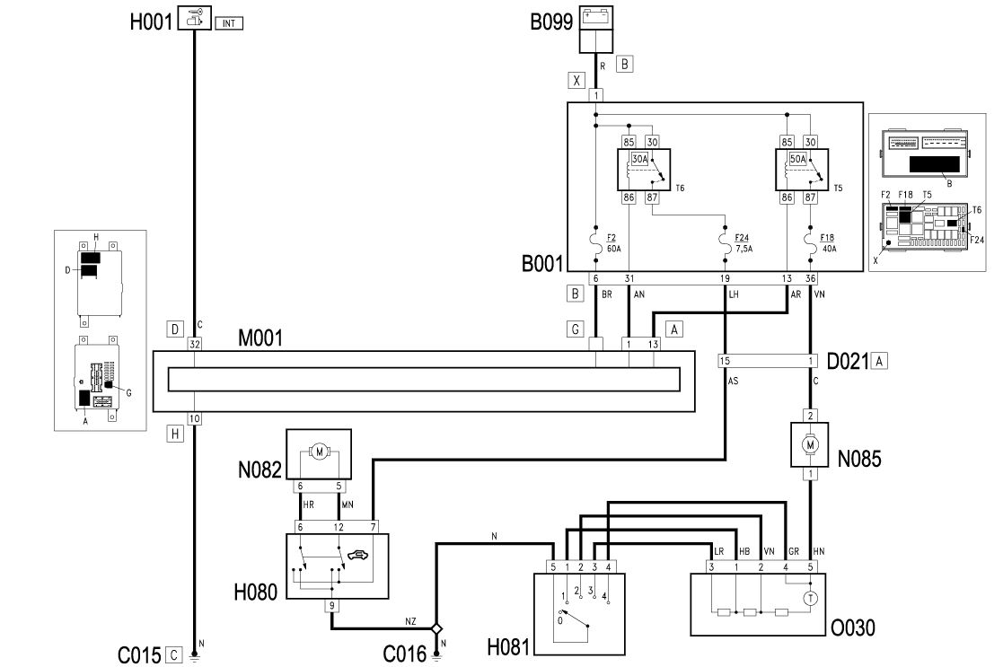

I've attached the wiring diagram for a manual fan speed selector so you can have a rough idea how it works and what could happen...
As you can see, C016 is a critical earthing point for the fan and recirculation flap motor and needs your personal attention !

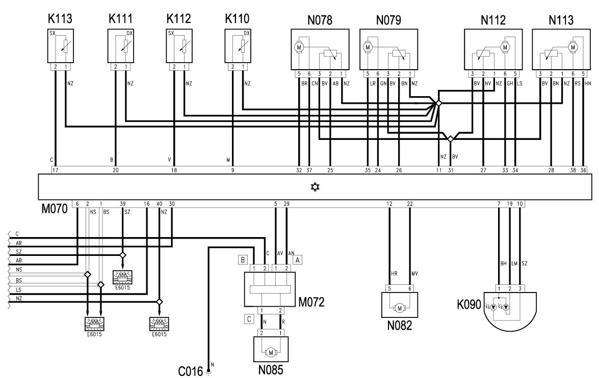

There is no resistor set on automatic climate control, but an "electronic fan variator" (M072 on the drawing) that might be looking like a resistor network with huge lugs (other word for cable shoe ;-).

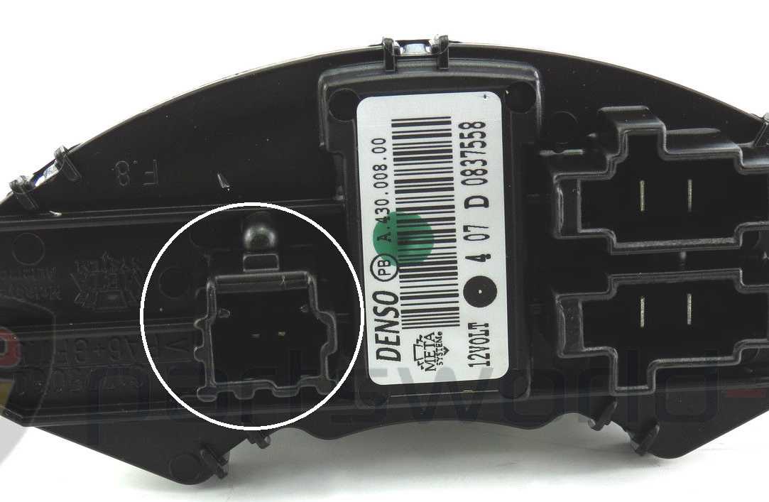

Yes, I am talking about this M087 variator.
http://m.ebay.com/itm/201774746418?_mwBanner=1
And I can't give you more informations. I have just described all the symptoms.
As I know that resistors for manual control were faulty I am asking if maybe this variators are faulty too and if they are dying often in some years, as the car is from 2007.
I am asking if symptoms I said are describing more dying fan or dying variator? What to exchange first?

Regarding your specific case, you're refering to M087, what do you mean ? The electronic variator is M072 and the motor is M085...
M072 receives power from earth and fuse/relay in the junction box (engine bay). This power is modulated by signal received from the Climate Control Unit [A](probably PWM) and outputs to the fan motor [C].
You can by-pass the M072 and power the fan in direct so you can rule out both components...
