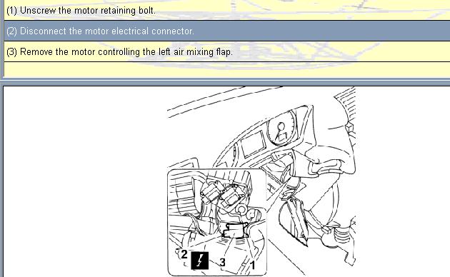

There are 2 blend (hot/cold air mixer) motors, these are ones the lowest down, nearest the floor N78 on left hand side

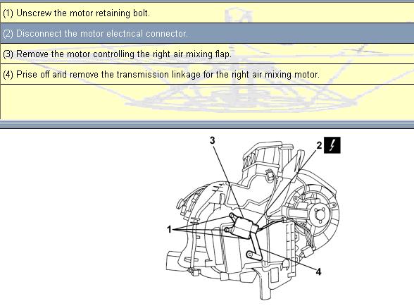

and N79 on right side

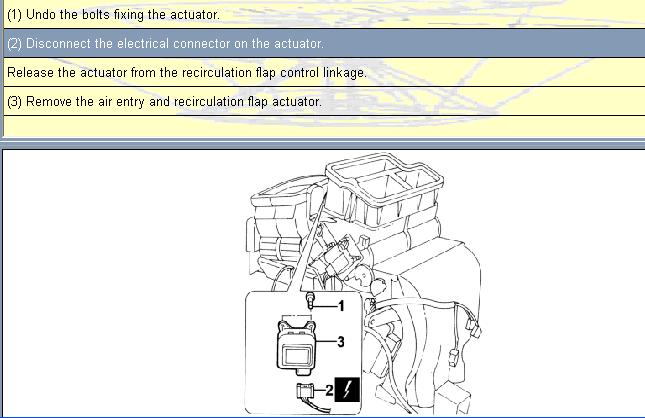

There is a recirculation (outside air on/off) actuator N82.This is at the highest point

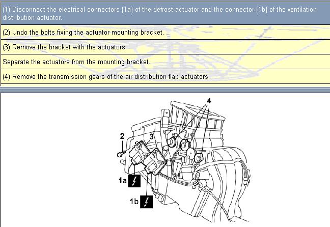

There are 2 air distribution actuators
The upper air distribution (Defrost) actuator is N83
The lower air distribution actuator is N80
The defrost actuator N83 for the windscreen is 1a shown here <<<<<<
The lower air distribution flap actuator N80 is 1b
I think I'd remove the passenger seat for access as it's only 10mins to remove it

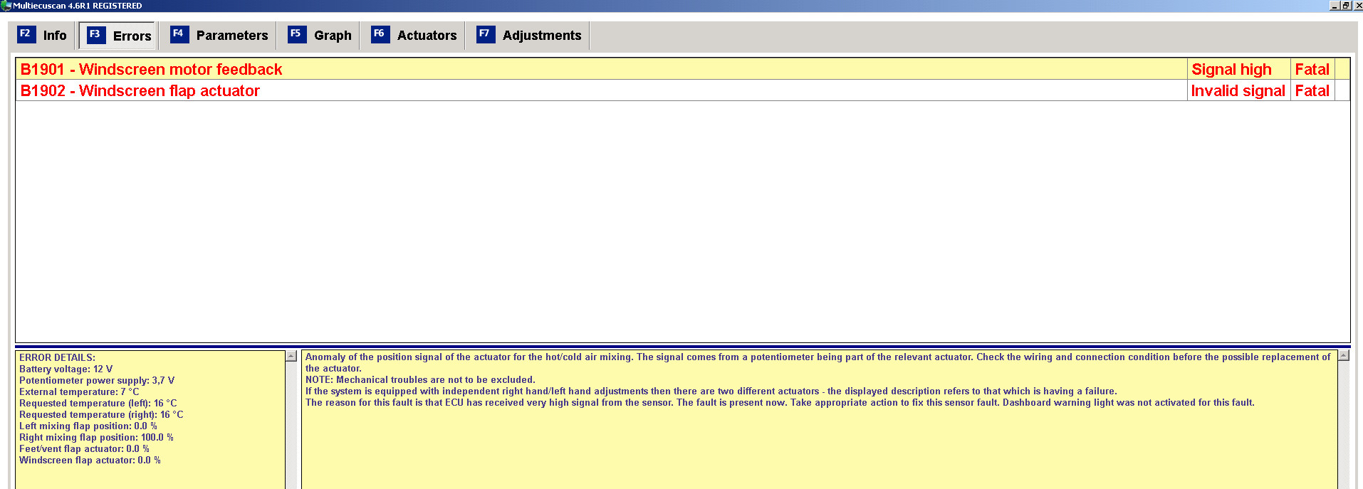

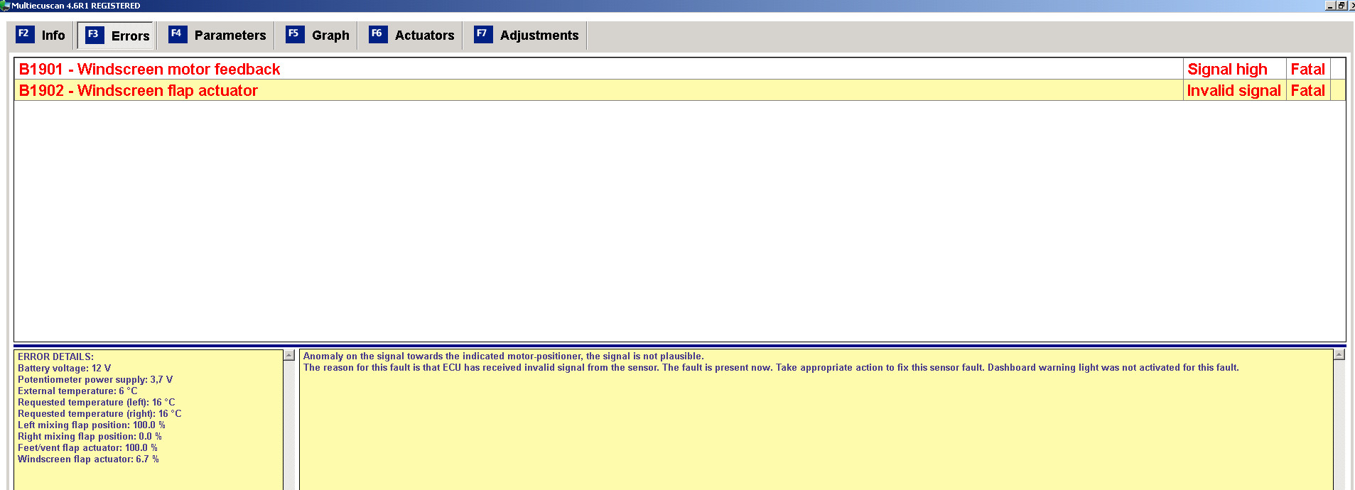

Hey guys,
have since 2 years a left handed 3 door Stilo JTD with 88kW and from beginning on problems with the 'sweating' windshield.
Even I let the whole airflow to the windshield and the blower motor to maximum, there is no flow coming out there.
Changed the inner airfilter with no improvements at all.
Yesterday checked with a chinese version of a ELM327 (and a slight mod on it) and MultiEcuScan for errors and got same 2 errors as the threadstarter.
Could you please explain, what needs to be removed, to get access to this motor?
PS: the air cooling system is also dead, but this is not so important for me.
Thank you

Hey guys,
Thank you
Hi Tim,
You can get acces to the motor if you remove the left footwel panel and the panel underneath the steering wheel. If you lay on your back and look (up) inside, you can see (and change) the motor:)
