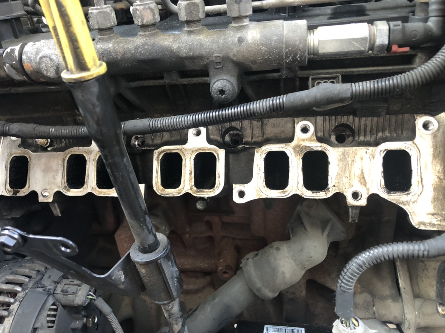

Good suggestions on cleaning these out please, thick with oil deposits x250 2007[emoji106]
Inlet in or outlet ports?
If it's just oil Inlet side some brake cleaner and toothbrush just give it plenty of time to dry out

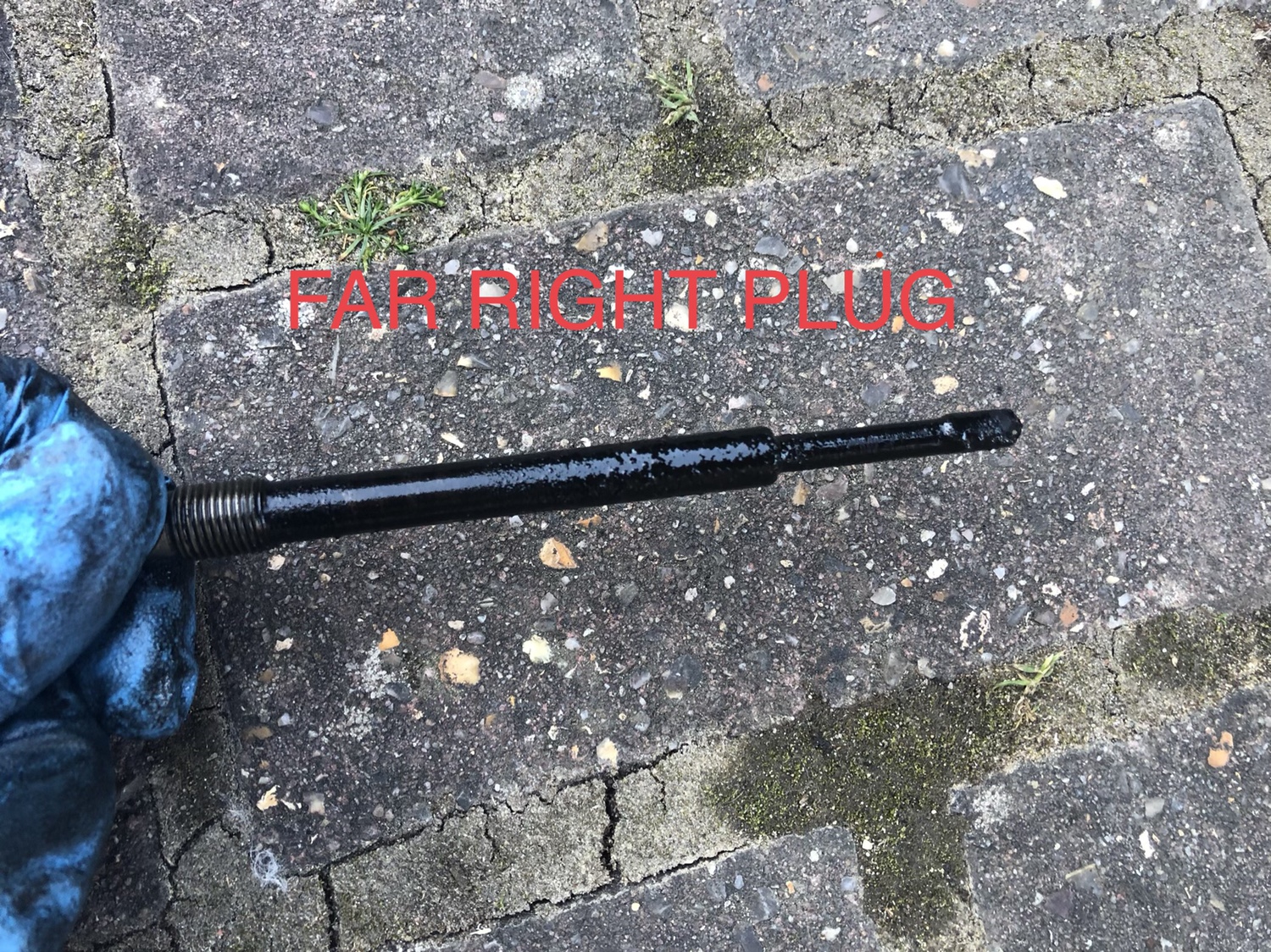

Oil on both ports. Changed plugs. 3 ok normal deposits. Far right plug was covered in wet oil.

I had an electrical fault and while everything was dismantled I decided to clean out the EGR and it’s surroundings. Then change the glow plugs since they had not been changed for the last 60 K.
3 to the left had standard deposits the right-hand glow plug was wet with oil.
The ports underneath the glow plugs are quite oily, lots of hardened deposits. Adjustments.JPGView attachment 1
