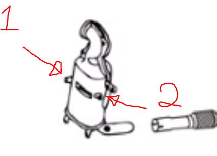

Looking more closely at the DPF/CAT? Box, there is really only 2 places, that would make sense to squirt in the foam.
1. Temperature sensor thing (Lambda?)
2. Pressure sensor before DPF i guess
Also there is another pressure sensor at the bottom, so i suspect that measures pressure after DPF.

Re: DPF cleaner, if your dpf is mounted vertically in front of the engine like mine (also 2011 so should be the same) take the temp sensor out of the front of the dpf, poke the straw of the foam cleaner into it and use an old rag to bung up the sensor hole around the straw, otherwise the foam will just spew out of the hole. spray in bursts and move the straw around a bit. Leave the foam to sit in there for a bit, I can't remember what the can said but I think I left it for at least half an hour.
