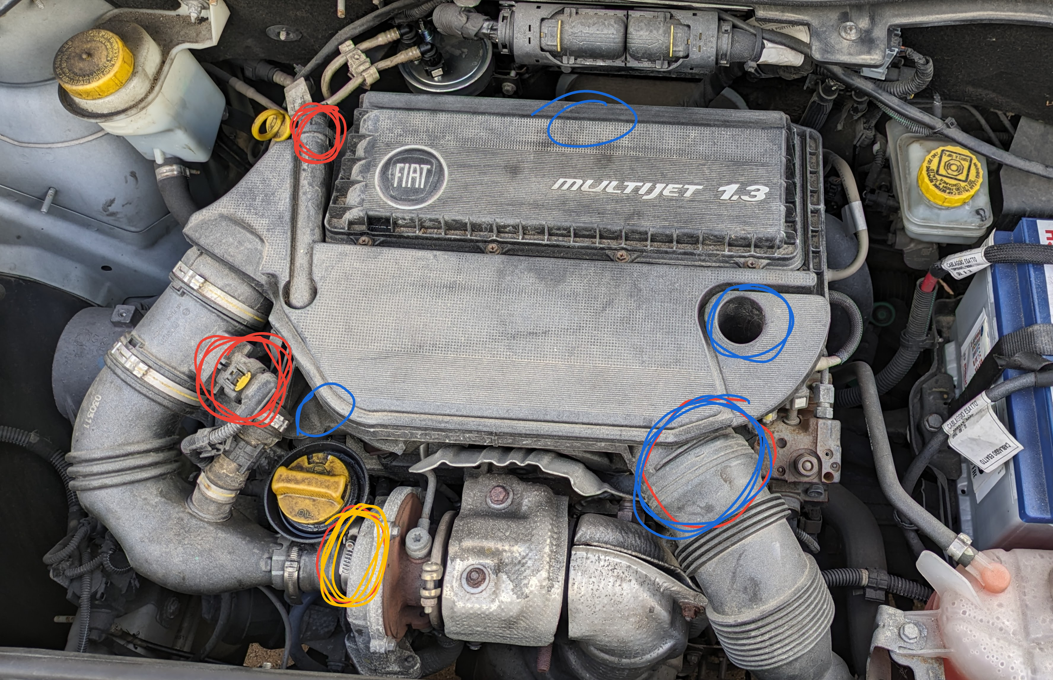

2. Remove airfilter box.
Red = Unplug
Orange = Loosen/Unscrew with 7 mm spanner
Blue = Pull off

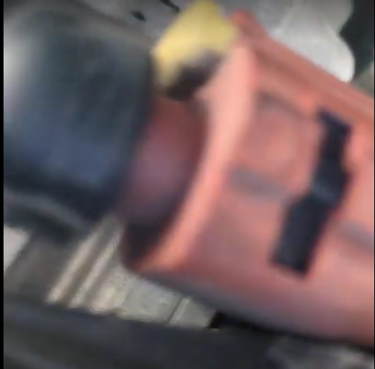

- Unplug the plug at the back left side of the EGR, hard to reach, and hard to get back in.

PLUG with yellow tab on the top, that needs to be opened before you can unplug:
