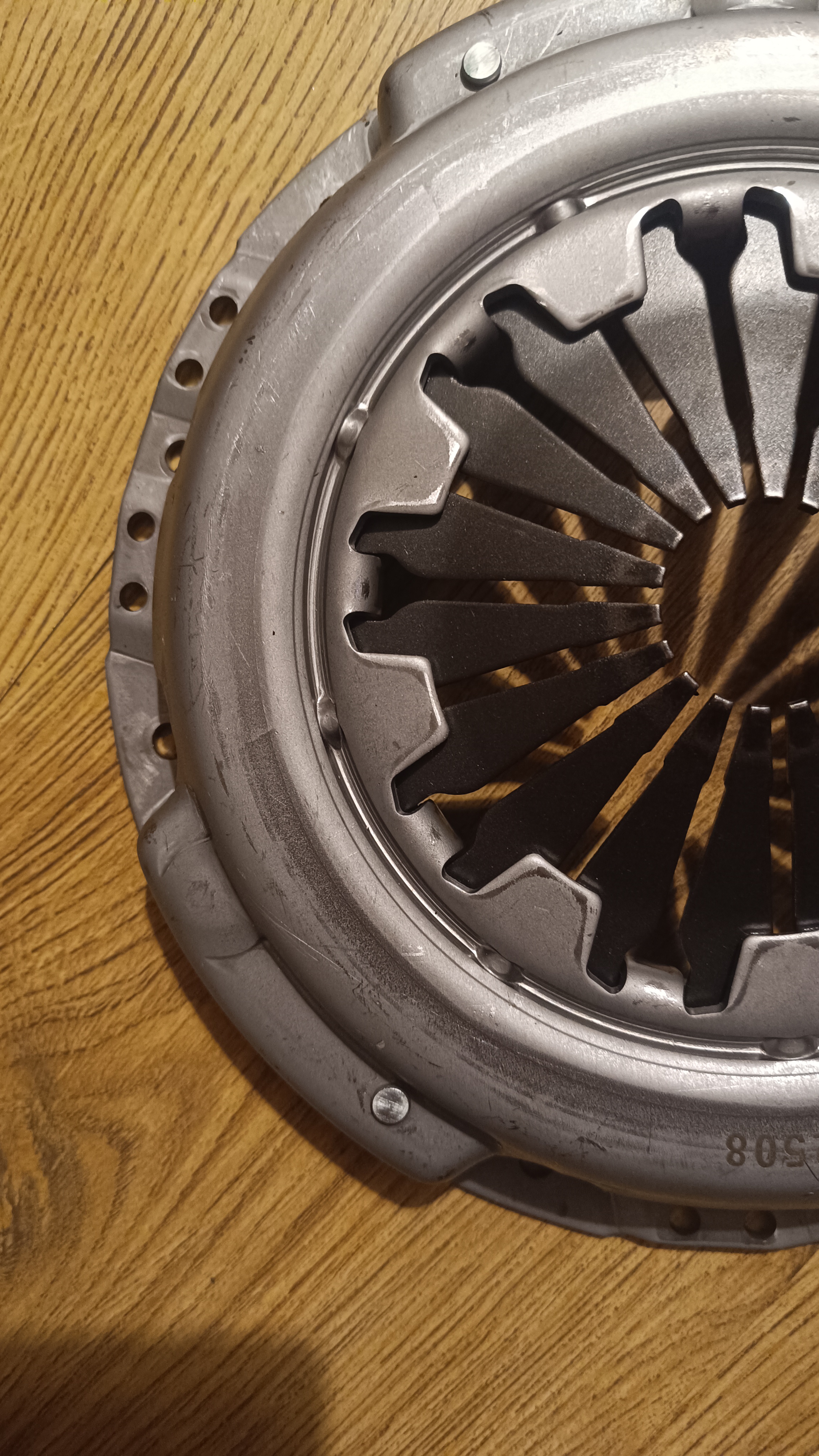

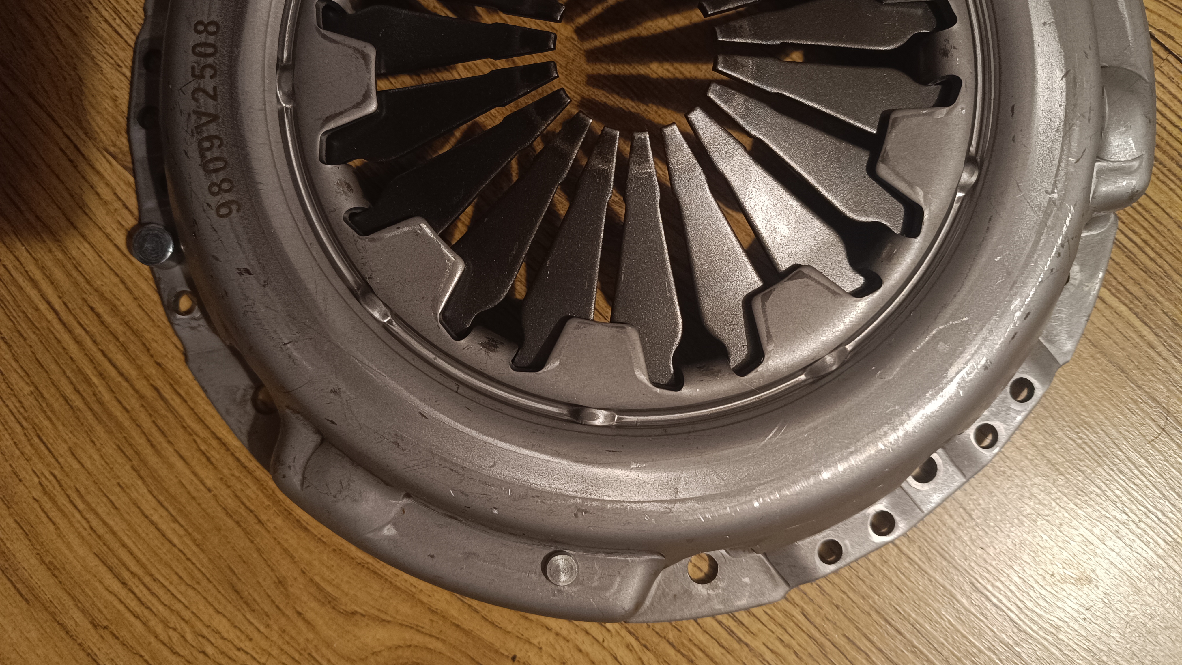

That us really odd!The clutch came and its been used...
I thought at that possibility too, but it doesn’t sound right to me.Do they get tested prior to sale and have the fingers compressed and scratched?
Just a thought, are they "remanufactured", they don't exactly look top quality to me and price seemed very cheap as Valeo and Sach seem to be over £100.It might just be scrappy manufacture? I'm not sure how clean these are supposed to look.
Can someone confirm?

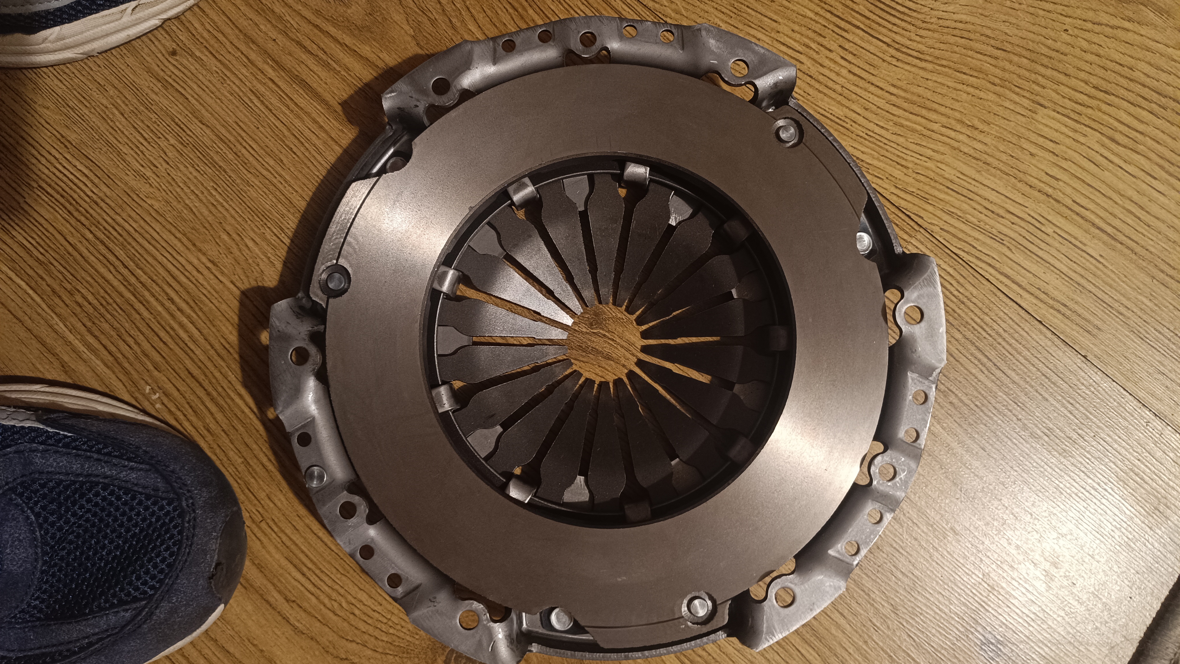

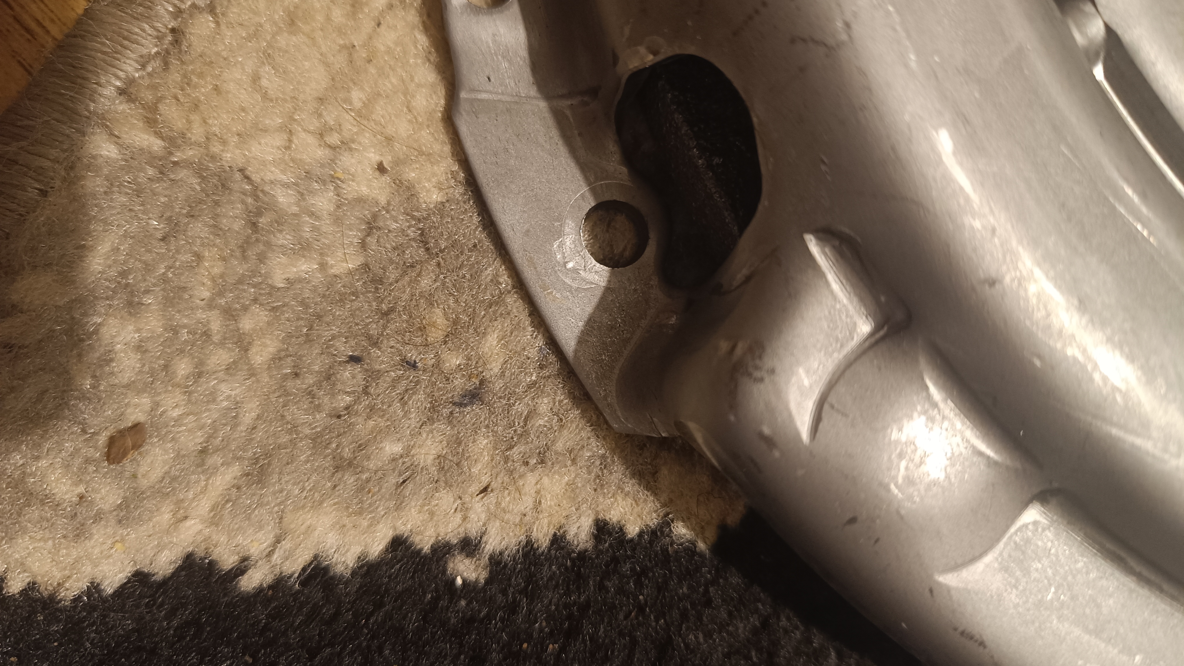

I did try to zoom in on the bolt holes, but not conclusive although slight marks/indentations.Yes, any bolt hole witness marks ?
Any marks on friction Plate, withdrawal bearing and packaging, greasey finger marks ?
Could be, points to it.A good question...the answer being yes. There are 6 bolt hole witness marks like the one below, so this is remanufactured?
I'm going to send it back then.Could be, points to it.![]()
