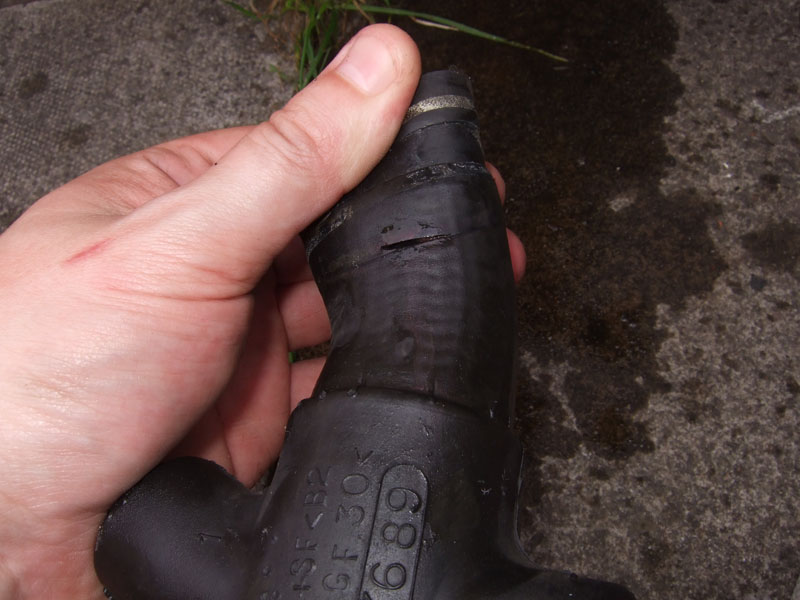

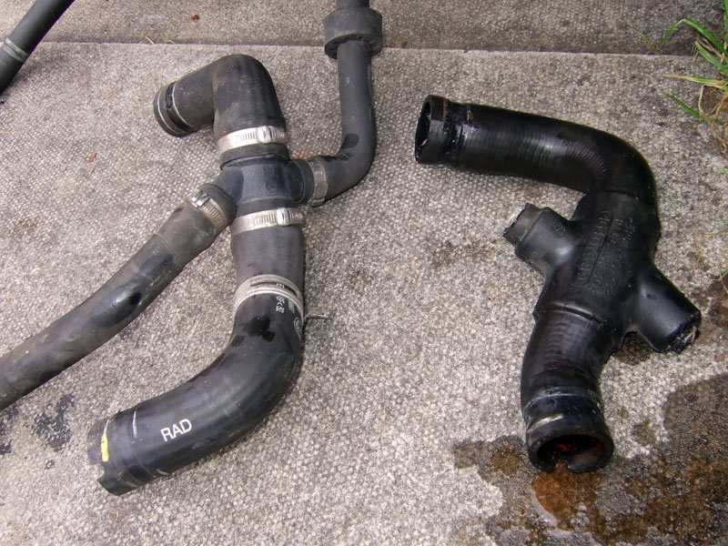

Cooling system. Small issue with this one. The second lambda hole in the SS exhaust manifold exits near the main waterpipe junction, i had to pack it with exhaust wrap and leave the EGT probe touching the water pipes. This has half pulled the pipe off the main waterpump pipe off the block, and the jubliee clip has split the pipe. It mostly holds pressure, but vents steam when hot. I've got the cooling pipes of a Seicento MPI now. I will rejig the cooling system, maybe tomorrow. Re-routing the pipe to the expansion tank too.

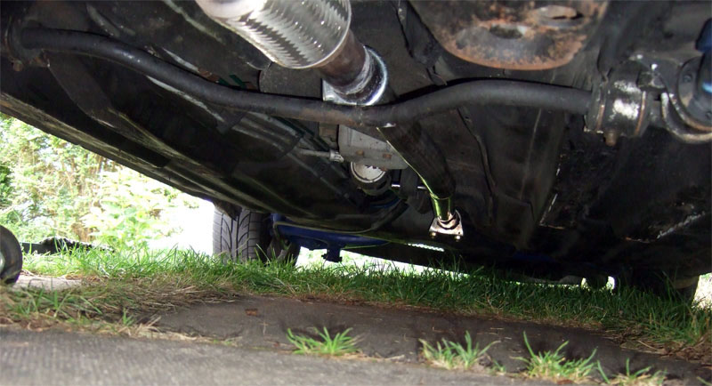

Exhaust. I knew this would be a problem. I had a standard centre section, and my decat pipe was sat on my ARB. dampened slightly by some exhaust wrap, but still not right. Took it to unique exhausts in stafford (seriously recomend this guy to anyone in the area) and got a straight through centre section made up and fitted. Exhaust is now bob on.

here is my new exhaust.
this is the damage to the cooling hose
quick trip the scrappy and £5 later..
its a slightly different shape, so took some jiggery pokery but its on now. i ran out of jubliee clips though (and top gear was starting soon). Will finish it off tomorrow.

cooling system is now sorted, but ive not re routed that pipe yet.

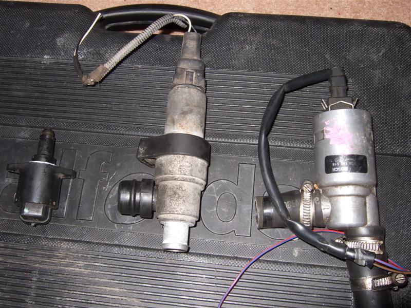

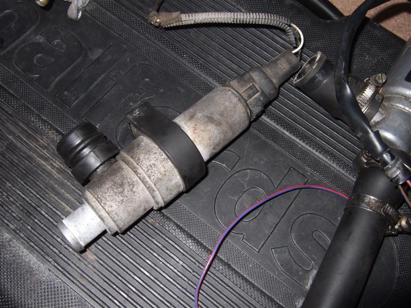

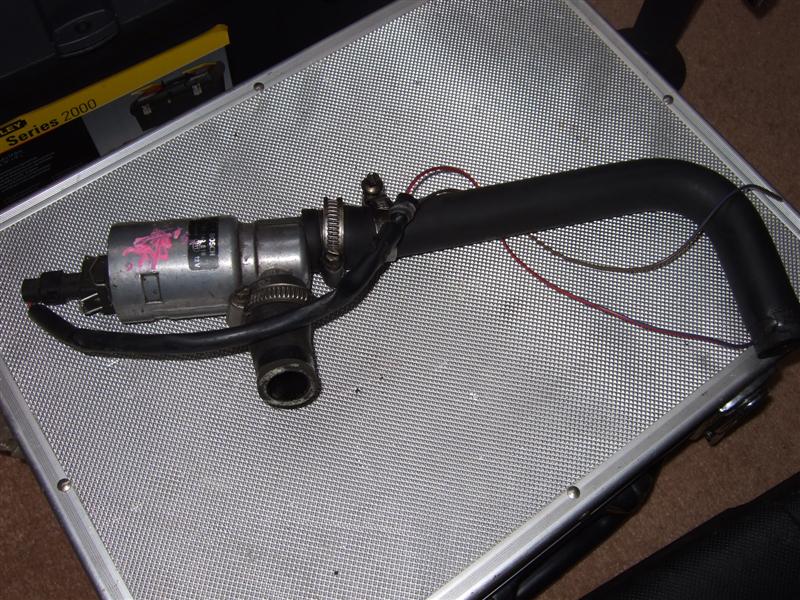

looking at fixing the idle and cold start issues, i've got my an idle control valve
just been shopping..

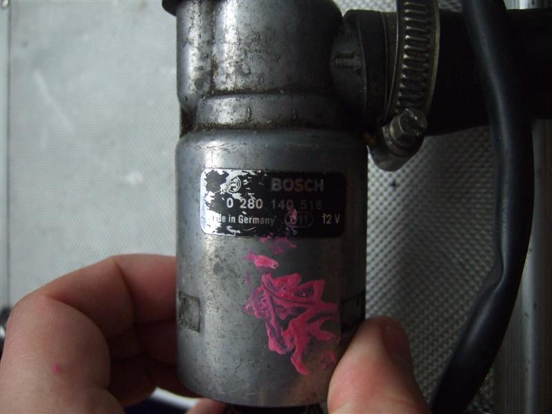

Bosch PWM idle valve off a caviler, should do the job.
this is because MS can control a fast idle valve (opens to allow fast idle) or a PWM idle contol valve with a simple mod.. or with a complex mod it can control a stepper motor valve like the type we have on our cars. I don't want to do that kinda modification to the ECU yet.. so i'll fit the PWM valve for now.

mine idles at around 750rpm when warm, i think thats why mine will stall when cold. it is fine after a few mins. i could increase the revs at idle a bit and not fit the ICV - but for what it cost me, i may as well fit it.
i'm not sure, i didnt really pay much attention to it. i just spotted what i wanted and got it. but yeah its a 2 pin jobby.
not sure how i want to connect it yet. ive gone off the idea of using the brake servo take off as i dont want to comprise any servo assistance.
thats what i was going to do to begin with. then i changed my mind. i might just fit and see what it does. worst case, i loose the servo totally on a test.. but its not like it *really* needs it anyway.
hehe. it might be overkill.. might pop back to the scrappy and hunt out a smaller one. there was a ford one that *might* fit in the OE posisition. i'm not sure. ive stripped down my spare injection system to have a look.
not sure when i'll have time to have a play, am busy for the next week or so - but might have time this weekend to have a play.
