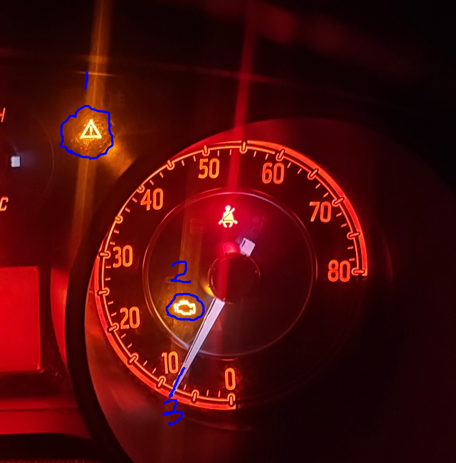

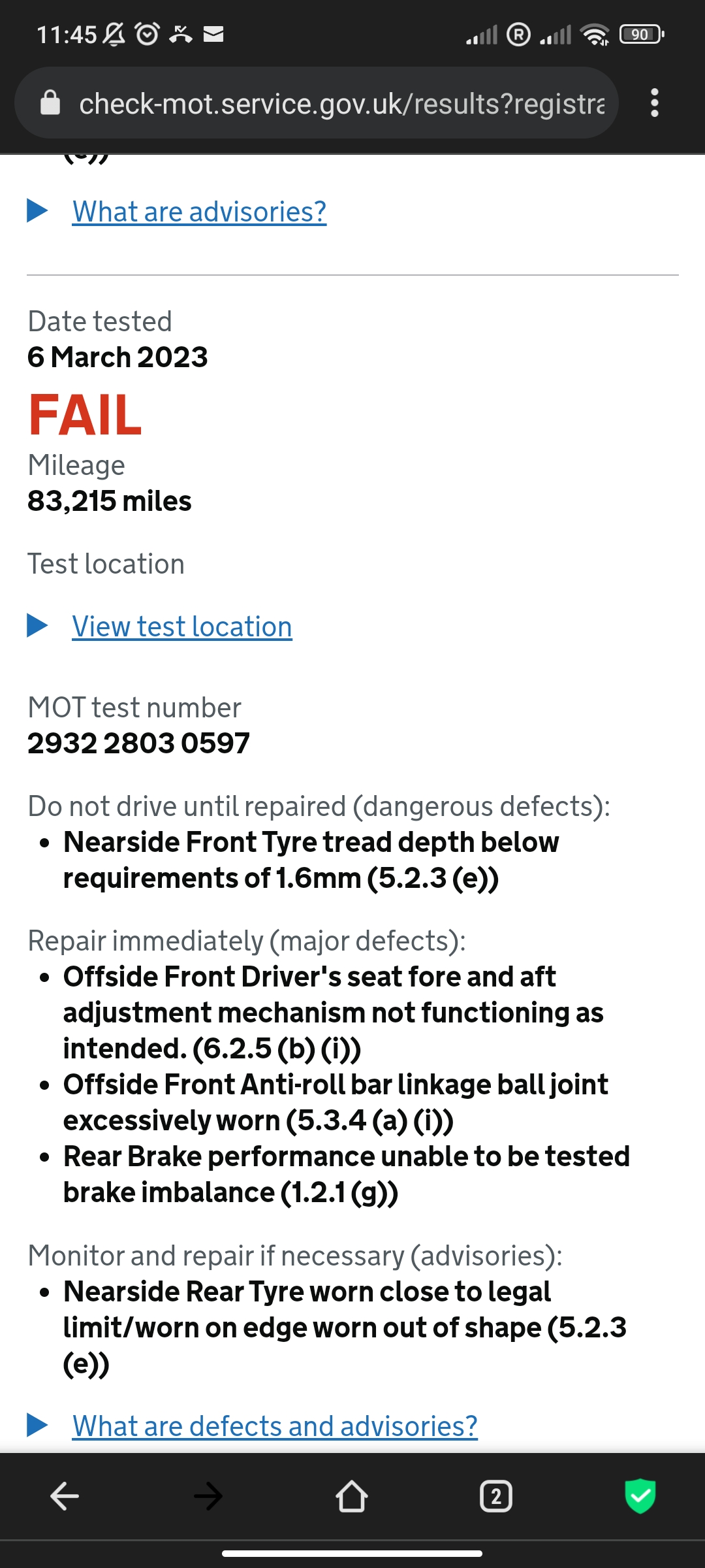

Day after mot retest and passed I got check engine on.
What should I do?
And I need to drive 150 miles monday to the Airport 😪

Tell us what engine, what year
Read the code, without this anything is a pure guess
Tell us if there is any drivability issues
Unfortunately an engine check light on its own tells us very little. It’s a generic light with hundreds of possibilities
Oh on, well hopefully you can get the fault code read at a garage and they can fix it for you.
But you could go to an autoparts store and ask for a generic fault code reader, like some bluetooth dongle that connects to your smartphone.
A very good app to use it with is this
Diagnostic port is usually located under the steering wheel on left hand drive. Just lift the steering wheel up to remove the card under it. Then read the code and tell us and hopefully someone will be able to tell if it's serious enough that you need to stop driving.

Did they undo anything for the MOT work?
Chance they left a hose off??

Idk what they did, but that's what I was thinking that they undo something. Before retest no light. Right when I picked the car up that exclamation light got light up but it went away after ignition. And day after that light again + check engine.
Think I'll just buy an obd and I'll have it for the future 😁
Are we talking about engine check light as per title
the light that looks like an engine
Or the yellow triangle
As post 6 says exclamation light
In your photo you have both on
We need clarification as they are totally different functions
That changes things considerably
A generic OBD reader probably will not help the code as it likely to be stored in the body computer not the engine computer
Engine oil pressure sensor failure.
Problem with parking sensors.
Fuel cut off not available
External light failure
On the post 2012 panda
Number plate bulbs
Day light running lights
And oil pressure switch are the normal causes
I “think” the check engine on the display is pointing more to the oil pressure switch.
Hopefully someone with more Punto knowledge than me will be alone shortly
@varesecrazy
Got the messege scrolling the screen
⚠️Maybe it things some lights don't work? I just changed side turning lights and licence plate ones with led? 😁
Before the MOT..,,???
THE CAR 'Expects @ : 150 drain with lights on
You have made that @ : 125 so it 'thinks' a bulb has failed
Hence the warning ;-)
