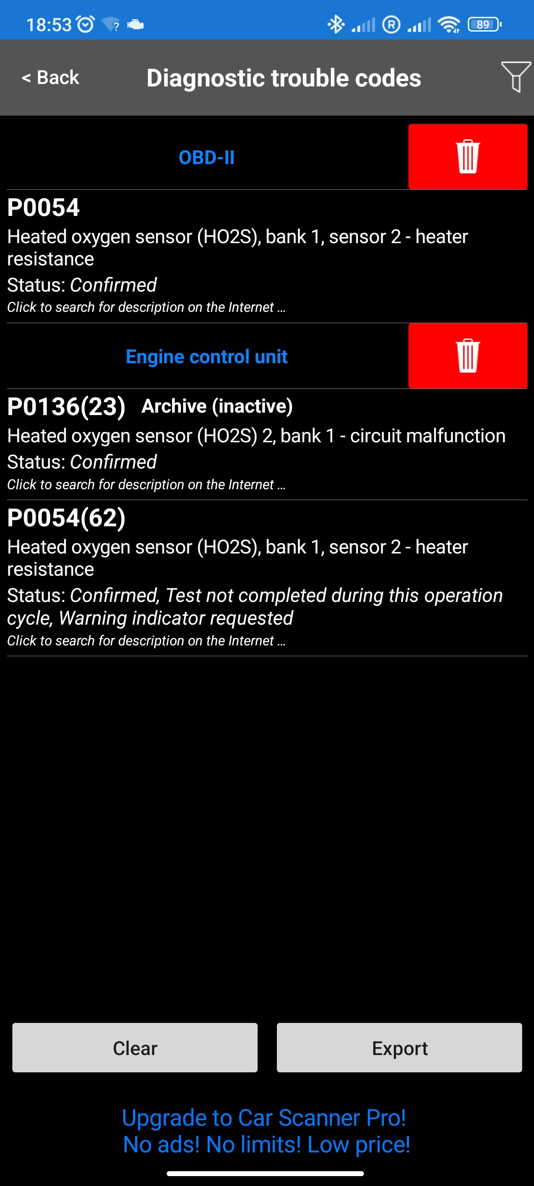

This is what I found 😁

It's great that you were able to sort it out.
Unfortunately I think the code may be quite severe. It may leave you stranded on the side of the road, but it's very difficult to know because this code is only a result of something. It depends on what's caused it. Sometimes heater element may fail, as it says, or there's a wiring fault. I'd just take a bus to the airport.

That list of fault codes is pointing to the O2 sensor that is screwed into the exhaust. The way these sensors work is by heating a medium up and then oxygen can pass through it, if the heater isn’t working then the sensor will not read correctly, normally in this instance the engine will run on a default program and shouldn’t (theoretically) breakdown, but it’s not something you can ignore and carry on driving, you’ll need either a new sensor which are fairly common and not very expensive and you can fit it yourself if you’re handy with spanners or you can get a garage to do it, either way it’s a quick-ish job and unlikely to be anything to do with the MOT unless they somehow broke a wire while jacking it up or poking around.

Right the engine check light
Both are for the lower under the car O2 sensor.
The main job of the post catalytic O2 sensor is to monitor the CAT it’s self. It has very little to do with the running of the car.
There 2 separate circuits running to the sensor. The first is a simple heating element. The second monitors the oxygen in the exhaust gasses
P0054 post cat heater
P0136 post cat signal
It’s as if it’s not plugged in as you you have both circuits fail
Have you had any exhaust work done lately or hit any debris on the road ?
I’d start by having a look its connector.
Is it damaged,
is it plugged in.
Is it corroded,
Has water got in.
Also follow the wires a bit have they got damaged
I wouldn’t buy any parts yet. We can check voltages to the heating element and the resistance of the element and so on.
It’s a hard one to advise on whether it’s okay to drive. Post CAT has very little to do with the running of the engine.
