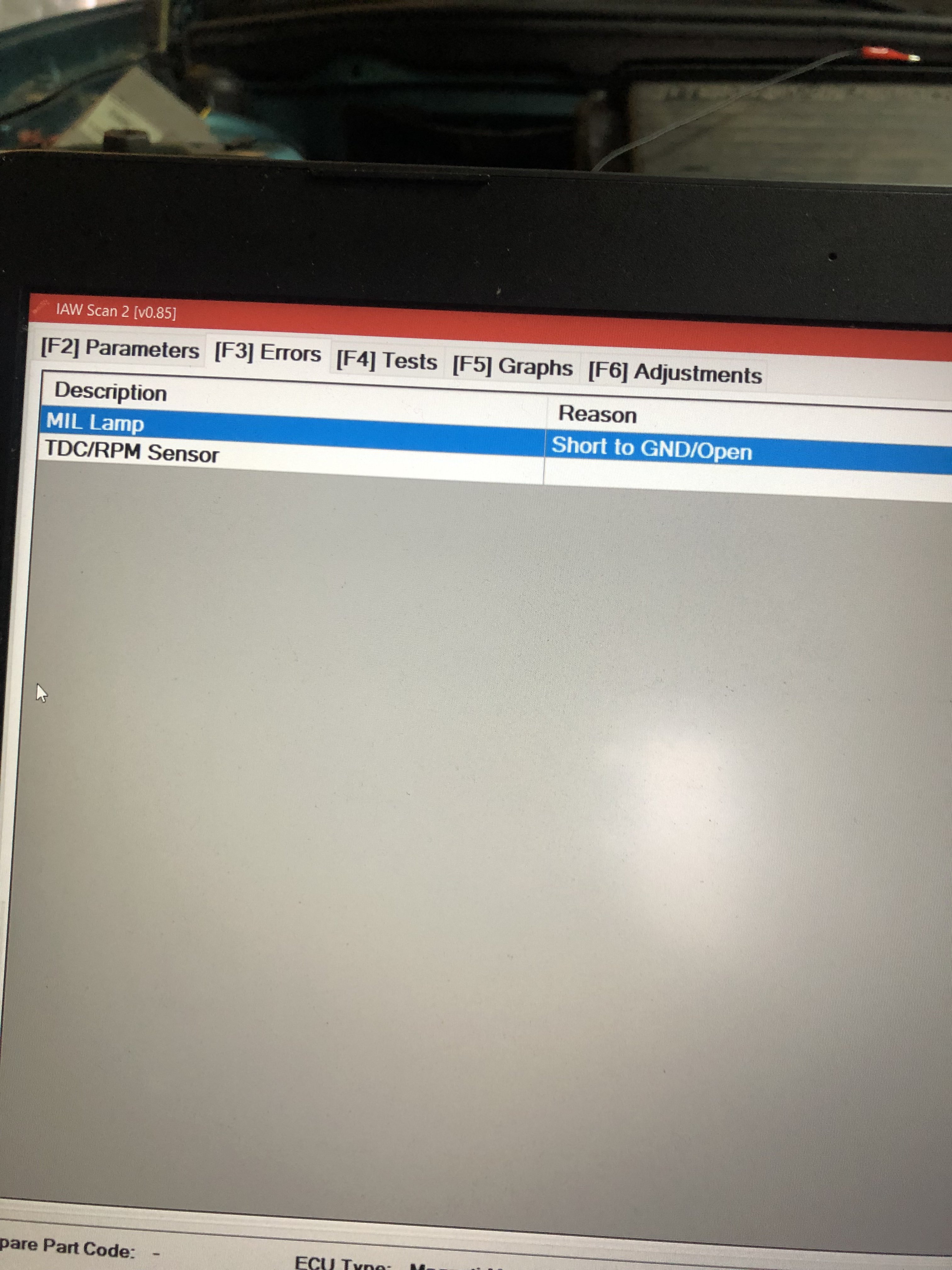

So after I put the car on the computer this is what are the problems. Can be the rpm sensor problem? But only when the weather goes down 0 degrees.
pretty common issue yes, usually when they start failing you get the light as you describe and not much indication of poor running and it will get progressively worse until it wont run properly and then just wont start at all..
The ecu uses this sensor to tell the coils when to fire and when to inject fuel, so if it fails completely you have no spark or fuel and car no go.
The good news is its not an expensive thing to replace, its held in with one 10mm bolt and one connector (y)
