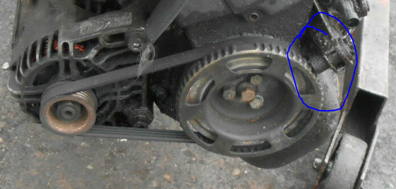

Hi, so came across an issue. Got the alternator loose and got the belt off, however, there's no way to get the belt out at all. There's a very tiny gap and it doesn't let the belt get through the gap. As you can see below. Do I have to unbolt that bottom one a bit too? to get it through the gap or is there another way?

Here's a clearer picture from the outside of how the gap is too tiny to fit through :/
That sensor you've highlighted can be removed. As far as I know it has to be in order to slip a new belt over. There is a single bolt that attaches the bracket of the sensor to the engine block. You will need to get your head under it to see it. Hopefully the diagram here helps.
Once you've got the bolt undone and removed, you need to pull the sensor out of the metal bracket that its supported by. It will be tough. Spray some WD40 or similar lubricant in there and grab it gently with a pair of pliers and wiggle slowly (pulling towards the front of the car). It will eventually come free. Once you've made enough space near the belt you might have better lucky pushing it out instead of pulling but be careful! You might damage the sensor if you go prodding it with a screw driver or whatever. EDIT: On further thought - save yourself time and reduce the risk of damaging it by only pulling it out a tiny bit (enough to make the gap big enough to slip the belt through).
Swap the belt over.
Stick the senor back in (clean up the metal bracket first to make the insertion much easier).
Do the bolt up on the underside of the sensor that attaches the plastic of the sensor to the metal engine block.
Tension your new belt. Haynes manual says you could tension it so that it has 5 mm movement each way (up and down) when you press on the belt firmly in the middle of it (middle point between the alternator and the auxiliary drive pulley on the engine).
Extra advice: jacking the car up on the side with the alternator and removing the wheel and wheel arch plastic lining can massively increase your access in this job. Makes it A LOT easier. Worth the extra faffing about, in my opinion.

That sensor just runs with an 'airgap' clearance ;)
Two things I would like to point out :)
I just remove that pulley..its those 3 bolts..and will just fall off
IF that belt is so old and tired.. what state is the timing belt in ?
If you remove that pulley: you are 40% towards a timing belt change ;)

What quaffle suggested worked. I didn't have to pull on the plastic bit though it just slid out after unbolting. New belt is fitted in and now no more squeaking :D

judderbar it was just the plastic bit which was in the way unfortunately :(

Good job. Mine had a lot of gunk that had congealed there that essentially glued it in place the first time I took it out.

I've damaged crank sensors in the past trying to remove them so my preference, as recommended by Veresecrazy (Charlie) above, when replacing an aux (fan) belt would be to whip the 3 pulley bolts out and temporarily remove the crank pulley. I've never had a problem getting one of these off but don't forget to line up the wee "pip" on the cam belt sprocket with the wee hole in the pulley when you reinstall it.
