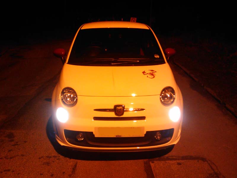

I've installed my PIAA DRL bulbs now so photos are below:
