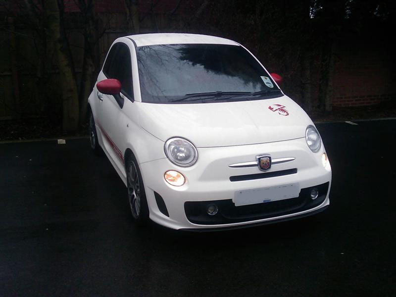

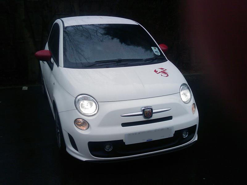

I have put my low beam MTEC bulbs in and am really impressed with them. They look like HIDs/Xenons. Photos below. I also received my DRL bulbs through the post today but it's raining so they'll have to wait.
