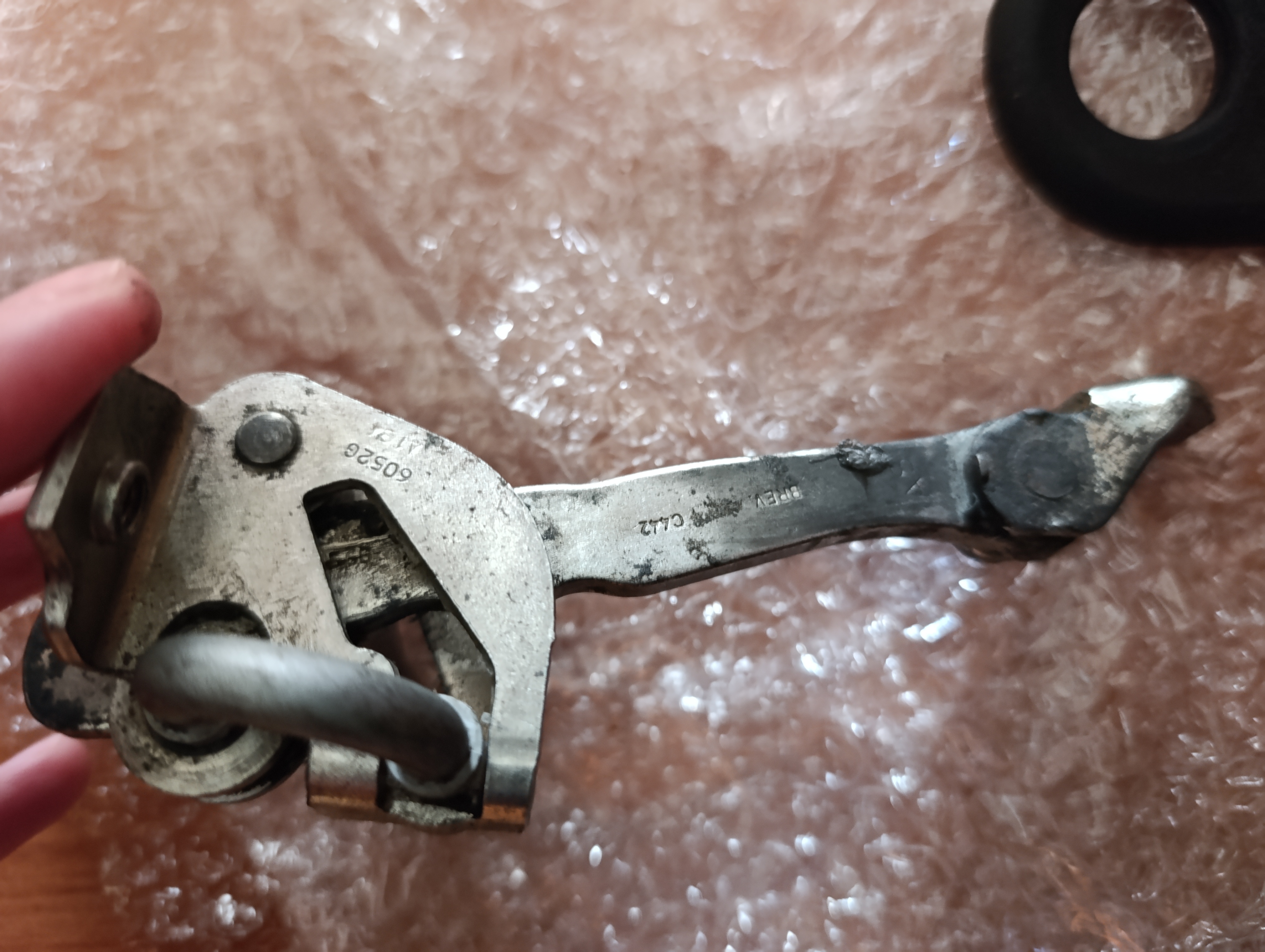

Has anyone replaced a front door check strap? I removed the old one that was broken and pulled it through the speaker hole, I thought it would be an easy job to fit the new (used) one but just couldn't figure it out. I've searched on Google and this forum but couldn't find any type of guide.

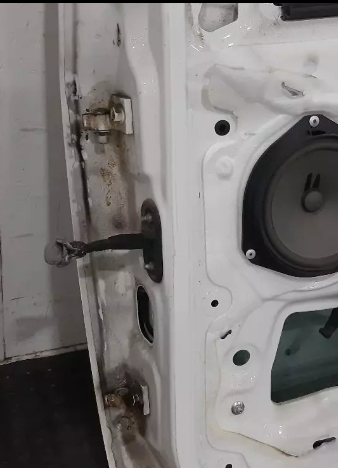

Yes through the speaker hole, should just slide into place and two nuts
Are you sure you have the right one, they are handed

Yes I'm pretty sure it matched the old one (that I can't find right now), I attached some pics.
So I probably left two nuts inside the door, I'll try to find them.

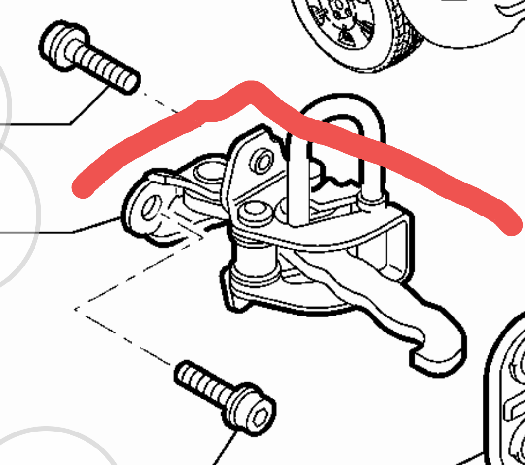

I really don't understand how Iºm supposed to fit this. How will these small screws reach the screw holes in the check strap?
Mine seems to be in a different position than this diagram:
Do I have the wrong part?
I think that this part was disassembled and assembled back the wrong way, that's why it wasn't working.

It looks like the strap that connects to A pillar should be facing the other side right? (see pics on this post that I quoted)
The red the outer skin is facing towards the camera
The white the outer skin is facing away from the camera
There both the same
Both sides use the same strap so it's flipped over
Or just mirror the one on the other side
